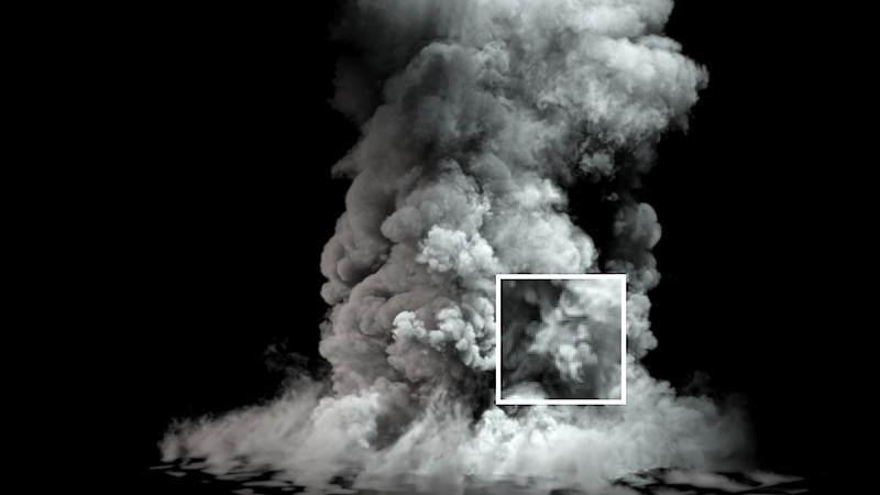

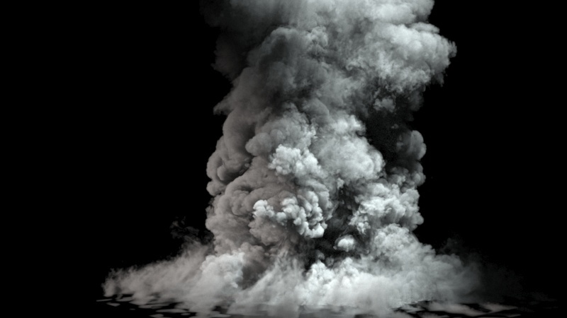

Rendering rollout → Step %
The Step % parameter is the main sampling control when rendering volumetric effects. The higher you can set the Step %, the faster the rendering will go. Eventually artifacts will start to appear for very high values, so that is where you must stop increasing the Step %.
The Step % option specifies the ray marching step of the camera rays as a percentage of the cell size. As the renderer traces rays through the simulator, this value controls how often to get information from the grid. If the Step % is more than 100, some cells will be skipped and artifacts may appear. A lower percentage might be necessary so that fine details are not lost when custom changes are made to the Opacity curves for Fire / Smoke.
Step %: 90, Render Time: 4m 58seconds.
Step %: 200, Render Time: 2m 01 seconds.
Step %: 300 , Render Time: 1m 49 seconds.

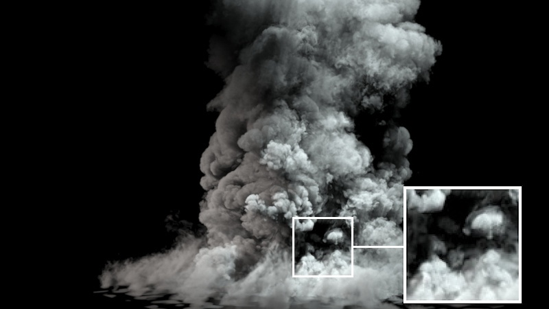

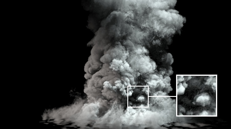

Volumetric Options → Smoke Color → Volume Light Cache | Light Cache Speedup
In general, for lower-resolution simulations, the Phoenix Light Cache will significantly speed up the rendering. As the resolution increases, the benefit from using the Phoenix Light Cache diminishes. If Volume Light Cache is disabled, try enabling it to check if that will speed-up the rendering. You can reduce the render times significantly by increasing the Light Cache Speedup setting. Increasing it from 0.9 to 0.99 to 0.999 should yield a big difference in render speed.
The Light Cache Speedup should be increased until artifacts start appearing in the rendered image. Grid Light Cache artifacts will look like voxel-sized dark and bright spots. They would also flicker in animation. Grid artifacts start appearing when a voxel does not get to cast enough shadow rays – this is usually related to the lighting setup – e.g. the illumination is too dim, there are too many grids in the scene, etc. If you see these artifacts, then your Light Cache Speedup is too high and you have to decrease it. If decreasing it to zero still does not help, disable the Light Cache.
Disable the Volume Light Cache option if:
  1. Reducing the Light Cache Speedup option to zero does not help resolve artifacts in the smoke. If you see bright and dark voxels, this means the light cache speedup is too high. If you see pixel sized noise, then it's the sampling - you should adjust the V-Ray settings accordingly (e.g. increasing the Max Subdivs for the Bucket Sampler).
  2. You are rendering an animation and you notice flickering which will not go away after reducing the Light Cache Speedup.
  3. You are using Progressive rendering.
  4. There are multiple grids in the scene - for a large number of grids in the same scene, disabling the Phoenix Light Cache might speed things up, as opposed to a single grid where it's best to keep it enabled.
Volume Light Cache: disabled , Render Time: 11m 34s.
Volume Light Cache: enabled , Speed-up: 0.9 , Render Time: 32m 42s.
Volume Light Cache: enabled , Speed-up: 0.99 , Render Time: 7m 17s.
Volume Light Cache: enabled , Speed-up: 0.999 , Render Time: 1m 49s.

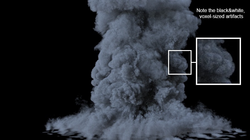

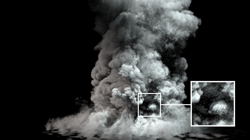

V-Ray Sampling Artifacts:
Pixel-sized artifacts caused by low V-Ray Sampling settings could manifest in the rendered image, especially if using Smoke Color → Scattering → Ray-Traced (GI).
To resolve these, increase the Max Subdivs in the V-Ray Settings window.
Max Subdivs: 2 , Render Time: 33 seconds
Max Subdivs: 5 , Render Time: 116 seconds
Max Subdivs: 9 , Render Time: 177 seconds

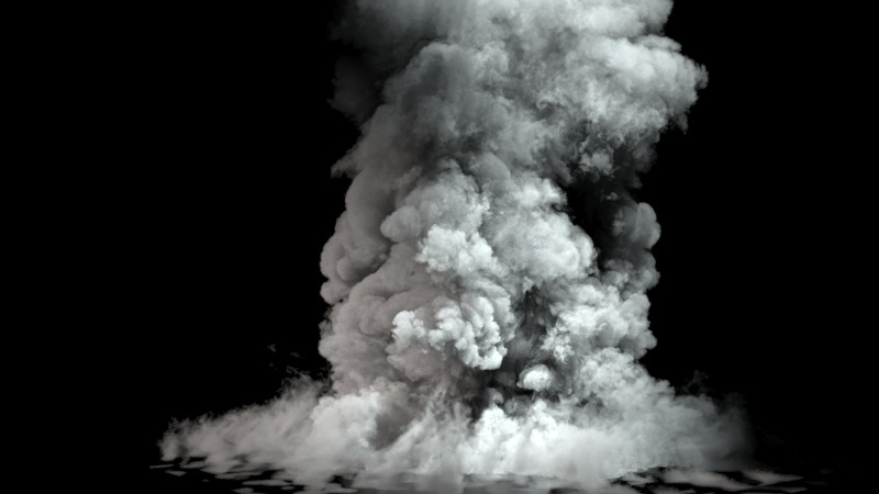

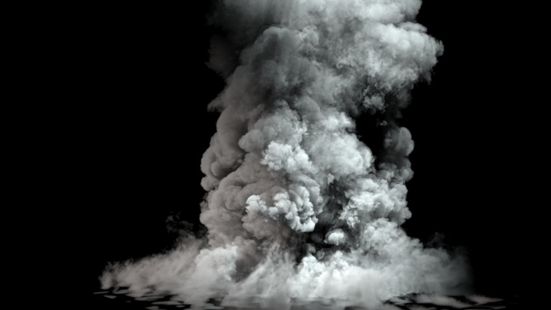

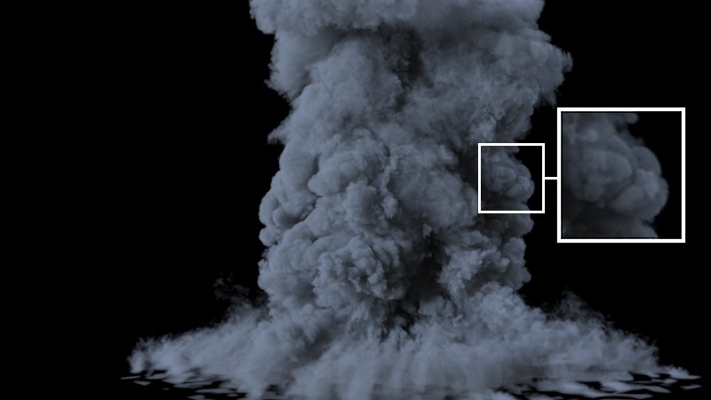

Volumetric Options → Smoke Color → External Scatter Mult
If you want to get a better sense of volume for the look of the smoke, instead of increasing its opacity, you could decrease the External Scatter Mult - this would prevent light from going too deep in the smoke and you would get stronger shadows in the volume with the same opacity.
External Scatter Mult: 1.0
External Scatter Mult: 0.9
External Scatter Mult: 0.75

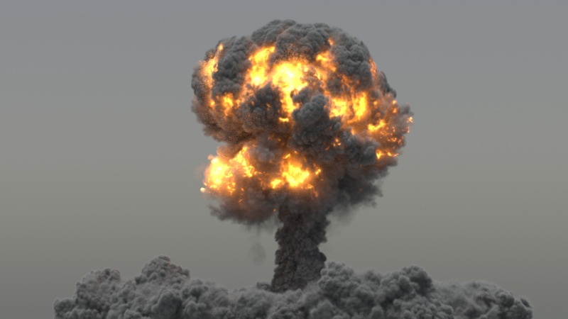

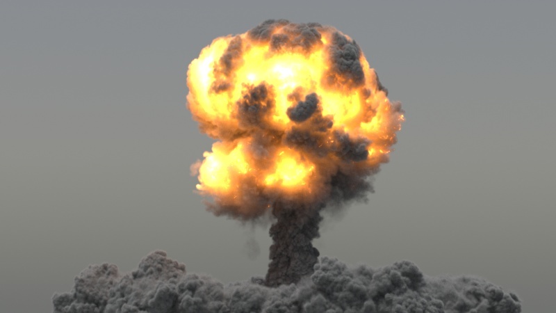

Volumetric Options → Fire → Fire Lights
Enabling Create Fire Lights simulates Global Illumination by placing light sources in the bright parts of the fire, which produces similar results and renders much faster. It can be used in with both GI on and off as well, because it would help in cases where large environments need to be illuminated by very small, very bright Fire Lights. Note however, that if there are many glossy surfaces in the scene to reflect the light from the fire, Create Fire Lights could slow down rendering, so in this case try turning it off.
Disable Create Fire Lights - if this speeds up the rendering significantly then you can experiment with the options in the Fire Lights section.
When rendering with V-Ray GPU, the Fire Lights options are ignored entirely. Global Illumination should be enabled from the V-Ray Settings if you need the Smoke and/or the scene to be illuminated by the fire.
Create Fire Lights Enabled, Grid-Based Self-Shadowing , Light Resolution: 25% , Render Time: 14m 45 seconds
Create Fire Lights Disabled, Render Time: 1h 0m 03 seconds
Grid-Based Self Shadowing ignores any geometry inside the grid and shines right past it. This also applies for intersecting grids. If this behavior is undesirable, switch to Ray-Traced Self-Shadowing mode.
Ray-Traced Self-Shadowing , Light Resolution: 25% , Render Time: 1h 53m 06 seconds
