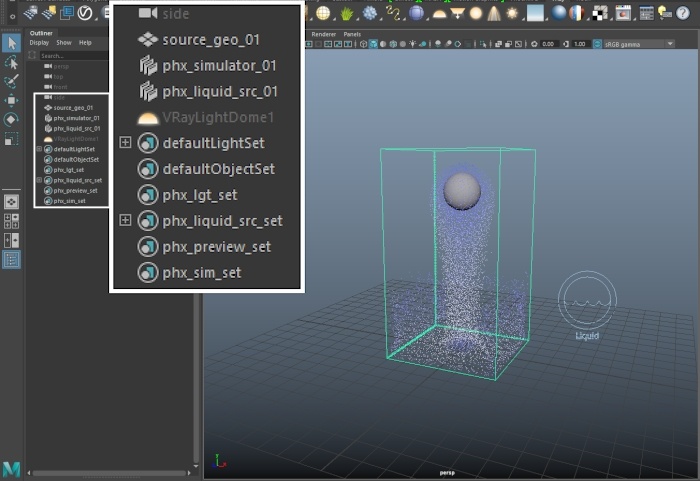

Create a second Phoenix Liquid Simulator and rename the nodes as follows:
1. Rename the simulator node to phx_simulator_02.
2. Rename the generated sets to phx_sim_set_02 , phx_lgt_set_02 and phx_preview_set_02. For more information on the purpose of those sets, please check the Creating a Simple Liquid Simulation tutorial.

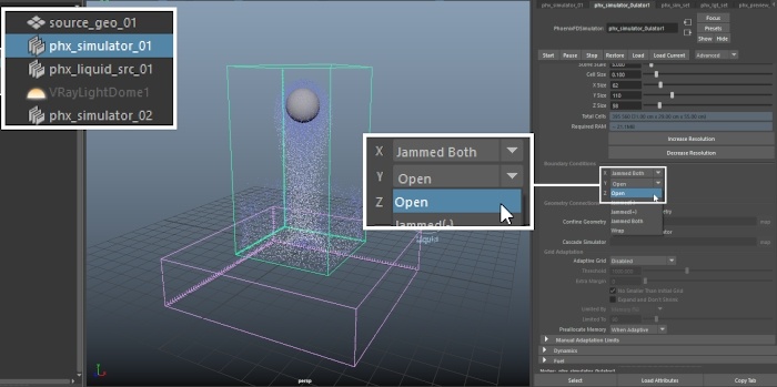

In the Grid tab of phx_simulator_01, set the Container Walls Y to Open.
When creating a Cascade setup, it is important to keep in mind the Container Walls settings of the participating Simulators.
The liquid should be able to exit the first simulator in order to enter the second one.
Thus, both the bottom of phx_simulator_01 and the top of phx_simulator_02 need to be Open.

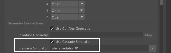

To create the Cascade connection between the simulators, first select the destination (phx_simulator_02) then the source (phx_simulator_01) and go to Phoenix FD Menu → Set Simulator Cascade Connection.
You should now have a link between the two grids.
Note that in the Attribute Editor -> Grid tab of phx_simulator_02, the source simulator is listed under the Cascade Simulator field.

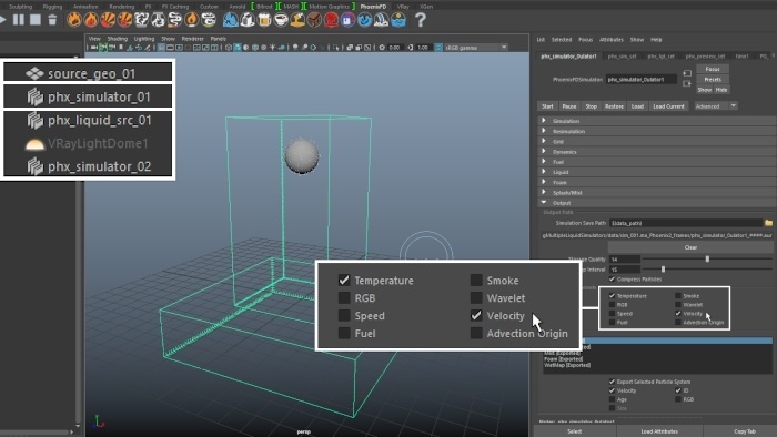

The last step is to make sure that Velocity channel export is enabled from the Output tab for the source simulator.
Select phx_simulator_01, go to the Attribute Editor → Output and enable Velocity.
If the Velocity channel export is disabled, Phoenix will print the following warning in the Script Editor:
// Warning: Phoenix FD: Cascade connection will not work properly due to missing channels in the Source simulator!
Please export them from the Source simulator's Output panel, simulate it again,
and then run this simulator again. The missing channels are: Grid Velocity //

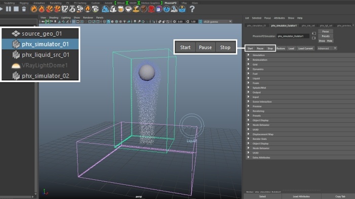

Select phx_simulator_01, press Start and wait for the simulation to finish.
The workflow is as follows:
First, the source grid is simulated and the contents are cached to disk.
Then, once the first simulation is complete, you start the second simulation.
The second simulator uses the cached files to determine where to add the liquid and how it should move once generated. This is why the Velocity channel from the first (source) simulator is required.

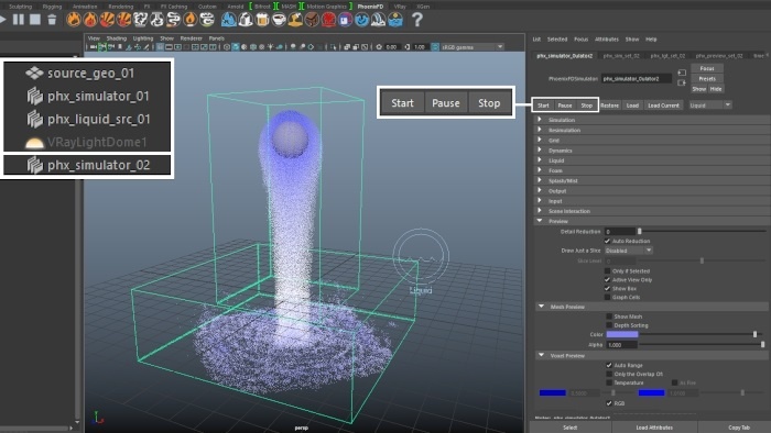

When the first simulation is complete, select phx_simulator_02 and press Start.

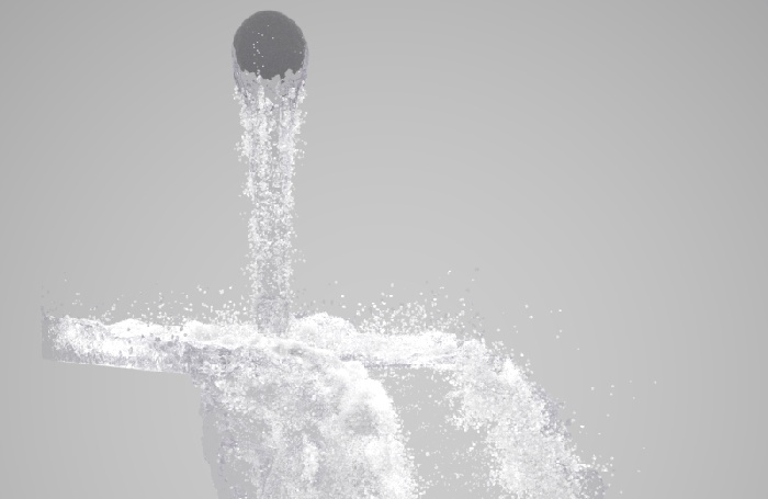

The liquid that exits from the bottom of the source simulator appears at the top of the destination one.
You may repeat those steps to link a 3-rd simulator to the 2-nd one, and so on.
