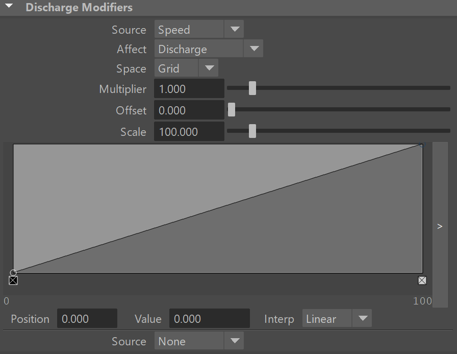

UI Path: ||Select PhoenixFDSource|| > Attribute Editor > Discharge Modifiers rollout
A list of modifiers modulate the emission using properties of the emission geometry at the point of interaction with the simulator. A ramp control is used to remap from the value of the specified property (i.e. Speed) to a multiplier ranging from 0.0 to 1.0.
Source | modifiers[0].source – This is the property of the emitter that will be used to modify the Source's parameter selected in the Discharge Modifier's Affect option. The value of each parameter is mapped to the horizontal X-axis of the ramp. Along the Y-axis is the strength of the discharge. Each entry from the list below has a certain range that you should watch out for, e.g. some values range from -1 to +1 along X, while others range from 0 to a few hundred.  You can find out more information about the usual ranges of Phoenix channels on the Grid Channel Ranges and the Particle Channel Ranges pages:
  • None - Disables the Discharge Modifier.
  • Random – A random number in the interval [0,1] will be assigned to each voxel of the emitter.
  • Position X/Y/Z – The coordinates of the voxel will be used. In Grid space, the coordinates inside the simulator will be used and will be normalized to the interval [0,1]. In Object space, the coordinates inside the geometric object will be used and will be normalized to the interval [0,1].
  • Normal X/Y/Z – The surface normals of the geometry will be used in the interval [-1,+1]. Note that this will always return 0 if the emitter is a particle system.
  • Velocity X/Y/Z – The velocity of the emitter's voxel will be used. This will work when the emitters are particles, meshes and shapes, and in case of meshes and shapes will work for any translating, rotating, scaling, and rigged geometries, as the velocity of each voxel of these geometries will be calculated by Phoenix and used by the Discharge Modifier. Note that this value may vary from several hundred to over a thousand and can be negative depending on the velocity's direction. The velocity is in the scale of the selected Space - in Grid space it will be in voxels/sec, and in World or Object space it will be in world/object units per second.
  • Speed – The speed of the emitter's voxel will be used. This will work when the emitters are particles, meshes and shapes, and in case of meshes and shapes will work for any translating, rotating, scaling, and rigged geometries, as the velocity of each voxel of these geometries will be calculated by Phoenix and used by the Discharge Modifier. Note that unlike Velocity X/Y/Z which is a direction broken down to the X, Y and Z components, Speed is the total velocity amount and is always positive. The speed is in the scale of the selected Space - in Grid space it will be in voxels/sec, and in World or Object space it will be in world/object units per second.
  • Particle Age – The age of each emitting particle will be used. Note that this will work only when you emit fluid from particle systems. It will always return 0 when emitting from meshes and shapes. This value maps along the X diagram axis from 0 and is always positive.
  • Particle Size – The size of each emitting particle will be used. Note that this will work only when you emit fluid from particle systems. It will always return 0 when emitting from meshes and shapes. This value maps along the X diagram axis from 0 and is always positive. The size is in the scale of the selected Space - in Grid space it will be in voxels, and in World or Object space it will be in world/object units.
Affect | modifiers[0].affect – Specifies which emission property of the Source will be modified by this Discharge Modifier:
  • Discharge - the selected modifier will be applied to the total Discharge value of the Source.
  • Temperature - the selected modifier will be applied to the Temperature channel emission.
  • Smoke - the selected modifier will be applied to the Smoke channel emission.
  • Fuel - the selected modifier will be applied to the Fuel channel emission.
  • Particles - the selected modifier will be applied to the emission of Particles from the Source.
  • Motion Velocity - the selected modifier will be applied to the Motion Velocity effect of a moving emitter.
  • RGB - the selected modifier will affect the brightness of the RGB emitted from the Source.
  • Viscosity - the selected modifier will be applied to the Viscosity of liquid emitted from the Source.
Space | modifiers[0].space – The coordinate system of the Source option:
  • Object - The modifying parameter will act in the coordinate system of the emitter object. If the object moves or rotates, it will always keep emitting from the same areas.
  • Grid - The modifying parameter will act in the simulator's coordinate system. This way you can make objects emit when they enter a certain area of the simulator and if the simulator moves or rotates, the area will move along with the simulator.
The Up axis of the simulator grid is Z as opposed to the default Maya Up axis which is Y. Therefore, the Up axis for Position/Normal/Velocity is Z when the Space is set to Grid.
  • World - The modifying parameter will act in world coordinate system. This way you can make objects emit only in certain areas of the scene. If you use the normals to modify the discharge, in world space you could make an object emit only upwards regardless of how it rotates or where it moves.
Multiplier | modifiers[0].rampMaxValue – A multiplier for the ramp values. This allows the Discharge Modifier to produce stronger or weaker effect.
Offset | modifiers[0].rampOffset – The ramp start value, corresponding to the minimal value of the Source property. E.g. if Source is set to Speed, this should be the minimal value of the Speed of the emitter - usually 0. If Source is set to Normal, this should be at least -1 because this is the smallest value a Normal can take. If Source is set to Position, then this would be the minimal position value that matters for the discharge modifier.
Scale | modifiers[0].rampScale – The ramp range, corresponding to the data span of the Source property. E.g. if Source is set to Speed, this should be the range of the emitter speed - which can go up to several hundred. If Source is set to Normal, this should be at most 2 because the normals range from -1 to 1 and this interval is 2 units wide. If Source is set to Position, then this would be the maximum minus the minimal position value that matters for the discharge modifier.
Diagram | modifiers[0].rampAlpha – The ramp diagram for mapping the source value of the emitter to a multiplier.

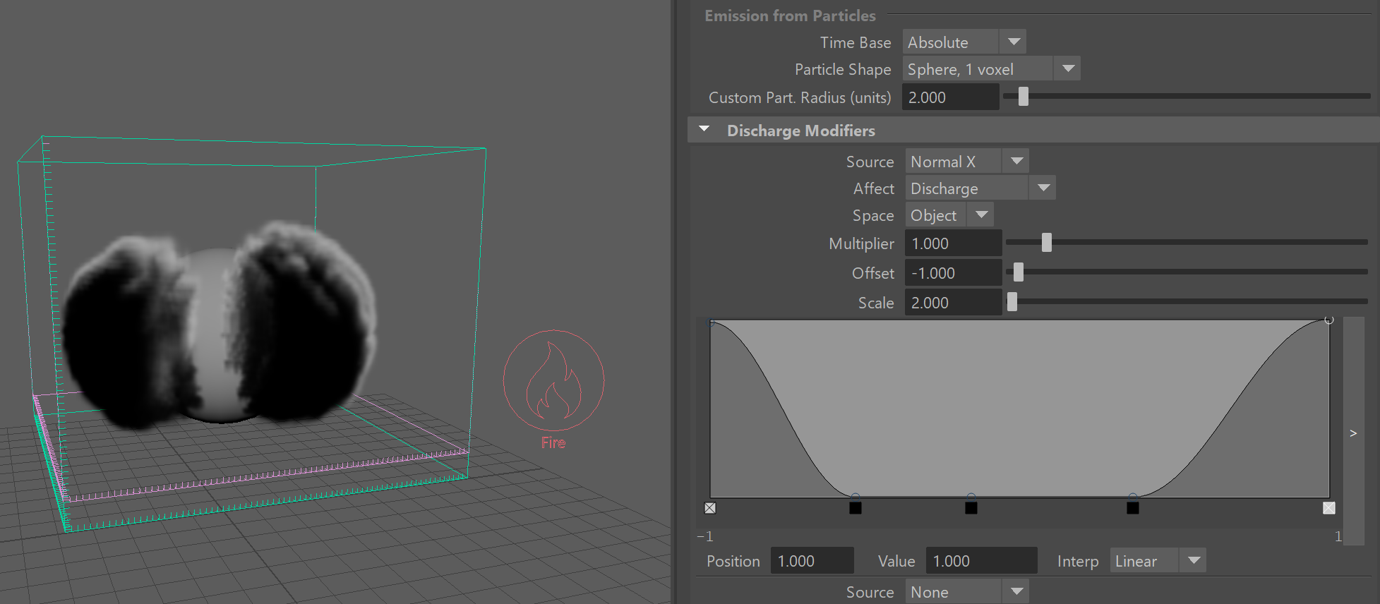

Another example is the following setup where the normals of the geometry are used to emit smoke. In this case, the normals are used in Object Space, so even if the object starts rotating, it would emit from the same areas. Note that the valid values for normals range from -1 to 1, instead of just 0 to 1. This way the negative values denote normals which point along the negative axis (in this case, to the left of the sphere), while the positive point along the axis direction from the object's transform (in this case, to the right of the sphere). In this example, the normal along the positive axis allows Smoke emission only when the normal's length along the object Y axis is between about 0.6 and 0.7, which means only from such normals which are at an angle and are neither horizontal nor vertical:
