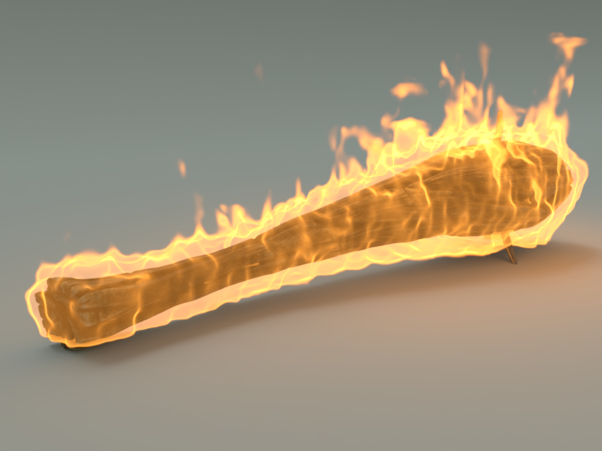

The following example shows wooden club object ready for burning. For the fire setup, the club itself will be the emitter.

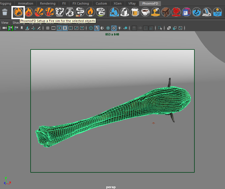

To create a fire simulation, select the object(s) you wish to burn and click the Fire Quick Simulation button on the Phoenix Shelf.

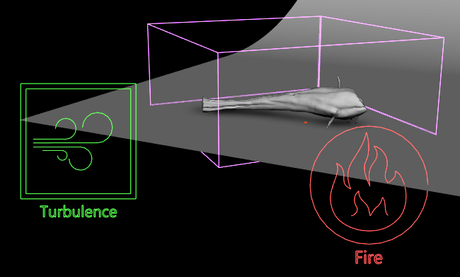

The Fire Quick Simulation button creates three objects in the scene and sets up their parameters for a fire simulation:
  • PhoenixSimulator - A box-shaped object that represents the grid within which the simulation takes place. The grid shape encompasses the emitter objects and also leaves space above the objects for the fire to flow. This non-rendering object is required for the simulation.
  • PhoenixSource - Labeled Fire in the viewport, this component associates the emitter(s) with the simulation. This object is required for the simulation.
  • PhoenixTurbulence - Labeled Turbulence in the viewport, this force component creates turbulence in the simulation. This object is optional, and is added to the Quick Simulation setup to improve the results of the simulation.

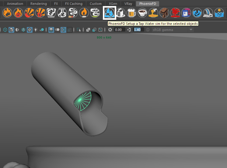

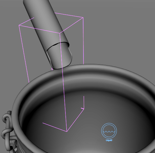

To create a liquid simulation, select the emitter object(s) and click the Tap Water Quick Simulation button on the Phoenix Shelf.
Here, the small planar object inside the spigot is selected as the emitter.
The Liquid Quick Simulation button creates two objects in the scene and sets up their parameters for a liquid simulation:
  • PhoenixSimulator - A box-shaped object that represents the grid within which the simulation takes place. The grid shape encompasses the emitter objects and also leaves space below the objects for the liquid to flow. This non-rendering object is required for the simulation.
  • PhoenixLiquidSource - Labeled Liquid in the viewport, this component associates the emitter(s) with the simulation. This helper is required for the simulation.

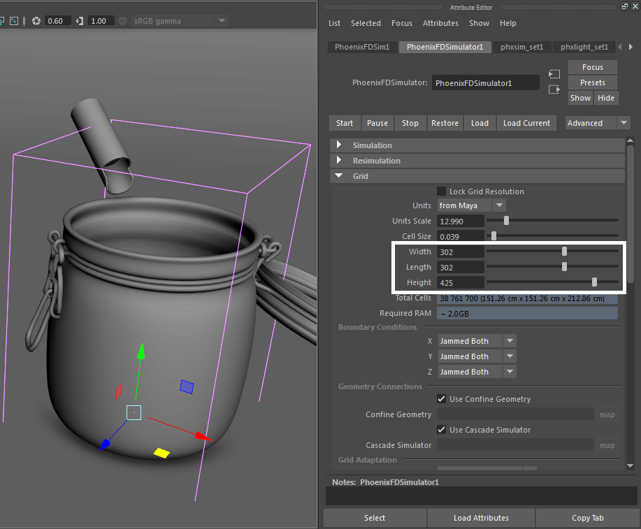

In this case, the Grid that was automatically created is not large enough to encompass a simulation of water flowing down the trough.
To increase the Grid Size, select the Simulator and change the X/Y/Z size parameters in the Grid rollout.

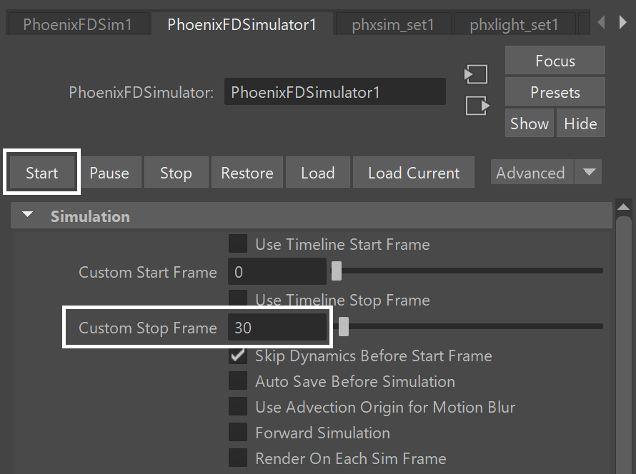

  1. Select the Phoenix Simulator object (the box around the emitters).
  2. In the Attribute Editor, locate the Stop Frame parameter in the Simulation rollout. Increase this value from 0 to a larger frame number such as 30.
  3. In the Simulation rollout, click the Start button. The simulation will start running.

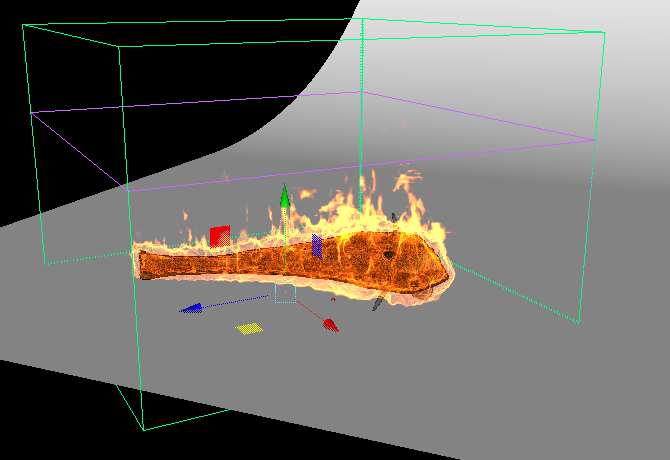

While running the simulation, you will see the fire or liquid flowing in the active viewport.
In addition, the Grid might expand beyond its original size to allow the effect to flow into a larger area.
You can also select other objects and continue working on the scene while the simulation runs.

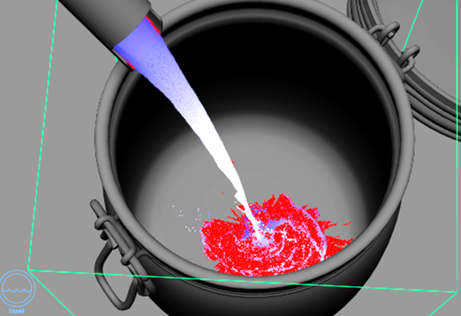

In a liquid simulation, you will see the liquid particles react to gravity and also get deflected or contained by any scene geometry they encounter, such as the jar. This collision detection occurs by default, even though you have not specifically designated the jar geometry as a deflector or collision object.
