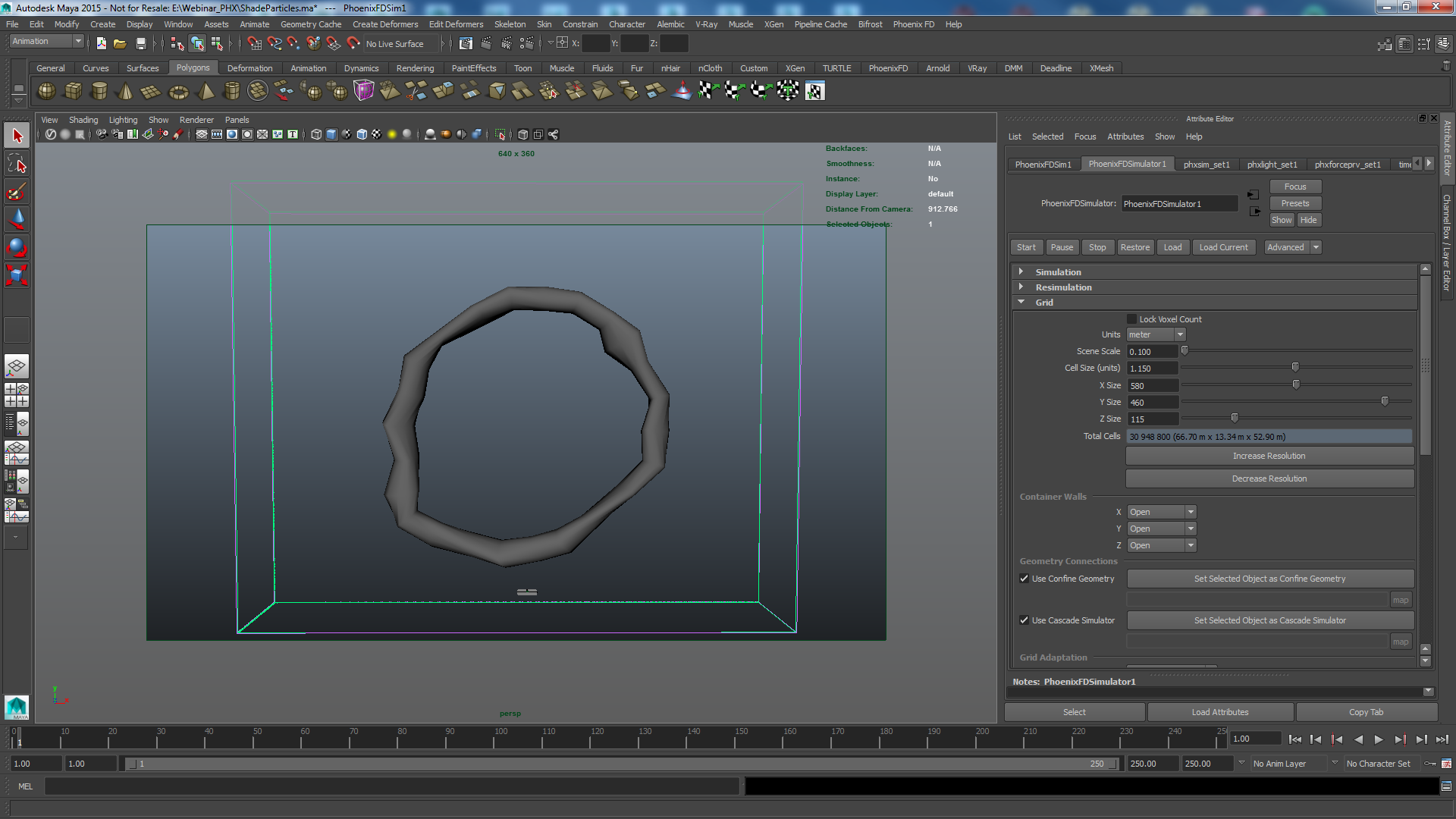

Create a Phoenix Simulator and set the Grid → Cell Size to 1.15.
Set the Size X / Y / Z to 580 / 460 / 115 respectively.
Set the Units to meter.
Set the Scene Scale to 0.1 - this would make our liquid swirls move a bit slower.

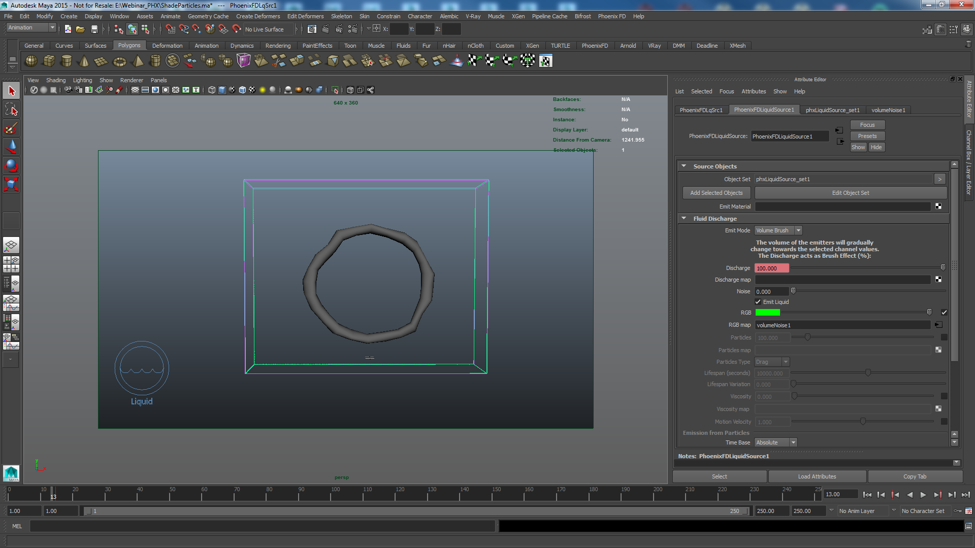

Create a Phoenix Liquid Source and add the torus to the Emitter Nodes list by using the Add button.
Set the Emit mode to Volume Brush (you will be prompted with a message box letting you know that in order for the Volume Brush mode to work you need to set the object to Non-Solid, click on the Make Non-Solid button) and animate the Brush Effect from 100% at frame 13 to 0% at frame 14. Using the Volume Brush mode the volume of the emitter object will be gradually filled with liquid and in this way giving us a lot more particles to work with.
Turn on the RGB channel and plug a Volume Noise texture in the map slot.
For the Volume Noise texture set the Threshold to 0.288. Set the Amplitude to 5, Ratio to 0.626, Frequency Ratio to 1.00, Depth Max to 8.
Set the Frequency to 0.005, Scale to 0.5, 0.5, 0.5 and Noise Type to Perlin Noise.
In the Color Balance rollout of the Volume Noise texture set the:
Color Gain to R: 0.923 G: 0 B: 1.00 for RGB 0 to 1.00;
Color Offset to R: 0.00 G:0.27 B: 1.00.
Turn on the checkbox for Alpha is Luminance.
In the Effects rollout turn on Invert.

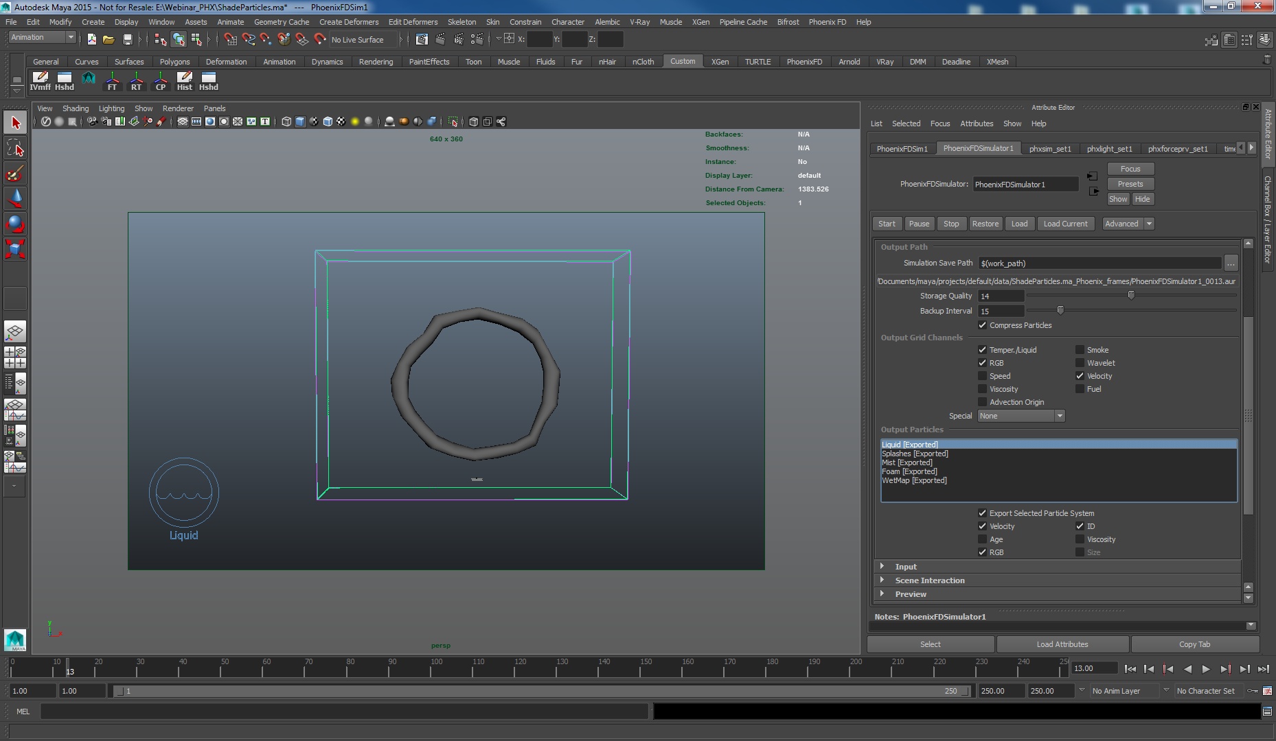

Select the Phoenix Simulator and from the Dynamics rollout disable the Gravity checkbox. This way once the liquid is emitted it won't start falling down due to the gravity.
As later we would want to shade our particles based on the liquid channels we need to set those for export to the cache files.
In the Output rollout tick the checkboxes for Velocity and RGB for both the Output Particles and the Output Grid channels.

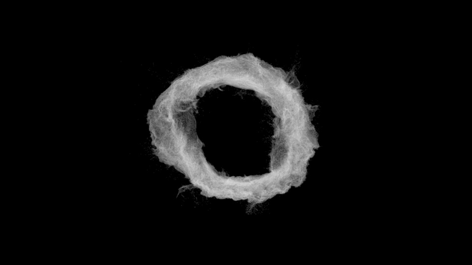

If we hit the render button now you will get something similar.
You will notice that the particles look too dense and burn out. In order to bring back some of the detail let's select the Particle Shader and set the Point Alpha to 0.01 and the Shadow Strength to 0.

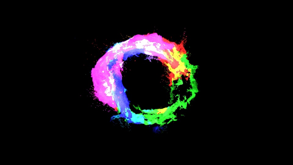

As we have already simulated the particles' RGB channel - we would want to use that for the color of our particles. In order to do that we would need a way to read this channel and tell the Particle Shader to use it.
Select the Particle Shader, enable the Color Map checkbox and in the map slot plug a Phoenix Particle Texture.
From the Particle Texture options click on the button for the Particle Systems and connect the ParticleTex set to the Liquid Particle group.
Turn on Use Color From Particle Channel and select the RGB channel. If we render out the result looks like this.
The particles are shaded by the RGB channel, though the color looks a bit pale. We can fix that by increasing the Color Intensity inside the Phoenix Particle Texture.
Set the Color Intensity to 5 and render again.

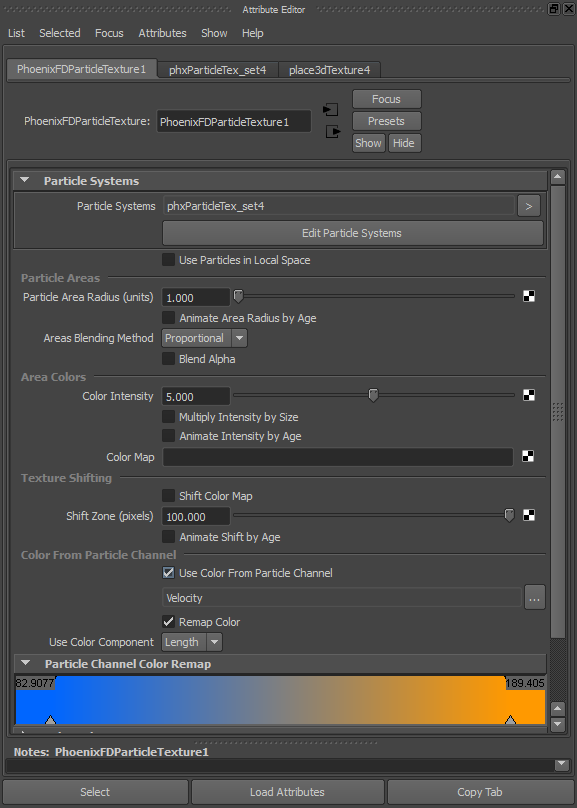

From the Phoenix Particle Texture option set the Use Color From Particle Channel to use the Velocity channel.
Rendering the result looks like this - not quite what we're after. It currently colors the particles using the velocity vector and the result is similar to what you will see in a 'Normals' render element.
Turn on Remap Color from the Particle Texture options and set the Use Color Component to Length. This way the texture will use the speed of the particles, which is the length of the velocity vector.
Double click on the first color point to set its color and use R: 0, G: 0.4, B: 1 for RGB 0 to 1.0.
Double click on the second color point and set the color to R: 1, G: 0.6, B: 0 for RGB 0 to 1.0.
Moving the points, we can control how to colors are remapped based on the speed.
In order to figure out what the real velocity range is you can open the Simulation rollout of the Liquid Simulator and inside the Cache File Content check the range values for the Velocity channel. In this case it's from 0 to 389.70.
Move the first color point to position of 86 and the second one to 198. This way the gradient will tighten up and give the result a bit contrast look. Note that the numbers displayed on the color gradient are the leftmost and rightmost points on the gradient, and not the positions of the color markers.
