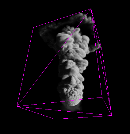

GridView
GridView is a simple smoke rendering implemented in OpenGL. it is located in the \samples\GridView directory.
Prerequisites:
In order to build this sample, all external libraries must be located in a GridView/external_libs.
Build steps:
  • Place all external libraries in GridView/external_libs.
  • Use CMake to generate project files that best suite you needs. Please take in account the C++ Platform Toolset that is used by your version of Phoenix API. See the Using Phoenix API section.
  • Set PHOENIX_SDK_DIR to Phoenix API, for example: C:\Program Files\Chaos Group\Phoenix FD\Maya NNNN for x64\SDK.
  • Generate the project files and build.
