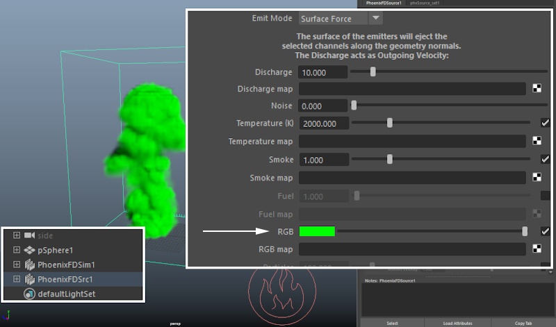

Finally, select the Phoenix Source and enable RGB. The color swatch to the right (green by default) is used to specify what color is emitted into the RGB channel from the source geometry (the Sphere).
If you run the simulation, the Smoke should now be green.
Note that the emission with this setup is uniform. You can have 3 different spheres with 3 separate Phoenix Sources whose RGB emission is set to a different color. In the next chapter we see how to use a single Phoenix Source to emit different colors all from the same geometry.
Hit Phoenix Simulator → Start. The color of the smoke in the viewport should now be green.

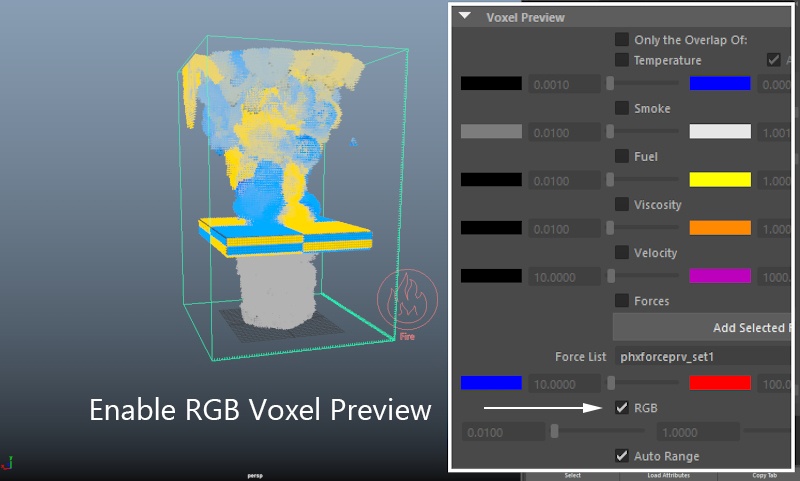

Instead of using the Smoke channel as the middle-man, you can preview the RGB Channel directly. To do so, go to Simulator → Preview rollout → GPU Shade Preview sub-rollout → disable GPU Preview.
Then, in the Voxel Preview section, enable RGB at the bottom and disable all the other channels.
You should now be able to see the values in the RGB channel even before the Smoke comes into contact with it.
The voxel preview can be quite useful for debugging your setup.

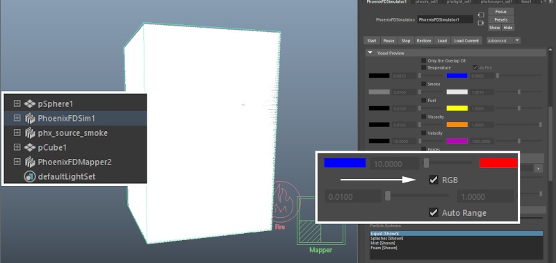

Open the Preview rollout of the Phoenix Simulator and disable GPU Preview.
Enable Voxel Preview → RGB and disable Smoke, Temperature, etc. if those are enabled.
The voxel preview will allow you to easily check how the Mapper is affecting the RGB Channel.
Go to the Simulation rollout and uncheck Use Timeline Stop Frame. Set Custom Stop Frame to 2 so the simulation will only run for one frame.
Hit Start.
The entire RGB Channel should now be white.

Plug the Distance Texture into the Mask slot of the Phoenix Mapper and remove it from the Map slot with Right-Mouse-Button → Break Connection.
Add a Checker to the Map slot (or any other texture - that's up to you).
Increase the Simulation → Stop Frame value to 10 or so and hit Start to run the simulation.
If you're looking at the voxel preview, you will notice that the RGB is correctly set up at the start of the simulation but once the smoke reaches it, it gets diluted and disappears.
The reason is the Mapper settings. By default, the Initializer option is enabled. This means that the Mapper will set the specified channel (RGB in our case) to whatever value is provided by the Map on the first frame of the simulation and then it will become inactive.
Disable the Initializer option, so the Mapper would affect the entire duration of the simulation.
Lastly, the Buildup Time parameter at the bottom controls how quickly the Mapper will set the affected cells of the simulator to the specified Map value. Buildup Time is in seconds - the default value of 1 means that the Mapper will gradually set the RGB channel for the affected voxels over 1 second.
Set Buildup Time to 0 so the effect is instantaneous. If you want the colors to mix on contact instead of being outright overwritten, setting this to 0.1 or so should be a good starting point.
That is all. You can hit Start to run the simulation.
