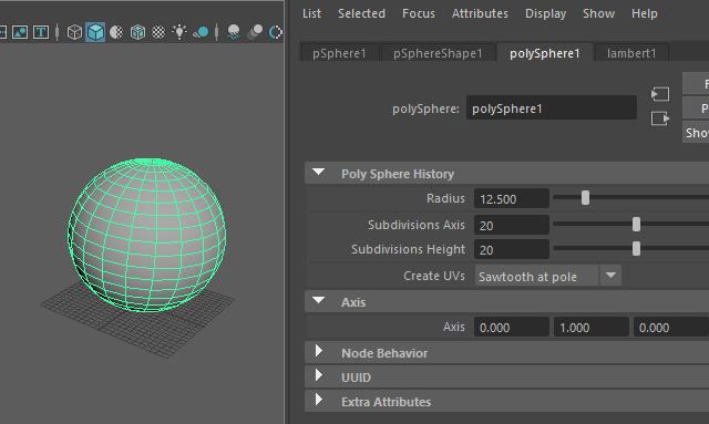

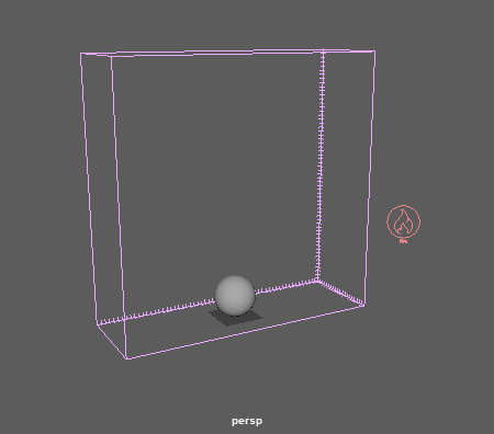

Create a Sphere with a Radius of 12.5cm. The exact size is not crucial.
With the sphere still selected, click on the Large-scale Smoke sim Preset button from the Phoenix Shelf.

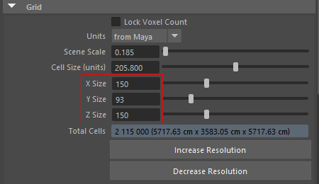

Select the Simulator. In the Attribute Editor under the Grid rollout are located the parameters to control the resolution of the volume grid, which greatly affects the look and performance of the simulation.
Currently, there are about 300,000 Total Cells. To save on simulation time during the iteration process, click Decrease Resolution six times until the Total Cells are around 5,000.
For more information regarding simulation resolution, please refer to the Basic Liquids QuickStart page.

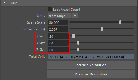

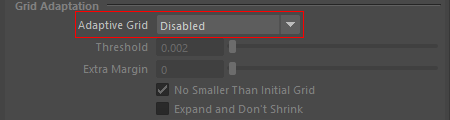

Disable the Adaptive Grid and set the X/Y/Z Size of the Simulator to 20, 60, 60. This way the simulation is fairly flat and at a very low resolution that will resolve quickly.

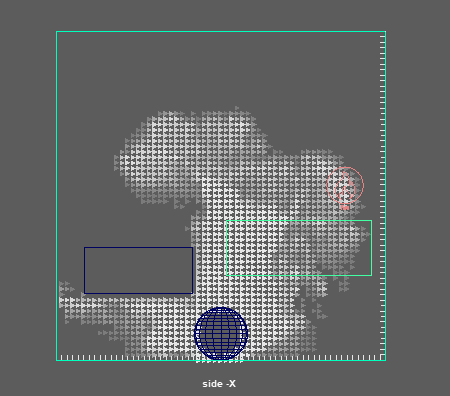

Create a Box and place it above the sphere, slightly off to the right side as shown in the picture.
Adjust the end time playback range to 1200 so we have more frames to play with.
Now press the Start Simulation button in the Shelf. Let the simulation run while you continue with the next few steps.

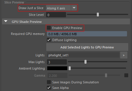

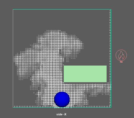

In order to better see how the Smoke interacts with the simulation, go to the Preview rollout → GPU Shade Preview and disable Enable In Viewport.
Then, enable Draw Just a Slice with the Axis set to X, as shown on the picture.

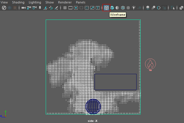

We can clearly see that the Smoke collides with the box, and goes around it. And we didn’t need to do anything to make that happen. That’s because, by default, meshes are treated by Phoenix as Solid Objects, which means the object becomes an obstacle to the fluid's motion.
Make sure that any mesh you want to use in this manner is closed. Don’t use planes or flat sheets of geometry. If you need to use geometry that appears flat, you will need to add a small amount of thickness to it so it calculates properly within the simulation.
Press 4 or use the Wireframe icon located in the upper viewport menu to switch to Wireframe mode for better visibility.
Notice that the inside of the object is empty, and the Smoke goes around the volume, as shown in the picture.

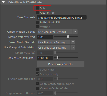

Now, select the box. In the Attribute Editor, expand the Extra Phoenix FD Attributes rollout.
A checkbox for Solid Object parameter is enabled by default. Turn it Off.
The Smoke passes right through the box. This box is a Non-Solid, which means the box is a part of the simulation, but won’t interact with it.

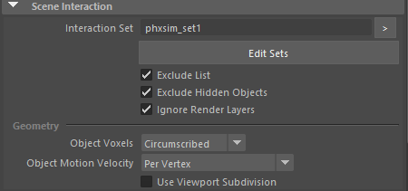

There is another way to make objects not interact with the simulation. With the Simulator selected, go to the Scene Interaction rollout.
You can manage objects that do or don’t interact with the simulation in the rollout shown in the picture.
There is a difference between having a Non-Solid Object, like we have right now, and excluding an object from the interaction.
A Non-Solid Object, such as the one in the scene, can still be used with Forces (e.g. as an attractor for the Body Force) and also as an Emitter by Source objects. It can also be used as a Render Cutter, or a Birth (or ignition) Volume, and so on.
On the other hand, objects excluded through the Scene Interaction rollout will not interact at all with the simulation.

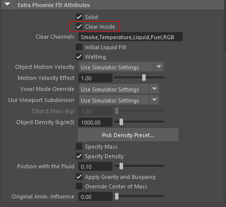

Select the box and access the Extra Phoenix FD Attributes. Enable the Clear Inside option, which lists the different channels of the simulation that are affected. You can edit this list to control what kind of particle channels are cleared inside the Non-Solid.
Now you can see that the Smoke inside the box is gone.
The difference between the Solid Object that we had before, and this Non-Solid with Clear Inside, is that the fluid moves around Solids but passes right through the Non-Solids. This way you can use Non-Solids with Clear Inside to erase Smoke, Temperature, Liquid, or different particles from certain areas of the Simulator without effecting the fluid's behavior.

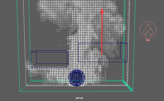

While the simulation continues, create another Box in the scene that is a similar size to the first one. Move it up, inside the container in the path of the Smoke, and it traps some of the Smoke inside it, as in the image.
When creating or moving a Solid Object inside a Fire/Smoke simulation container, it can trap fluid channels inside itself. Note that this behavior does not apply to a Liquid Simulator.
Move this box around some more and you can see that some of the Smoke trapped inside the volume earlier is still stuck inside, and it may capture more.
Again, that’s because by default, all objects are treated as Solid Objects, so the Smoke can’t escape once inside.
Select that second box and open its Extra Phoenix FD Properties. Turn on Clear Inside.
The Smoke is gone from inside that box.
Finally, select the first box and disable the Clear Inside, so the Smoke goes right through it.
The box on the left is a Solid Object and the box on the right is a Non-Solid Object. Moving the Non-Solid box inside the Simulator changes nothing - it does not change the behavior of the simulation.
But if you move the Solid Object box, it effects the Smoke simulation. If you move it around, the Smoke gets pushed to the side.

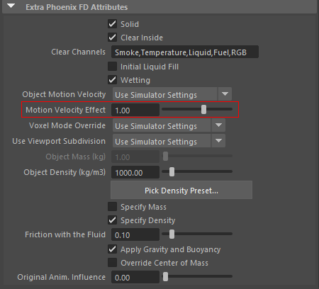

You can control how strongly a moving Solid Object effects the simulation from its Phoenix FD Attributes using the Motion Velocity Effect parameter.
We will take a look at this in our next example.

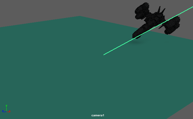

The scene contains a spaceship crashing into the ocean.
The ocean geometry plane (oceanSurfaceReference) in the scene was used for blocking the animation and is only for previewing purposes.
Hide the plane by selecting it and pressing H.

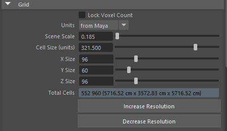

Make the simulation grid a bit smaller with an X/Y/Z Size of 15093, 150.
Click the Decrease Resolution button twice to have faster feedback.
The Total Cells will decrease to around 500,000.
Reposition the Simulator around the spaceship's path, moving it closer to the camera in Z, and a little lower in Y to give the spaceship more space to splash down.

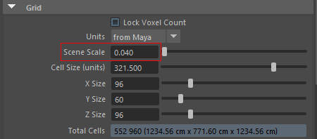

The Ocean preset assumes that the geometry in the simulation is a large sea vessel, but the spaceship is much smaller than this.
So in the Grid rollout, decrease the Scene Scale to 0.04.

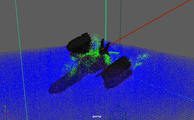

Start the simulation. Notice that the spaceship creates much bigger and more dramatic splash.
Stop the simulation around frame 50 and scrub the animation to study the new splash.
You may have some particles that are leaving the Simulator.
Let’s say we don’t need these Splash and Foam particles that go outside the Simulator. We can even speed up the simulation time by deleting them once they leave the grid.

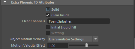

With the cube selected, add the Extra Phoenix FD Attributes to it by navigating to Attributes → Phoenix FD → Phoenix FD Node Properties.
Uncheck Solid Object, so the box won’t affect the simulation.
Turn on Clear Inside and then type in Foam, Splashes to clear only those types of particles from the simulation.

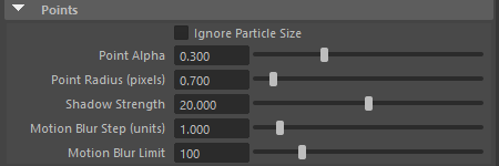

In the Points rollout change the Point Alpha to 0.3, the Shadow Strength to 20, and the Point Radius to 0.7.
Again, do this for PhoenixFDSim1_SplashesShader as well.
This makes the particles more opaque in the render, making them look nicer.

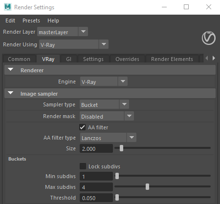

To prepare your scene for rendering a simulation make sure V-Ray is set as your Renderer in the Render Setup window.
Render out the view. Pretty quickly you will see the ocean, the splash, and a giant box! Stop the render.
