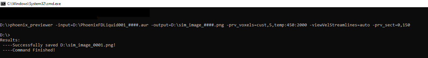

phoenix_previewer -input=D:\PhoenixFDLiquid001_####.aur -output=D:\sim_image_####.png -prv_voxels=cust,5,temp:450:2000 -viewVelStreamlines=auto -prv_sect=0,150

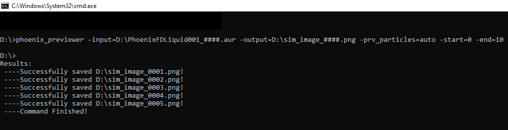

phoenix_previewer -input=D:\PhoenixFDLiquid001_####.aur -output=D:\sim_image_####.png -prv_particles=auto -start=0 -end=10
