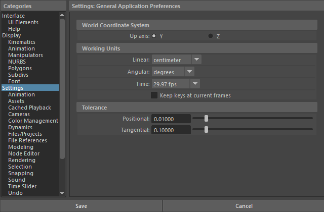

Go to Windows → Settings and Preferences → Preferences → Settings and set the Working Units to Centimeters.

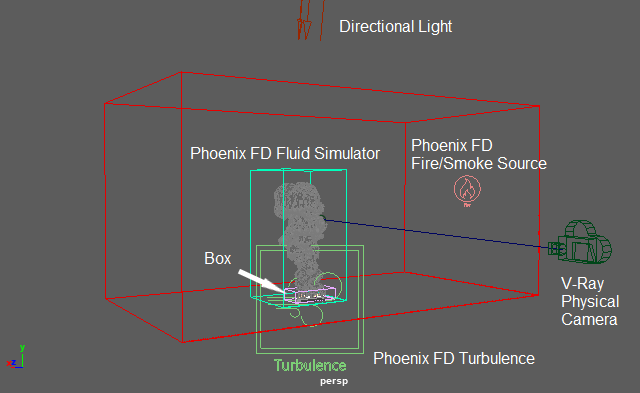

The final scene consists of the following elements:
  1. A Poly Model → Box used as the smoke source.
  2. Phoenix Fluid Simulator.
  3. Phoenix Fire/Smoke Source emitting smoke from the Box geometry.
  4. Directional Light for lighting.
  5. V-Ray Physical Camera for rendering.
  6. Phoenix Turbulence for disturbing the smoke motion.

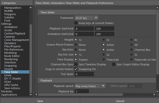

Set the Windows Settings/Preferences → Preferences → Time Slider from 0 to 200 so that the Timeline goes from 0 to 200.

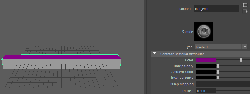

The Phoenix Source nodes can use an Emit Material assigned only on those faces which will be used for emission of fluid.
Select the Box geometry and go into Face Selection mode.
Select only the top faces which will be used for the emission and assign them a new Lambert material. Change its name to mat_emit.

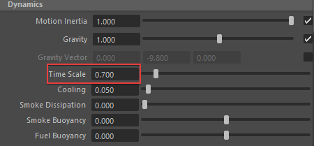

Slow Down the Smoke
Our final goal for the simulation is a smooth, natural-swirling, cigarette smoke look. So all of the following steps aim at this goal. Now the smoke appears to be running too fast.
To slow it down, change the Time Scale from 1.0 to 0.7.

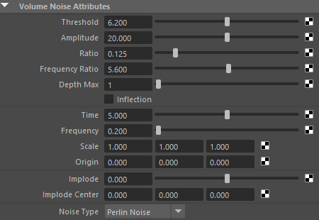

Plug a Volume Noise Texture in the Texture slot. Change its name to "volumeNoise_test".
You can set up the Volume Noise Texture from scratch, or you can find this texture in the "PhoenixFD_Thin_Smoke_Maya_END.ma" scene file, in the Hypershade. It is called "volumeNoise_test".
Next, go to the Hypershade and select the volumeNoise_test texture.
Set the Noise Type to Perlin Noise.
Threshold to 6.2.
Amplitude to 20.0.
Ratio to 0.125.
Frequency Ratio to 5.6.
Depth Max to 1.
Time to 5.0.
Frequency to 0.2.

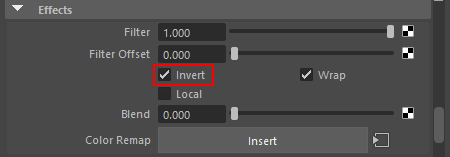

Then, scroll to the Effects rollout and enable Invert.
All of these Volume Noise Texture settings are for demonstration purposes, so we can clearly see how the growing smoke distorts the Texture UVW and affects the applied Volume Noise Texture.

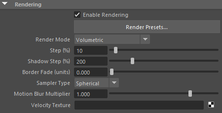

To alleviate grid artifacts during render time, set the Sampler Type to Spherical (found in the Rendering rollout).
Here the Rendering Step % is set to 10. This parameter specifies the ray marching step of the camera rays as a percentage of the cell size. In this step we set the Noise texture to be in contrast, so it tends to render out a noisy image. Because of that, we have to lower the value of Step % to reduce the noise and be able to capture all of the fine details of the smoke. A larger step size skips over some texture details. For a less contrast Noise texture, you can increase the value of Step % to save rendering time.
Smaller Step % could increase render time dramatically. The default value is 90% of the voxel size. You should lower this parameter only if you get unacceptably noisy images.

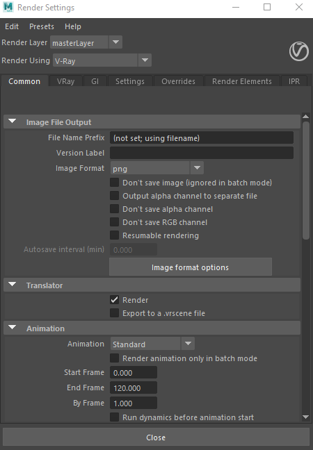

Set the Animation from 0 to 120. Press the Render button to render the animation.
Here's a rendered animation so far.

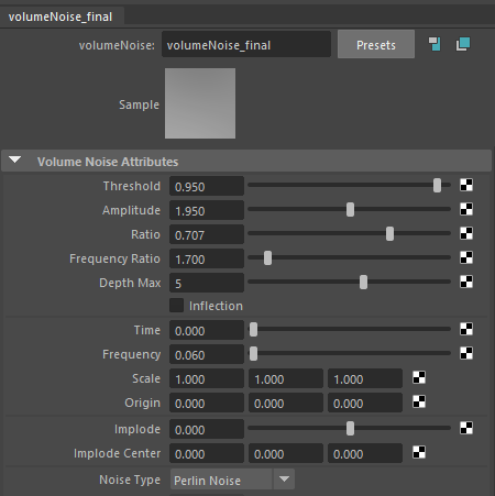

Let's adjust the final Volume Noise Texture for the Texture slot of the Smoke Opacity. The settings for the texture are now optimized in order to minimize the unnatural look of suddenly appearing/disappearing islands of smoke.
Plug a Volume Noise Texture in the Texture slot. Change its name to "volumeNoise_final".
You can set up the Volume Noise Texture from scratch or you can find this texture in the "PhoenixFD_Thin_Smoke_Maya_END.ma" scene file, in the Hypershade. It is called "volumeNoise_final".
As shown, set the Noise Type to Perlin Noise.
Threshold to 0.95.
Amplitude to 1.95.
Ratio to 0.707.
Frequency Ratio to 1.700.
Depth Max to 5.
Time to 0.0.
Frequency to 0.06.

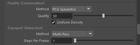

To achieve a better swirling motion in the simulation, we can change the conservation mode and increase the Conservation Quality parameter under the Dynamics rollout. Set the Conservation Mode to PCG Symmetric, Quality to 50.
The PCG Symmetric conservation mode is ideal for smoke simulations or explosions because it tends to produce strong conservation which needs less conservation quality in order to look realistic. This method is also used for the Cigarette Smoke quick preset. So we choose this mode.
Go to the Fire/Smoke Simulator, and run the simulation again.
Beware that increasing the Quality would make the simulation take longer time. You can adjust the value depending on your preferences.

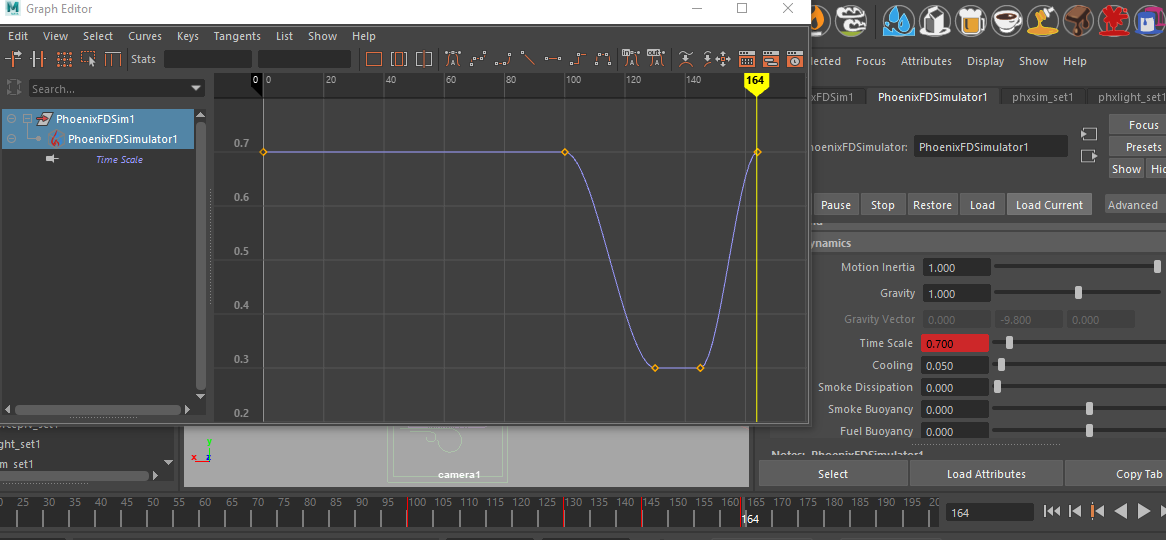

Now, in order to make our animation more interesting, we can animate the Time Scale. This section of the tutorial is optional – you may skip to the Rendering section below.
To create the bullet-time effect, open the Dynamics rollout of the Phoenix Simulator and animate the Time Scale parameter as follows:
Frame 0: 0.7
Frame 100: 0.7
Frame 130: 0.3
Frame 145: 0.3
Frame 164: 0.7
The Time Scale is a global multiplier for the dynamics of the Simulator. Reducing it uniformly scales down all sources of velocity in the simulation.
