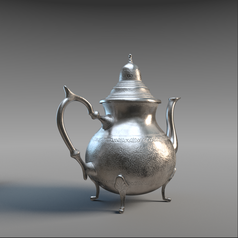

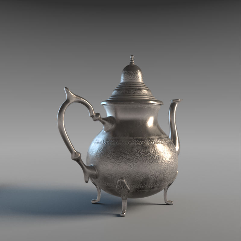

Example: Environment Override
This example demonstrates the effect of the Environment Override parameter. In the first image, the Environment Override option is off and the scene is rendered with the default environment. In the second image, a Gradient map is assigned and used as a reflection environment.
off
on

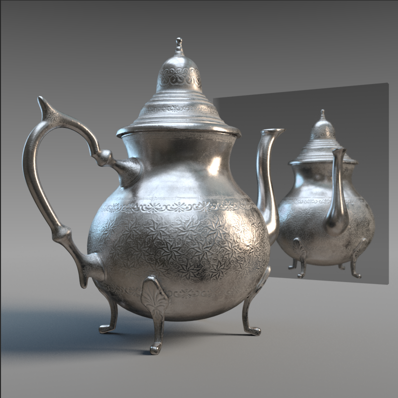

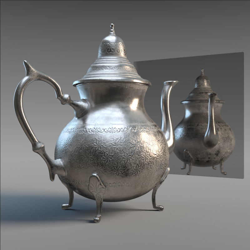

Example: Environment Priority
This example demonstrates the effect of the Environment Priority parameter. Here, a teapot and a mirror-like plane have different environment maps assigned to their materials. In the first example, the texture map of the teapot has a higher priority than the texture map of the mirror. Each object reflects its own environment map as seen from the camera. However, the mirror also reflects the teapot's texture map as seen from the camera. This happens because the teapot's environment priority value is higher.
In the second image, the texture map of the teapot has a lower environment priority than the texture map of the mirror. Again, each object reflects its own environment map as seen from the camera. This time the reflection of the teapot in the mirror has changed. It uses now the environment of the mirror material because it has higher priority.
If both materials have equal environment priority for their environment maps then they are rendered in each-other's reflections the same way as when directly seen from camera.
Before
After
