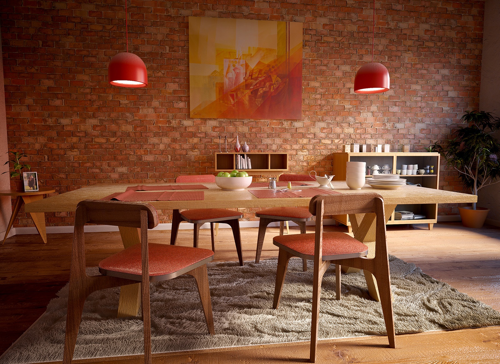

Image courtesy of Spencer Fitch

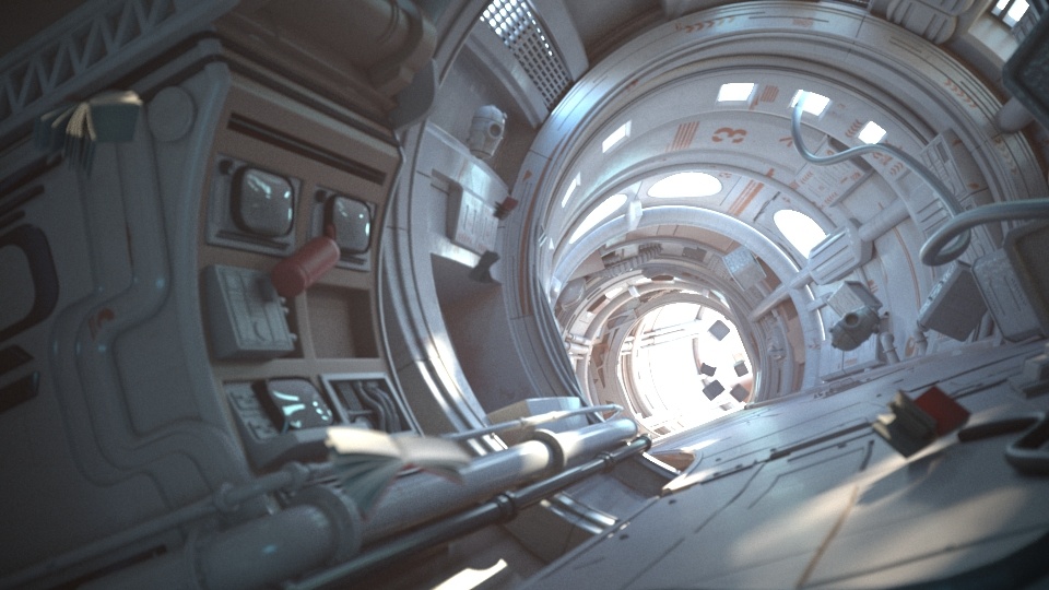

Example: Comparisons of Different GI Methods

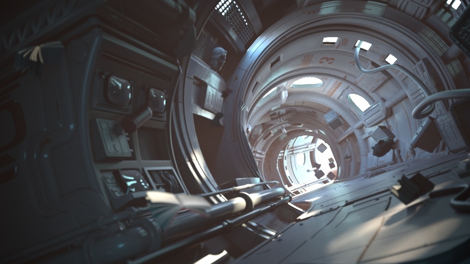

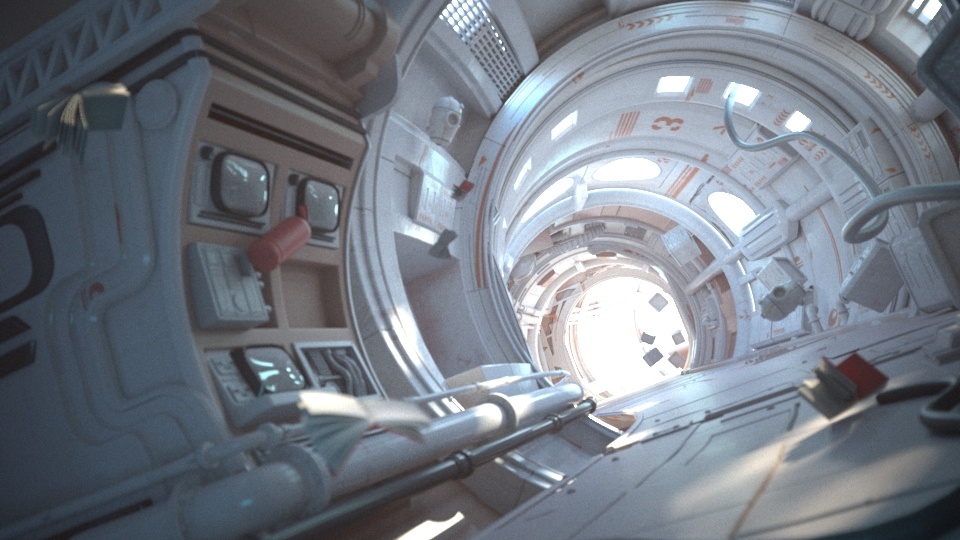

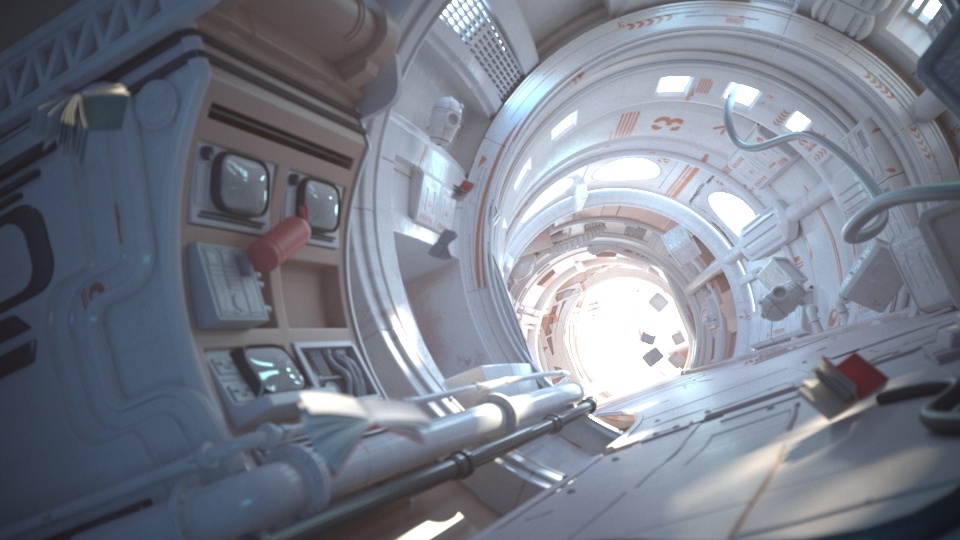

These examples show the effect of the different secondary engines. Note that by default Brute Force has 3 light bounces and Light Cache works with 100 light bounces. All the examples are set to their default values.
GI is disabled
GI is set to Brute Force/None
GI is set to Brute Force/Brute Force
GI is set to Brute Force/Light Cache
