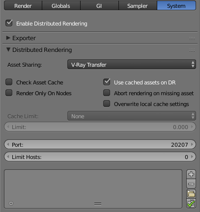

Enable the Distributed Rendering option to activate the Distributing Rendering rollout.
Asset Sharing – In order to proceed with DR all machines need to have access to all scene assets. This button allows you to specify how those assets are shared among the render nodes.
 V-Ray Transfer – Allows render servers to automatically download missing rendering assets from the client machine. This includes textures, V-Ray proxy files, IES profiles, GI solution caches (irradiance map, light cache), X-Ref scenes etc.
Absolute Paths – Load all assets using absolute paths.
Shared Directory – Specifies the location of a shared location, containing all the assets.
Check Asset Cache - When enabled V-Ray checks cashed assets before trying to transfer any assets.
Render Only On Nodes – When disabled, the client machine (the one from which the user initiates the DR render) also takes part in the rendering calculations. When enabled, the client machine only organizes the DR process, sends rendering tasks to the render servers and displays the final result.
Use cached assets – When enabled, the render servers keep the downloaded rendering assets between different DR sessions. When disabled, render assets are automatically deleted once the render server disconnects from the client machine at the end of the rendering. When enabled, assets are kept in a folder on disk. By default it is named vray_assets_cache located in the temporary folder for the user that runs the V-Ray DR spawner. The location of the assets cache can be modified with the environment variable VRAY_ASSETS_CACHE_PATH. Modified assets are generally detected and re-transferred to the render servers even though they may already exist in the render servers' caches.
Abort On Missing Assets – When enabled the rendering is aborted if one of the render nodes doesn't have access to the scene assets.
Cache limit  Allows you to specify under what conditions the assets cache is cleaned up. The possible values are:
 None – Assets are never deleted from the render servers' cache.
Age (hours) – Assets are kept for the specified amount of time. At the end of the rendering, the render servers delete assets that have been transferred before the specified time limit.
 Size (GB) - When the size of the assets on a render server exceeds the specified amount, least recently used assets are automatically deleted at the end of each render until the folder size is less than the limit.
Limit – Specifies the value for the limit of the asset cache. This is either hours or GB, depending on the selection of Cache limit type.
Port – Allows you to manually specify the port at which to run distributed rendering.
