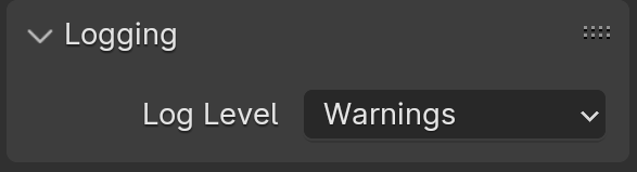

Logging
Log Level Determines which messages, if any, are going to be displayed in the Output Window.
