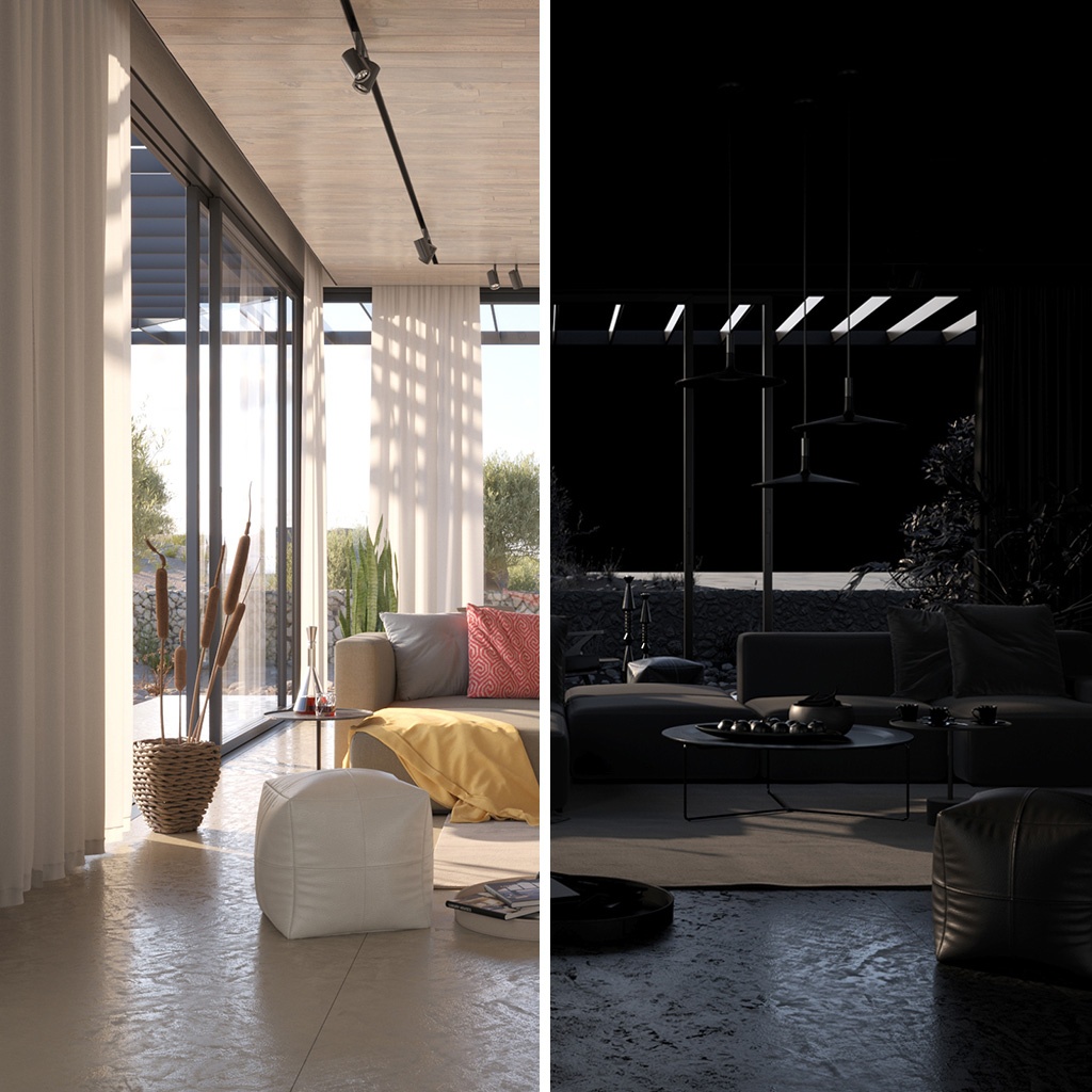

The Specular Render Channel is an image that stores specular reflection (basically put, highlight) information calculated from the material's reflection value in the scene. Specular reflection is defined as the reflection of light from a surface in a single particular reflection, as opposed to a diffuse reflection, which is reflected at many angles.
The brighter the area, the more highlighted reflection the object exhibits in the render. If the Reflection Color parameter of a material is colored, the Specular highlights will be colored.

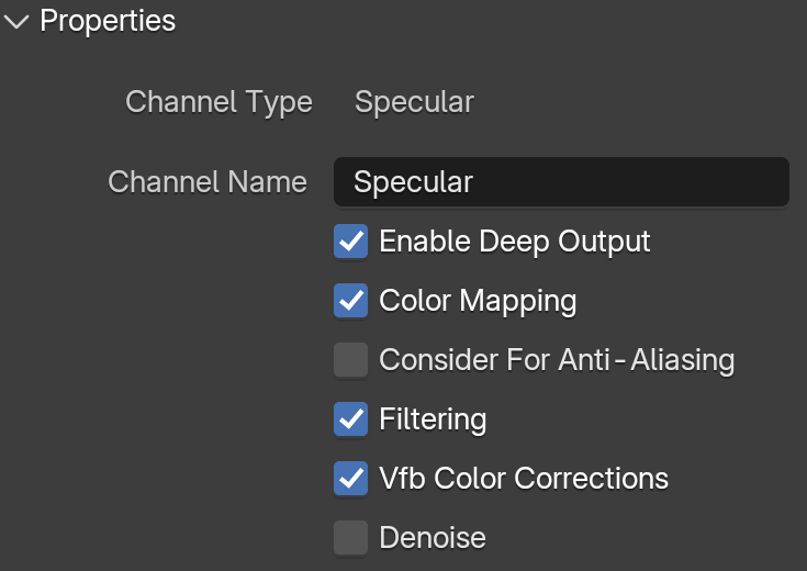

Properties
See the Render Channels page to find out where you can find these properties.
Enable Deep Output  Specifies whether to include this render channel in deep images.
Color Mapping –
Consider For Anti-aliasing – When enabled, anti-aliasing is used where possible.
Filtering –  Applies an image filter to this channel.
Denoise – Enables the render element's denoising, provided the Denoiser is enabled.

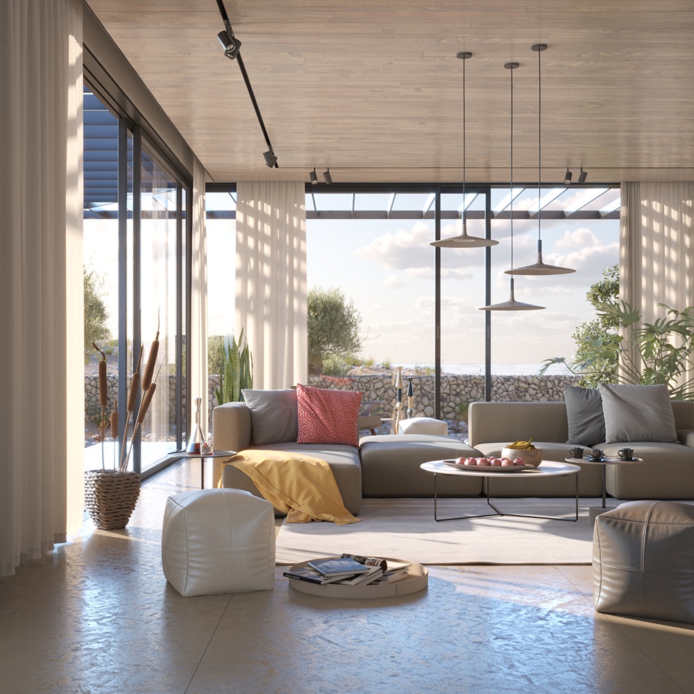

The Specular render channel is useful for changing the final image's specular appearance during compositing. In the example, the specular reflections are brightened and tinted with a cooler color. See the render before and after compositing.
Before
After
