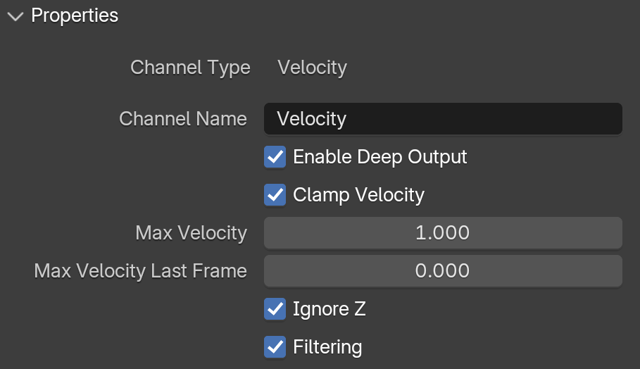

Enable Deep Output  Specifies whether to include this render channel in deep images.
Clamp Velocity  Sets the limit for Max Velocity. When enabled, this option limits the max velocity value to 1 for floating point images, 255 for 8-bit images, or 65535 for 16-bit images. This option is useful only when writing to an 8-bit or 16-bit file format.
Max Velocity  Used to scale the velocity values written to the render channel so that they fit within the range specified by the Clamp Velocity parameter. This is only useful if writing to an 8-bit or 16-bit file format.
Max Velocity Last Frame  Shows the maximum velocity value that was found while rendering the last image. This is a read-only parameter and can be used as a guide for setting the Max Velocity parameter.
Ignore Z  Disregards motion along the Z axis.
Filtering –  Applies the image filter to this channel.

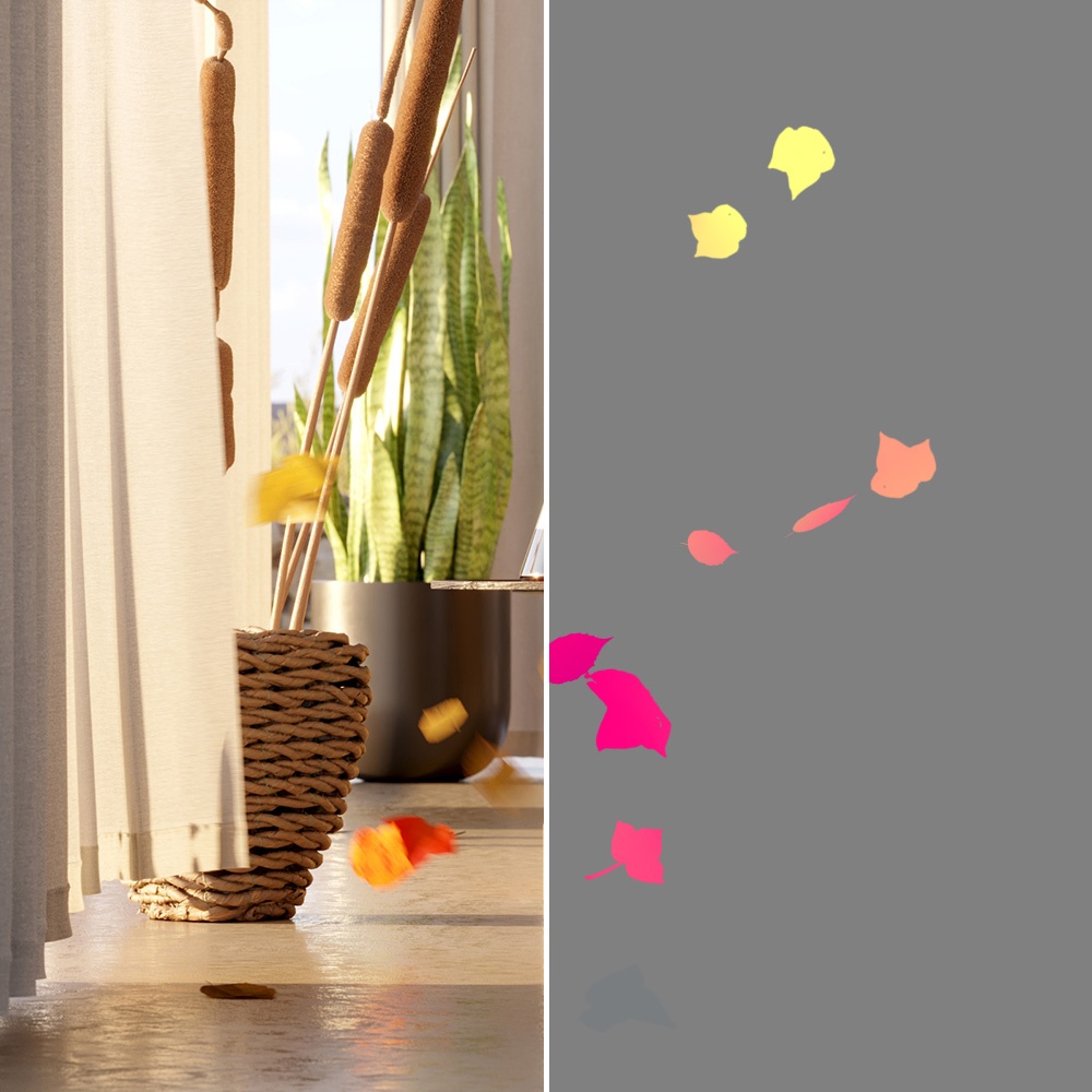

The Velocity render channel is useful for adding motion blur in post-production at a composite level, without the need for rendering. See the render before and after compositing.
Before
After
