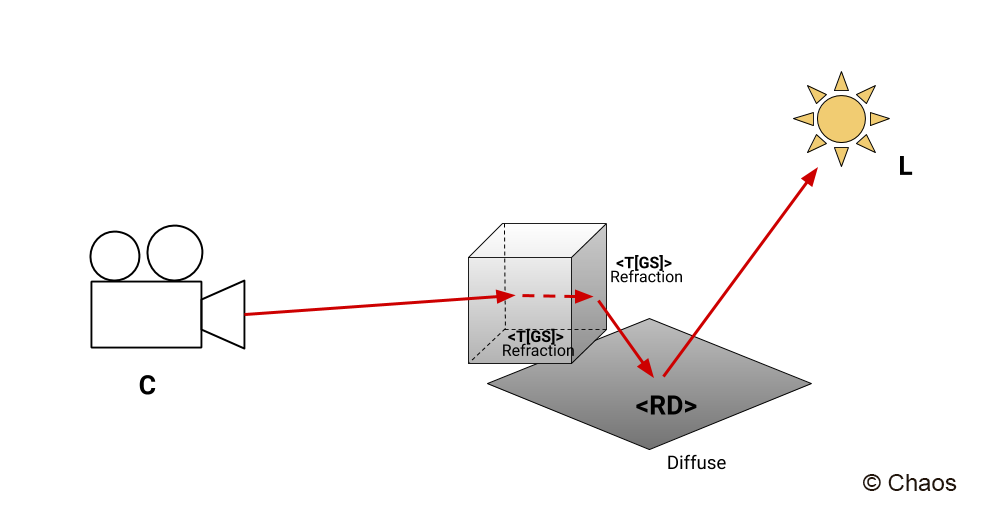

Previously, we looked at C<T[GS]><RD>L to capture diffuse reflection behind refraction. This will work behind a single refractive pane, as we only ask for a single refractive hit with <T[GS]> that is either Glossy or Singular.
If the refractive object is (for example) a cube, then the ray needs to enter and exit the cube, hitting the refractive surface twice before reaching the diffuse surface behind.
In this case, we need to ask for two refraction hits C<T[GS]><T[GS]><RD>L. If there's no risk of capturing other random refraction hits, we can use <T[GS]>+ to ask for 1 or more repetitions of <T[GS]>
C<T[GS]><T[GS]><RD>L captures the diffuse surface behind exactly 2 panes of refractive surfaces.
C<T[GS]>+<RD>L captures the diffuse surface behind 1 or more refractive hits.
