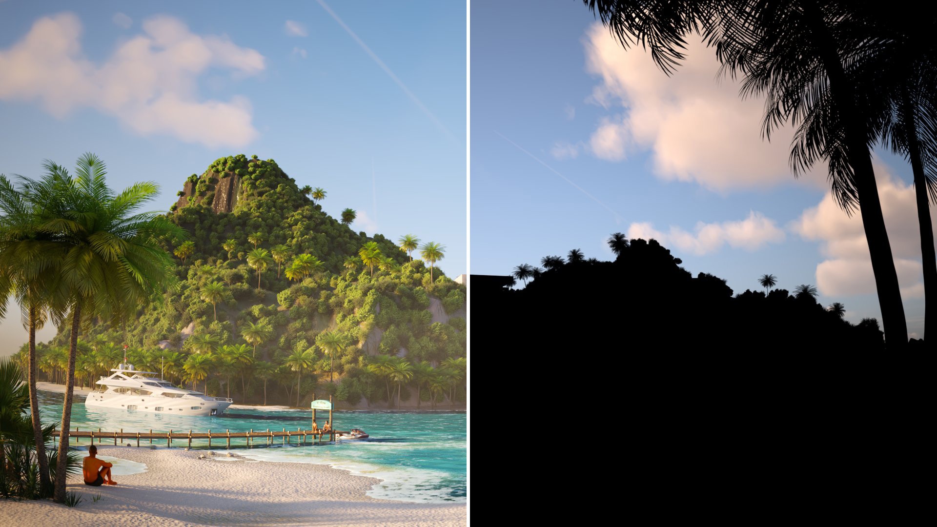

The Background Render Element stores an image of the texture used in the background behind geometry in a scene, as seen from the camera. Geometry that blocks the background image renders as black.

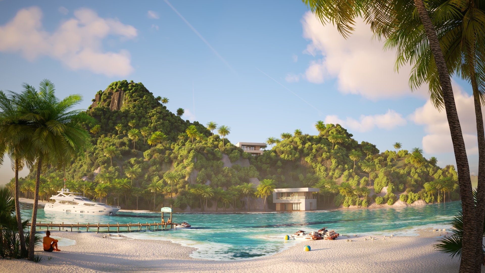

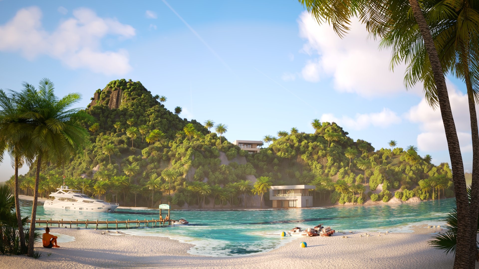

Example: Enhancing the Background
In this example, the background is brightened using the Background Render Element.
Before
After
