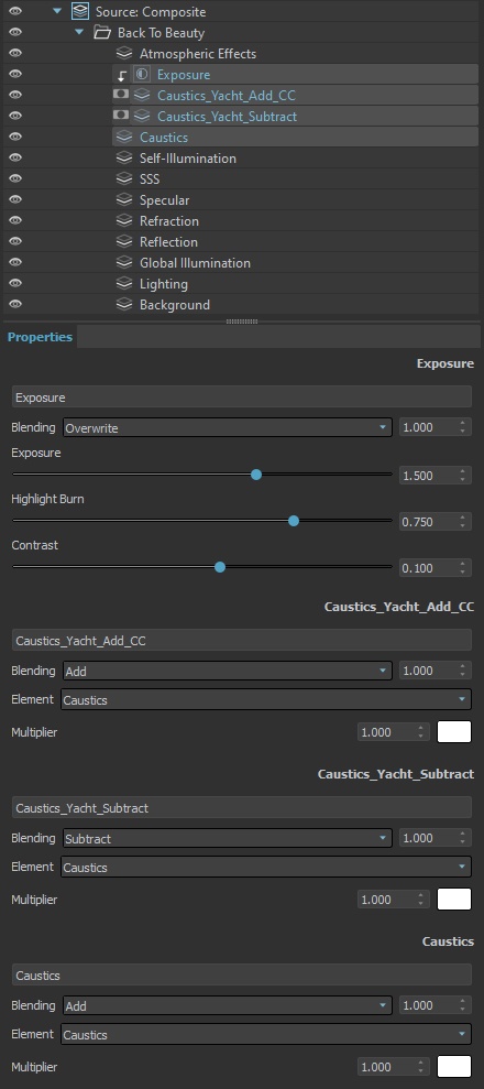

Example: Enhance Caustics
In this example, the caustic reflections on the yacht are enhanced after rendering using the Caustics Render Element. The yacht is selected using a Cryptomatte mask, and the Caustics effect is first subtracted from that object and then added back enhanced. This achieves greater fine-tuning of the caustic effect.
