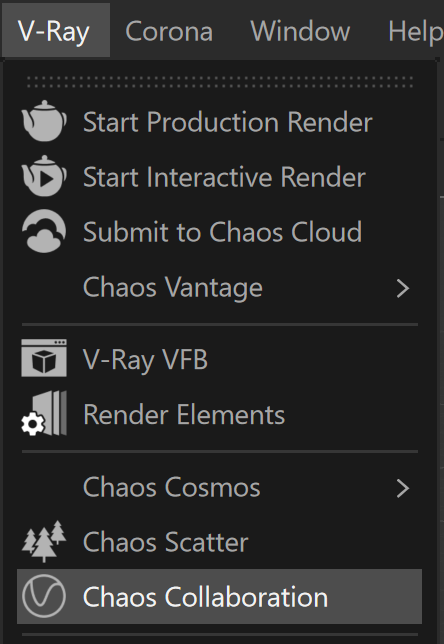

||V-Ray menu|| > Chaos Collaboration

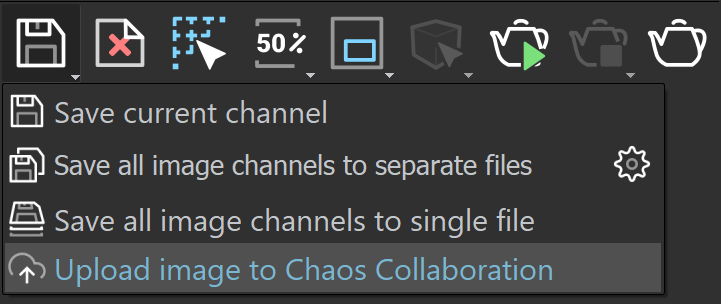

||VFB|| > Save current channel > Upload image to Chaos Collaboration

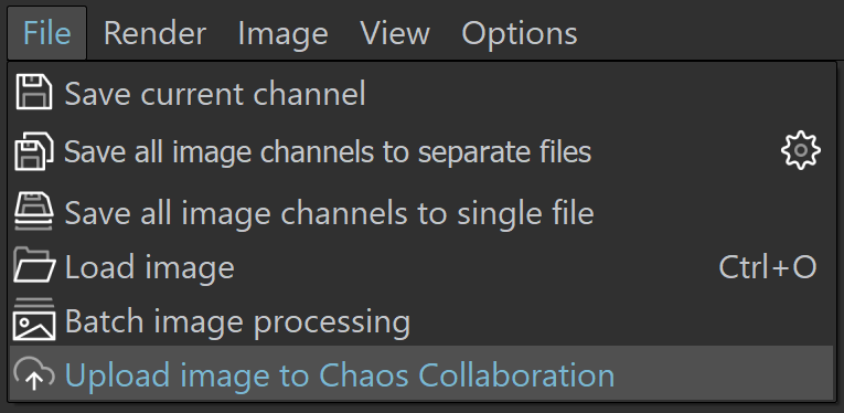

||VFB|| > File > Upload image to Chaos Collaboration

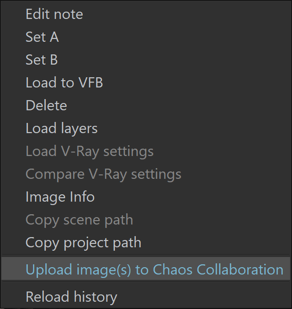

||VFB|| > Render History > (Right-click on any previously saved image) > Upload image(s) to Chaos Collaboration

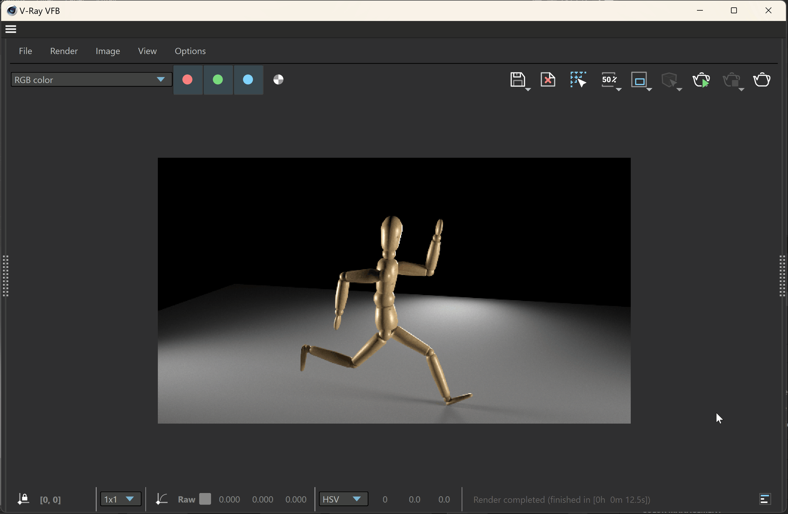

  • Render your scene in the V-Ray Frame Buffer.
  • Open the Chaos Collaboration window. You can open it from the VFB, or from the V-Ray menu.

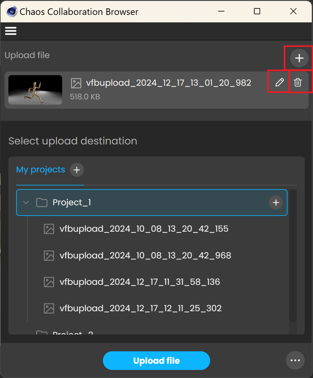

  • Click anywhere in the window to upload to Chaos Cloud.
  • Select upload destination. A default project folder and project name are assigned, but you can customize them at this step. You can also add additional images for upload from the button.

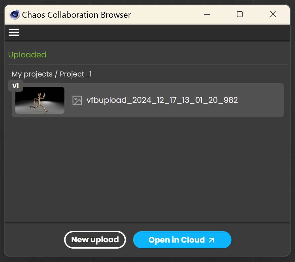

  • When the render(s) are uploaded, you can choose to continue uploading or to view your renders in Chaos Cloud.

The Collaboration tab has several sections: Upload files containing a list of images for upload, Recent containing recent projects, and Browse with locations where the images are uploaded.
 – Deletes the current image from the upload list.
 – In the Upload files, uploads the current image in the VFB to Chaos Cloud Collaboration. In Browse, creates a new project or folder.
 – Renames the Upload file.
Upload file – Uploads the image(s) to Chaos Cloud Collaboration in the selected project or folder.
It is also possible to directly drag the images from the Explorer to the Collaboration tab.
After Upload
New upload – Clears the Collaboration tab and prepares it for the new upload of images.
Open in Cloud – Opens the uploaded images in the Chaos Cloud Browser.
