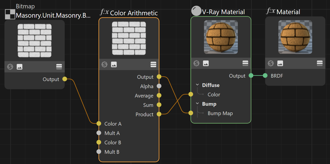

For the example here, a Bitmap node is attached to Color A and Color B is set to a light orange color. The Mode is set to Result A, and this Output is connected to the Bump slot of the V-Ray Material node, which means that it is taking the original bitmap to use as a bump map. The Product of the two Color slots is connected to the Diffuse of the V-Ray Material, resulting in an orange-tinted brick map.

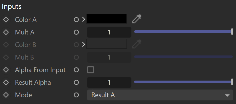

Inputs
Color A – Specifies the first color/texture.
Mult A – A multiplier for Color A.
Color B – Specifies the second color/texture.
Mult BA multiplier for Color B.
Alpha from Input – When enabled, the alpha value is derived from the Color A shader. In case the Mode is set to Result B, the alpha is derived from the Color B shader.
Result Alpha – Determines a value that overrides the alpha value in the output.
Mode – Specifies the calculation method for the two colors/textures. The selected mode determines the data being output from the Output slot. Additional output slots include Average, Sum, and Product, which output the data produced by the respective mode. Alpha outputs the alpha value from the node.
