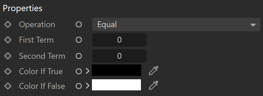

Properties
Operation – Specifies a condition, according to which the two float values are compared.
Equal
Not Equal
Greater Than
Greater or Equal
Less Than
Less or Equal
First Term – The first number to compare. A User Integer node can be connected here as well.
Second Term – The second number to compare. A User Integer node can be connected here as well.
Color If True – Specifies a color that is applied if the Operation is fulfilled.
Color If False – Specifies a color that is applied if the Operation fails.
