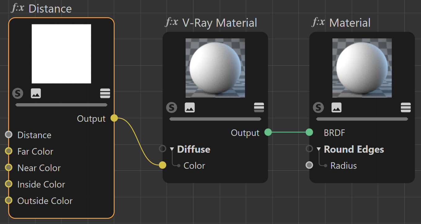

This page provides information about the Distance node in V-Ray for Cinema 4D.
The Distance node returns a different color based on a point's distance to objects specified in a selection list.

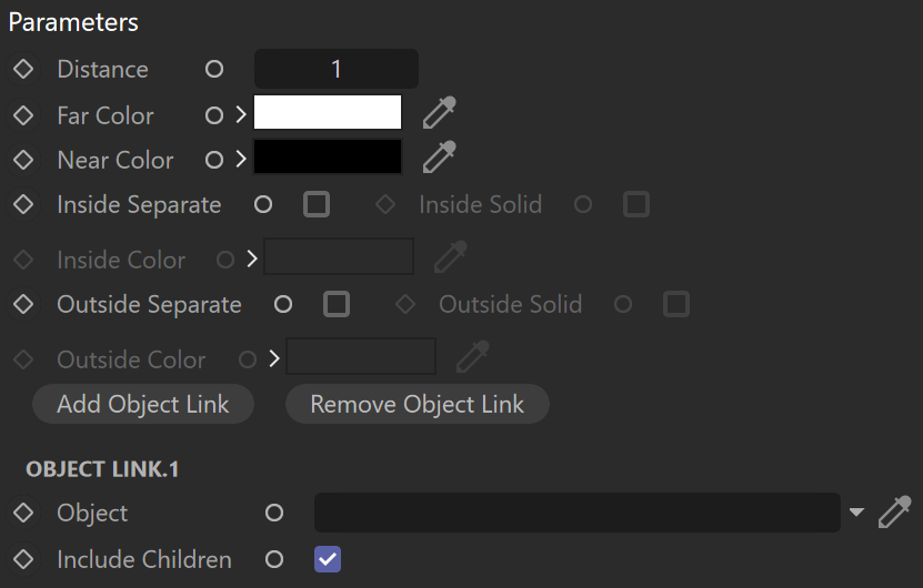

Distance – Specifies a radius, outside which all points are given the Far Color.
Far Color – Specifies the color returned by the texture for points that are at a distance greater than the radius parameter from the objects specified in the list.
Near Color – Specifies the color returned by the texture for points that are right at the edges of the objects specified in the list. For points that are outside or inside the objects but not exactly next to the them, the color is determined by blending between the Near Color and the Far Color and the Distance serves as a falloff radius.
Inside Separate – When enabled, the Near Color value is overridden by the Inside Color value for points that are inside the specified geometry.
Inside Solid – When enabled, all the points inside the specified geometry are given the Inside Color value and no blending is performed.
Inside Color – Specifies the color returned by the texture for points that are right inside the objects specified in the list. For points that are inside the objects but not exactly next to them, the color is determined by blending between the Inside Color and the Far Color and the Distance serves as a falloff radius.
Outside Separate – When enabled, the Near Color value is overridden by the Outside Color value for points that are outside the specified geometry.
Outside Solid – When enabled, all the points outside the specified geometry are given the Outside Color value and no blending is performed.
Outside Color – Specifies the color returned by the texture for points that are outside the objects specified in the list.
Add Object Link – Creates an additional slot for an Object, to which V-Ray Distance Node is applied.
Remove Object Link – Removes the selected Object Link.
Object – Specifies a set of objects to be considered when calculating the colors for each point in the texture.
Include Children – When enabled, any objects that are children of a linked Object are included as well.
