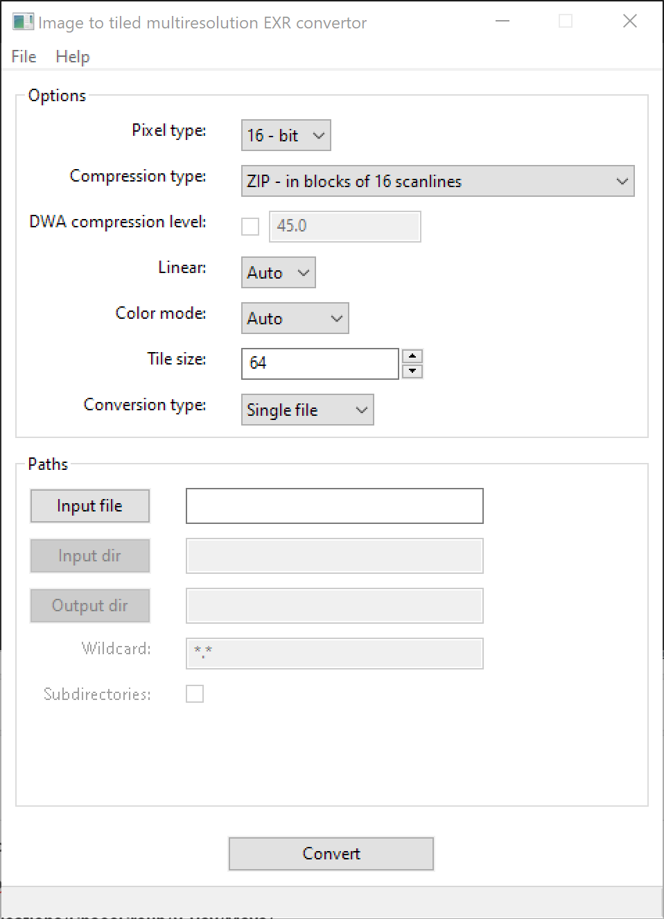

Running img2tiledexr without any parameters or from the Start menu opens the GUI version of the tool, as seen in the Overview section. The GUI allows you to convert one or a number of image files to tiled multiresolution OpenEXR files.
Pixel type Specifies whether the data in the .exr file is saved as 16-bit or 32-bit floating point numbers.
Compression type – Sets the compression type, choosing between the several available methods. If not specified, the ZIP method is used.
  • None
  • RLE - run length encoding
  • ZIPS - one scanline at a time
  • ZIP - in blocks of 16 scanlines
  • PIZ - piz-based wavelet compression
  • PXR24 - lossy 24-bit float compression
  • B44 - lossy 4x4 pixel compression, fixed rate
  • B44A - lossy 4x4 pixel compression
  • DWAA - lossy DCT-based, blocks of 32 scanlines
  • DWAB - lossy DCT-based, blocks of 256 scanlines
DWA compression level A floating-point value that controls the compression level when using the lossy DWA compression methods.
Linear Specifies if the input image should be converted from sRGB to linear color space when saved into the tiled OpenEXR file. Possible values are: off (no conversion), on (convert colors from sRGB to linear space), and auto (convert all images except  .hdr  and  .exr  files).
Color Mode – Specifies whether to create a color EXR file (with RGB channels) or a grayscale EXR file (with Y channel). When set to Auto, the image can be checked if it actually contains alpha and/or color data, and the output channels can be optimized, writing only the needed channels.
Tile size – Sets the dimensions of a squared tile.
Conversion type Selects the type of conversion to be performed.
  • Single file – Only a single file is converted.
  • Multiple files – Multiple files are converted at once.
Input file – Specifies the image file when Single file is selected as the Conversion type.
Input dir – Specifies the input files' directory when Multiple files is selected as the Conversion type.
Output dir – Specifies the output directory for the tiled .exr files when Multiple files is selected as the Conversion type.
Wildcard – Specifies a search pattern for the input file names. Wildcards (*) can be used to define the pattern.
Subdirectories – When this option is enabled, all image files contained in subdirectories of the specified input directory are also converted.
Convert Starts the conversion.
