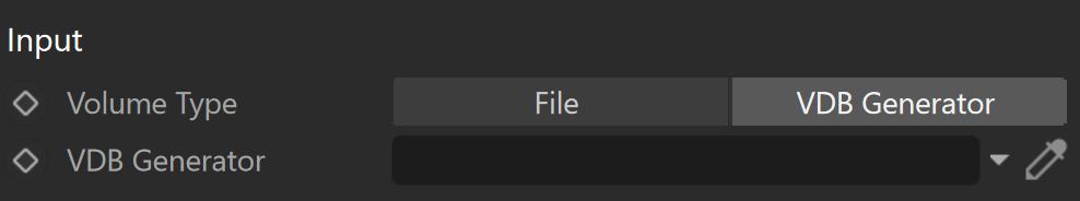

VDB Generator – Links a Pyro Output object to the Volume Grid. Drag and drop onto the field, or use the eyedropper tool. V-Ray recognizes it is a Pyro object, and a window pops up asking if you would like to use the Pyro preset. Click on Yes.
After linking the object, use the c4d2024_dropdownArrow.png button to expand the Pyro's parameters, and you can further edit them there or directly inside the Pyro Output and the Pyro tag. Changes are reflected everywhere. The Pyro Output object needs to be located in the current scene. NOTE: For the best results, when using the VDB Generator Volume Type, we recommend the Volume Grid's Render Mode be set to Volumetric

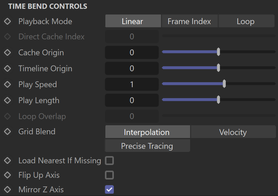

Time Bend Controls
The following parameters contain playback options for retiming a cached sequence. Using these, you can speed up, slow down, or animate the motion of the sequence. When retiming, additional RAM may be used, and loading a new timeline frame may take longer when the frame must be obtained by creating a new one between two adjacent cache files. We will refer to the process of creating an intermediate frame from two caches as Blending
Playback Mode – Chooses between different options for animation control:
Linear – This is the default mode. The cached sequence is played with a constant speed and can be offset forward or backward on the timeline, as well as sped up or slowed down.
Cache Index – The Direct Cache Index specifies which cache file will be loaded for the current timeline frame. Can be used to either show a static simulation, or the Direct Cache Index can be animated in case you want varying play speed, including playing the simulation in reverse.
Loop – A specified piece of the simulated sequence is looped. Can be used for flowing and repeated effects such as fireplaces, campfires or torch fires, water in fountains, waterfalls, or boiling liquid. In this mode, the Cache Origin parameter specifies the beginning of the looped sequence, the Length parameter specifies the length of the loop, and Loop Overlap specifies the number of overlapped frames that ensure a smooth transition between the end and the start of the loop. Note that you need to have simulated at least Cache Origin Length + Loop Overlap cached frames for this mode to work correctly.
Direct Cache Index – Used in Cache Index mode and specifies the cache file index for the current timeline frame. This can be animated in order to achieve more interesting time-bend effects.
Cache Origin – An offset specifying which cache file from the sequence is placed on the timeline at frame Timeline Origin.
Timeline Origin – An offset specifying which timeline frame the starting cache is placed on.
Play Speed – A multiplier for the playback speed. A value of 1 means that each timeline frame corresponds exactly to one cache file index. If the Play Speed is not exactly 1.0, frames are blended using the method specified by the Blend Method parameter. Note that Play Speed is not keyable - you should switch to Cache Index mode and animate the Direct Cache Index if you want to animate.
Play Length – The duration in timeline frames. In Linear mode, when this parameter is larger than 0, the sequence length is limited to its value. In Loop mode, this parameter shows the loop length.
Loop Overlap – In Loop mode, this option specifies the number of timeline frames after the loop's end that are blended with the loop's beginning to create a smooth transition. Remember that the end transition frames are not in front of the sequence end but after it. For example, if the loop starts at frame 35 and has a Play Length of 20 and a Loop Overlap of 5, the transition frames start at frame 55 and end at frame 59, which means the simulation must be at least 59 frames long. It is recommended that the Loop Overlap value be longer than the average "lifetime" of the simulation elements while involved in highly visible motion.  For example, for a waterfall, the Loop Overlap value should be at least the average time it takes for a water droplet to fall the full distance before being absorbed into the water at the bottom. For a campfire, it should be at least the average time for a particle to rise up and disappear/die. The correct setting of this value is especially important for simulations that contain particles.
Grid Blend – Used when the Play Speed parameter is not exactly 1.0, or the Direct Cache Index for the current timeline frame is fractional, or you have specified a Loop Overlap in Loop mode. In these cases, a single timeline frame must be constructed from two cache files by blending between them. Each time the timeline is scrolled to a new frame, the caches for this frame are blended again. You can choose between three different methods for blending between cache files:
Interpolation – Simple linear interpolation suitable for slow simulations. This is the fastest method, but it does not capture movement well and may produce flickering.
Velocity – Velocity-based interpolation. Produces better results but is also slower. Captures the movement of the fronts of the plumes well but does not work well for smoke moving backward, and also may produce flickering. It requires a velocity channel.
Precise Tracing – Improved Velocity-based interpolation for Fire and Smoke simulations. Captures plume movement very well and can handle very low Play Speeds. Requires a Velocity channel, as well as an Advection Origin channel.
Frame Blending is better suited for simulations without much variety in velocity.
Load Nearest If Missing – If there is no cache file at the required frame, the nearest cache is found and loaded. This is useful for a simulation that ends with a sequence of static frames (for example, still liquid or freezing fire) as it prevents the need to render multiple identical frames after movement has stopped.
Flip Up Axis – When enabled, flips the Y and Z axis of the cached transformation. This is useful when the cache was created with a different up-axis (for example, in 3ds Max).
Mirror Z Axis – When loading cache from a Pyro simulation or cache exported from Maya, enable this option and disable the Flip Up Axis option to load the cache correctly. When both Mirror Z Axis and Flip Up Axis options are enabled, the cache exported from 3ds Max is loaded correctly.

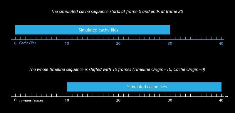

Example: Timeline Origin
The following example demonstrates how the Timeline Origin parameter can be used to specify which frame on the timeline is treated as the first frame when reading the Input Path cache files.
The files go from simulationFrame_000 to simulationFrame_030. When the Timeline Origin is set to 10, they are read as if they were saved as simulationFrame_010 to simulationFrame_040.

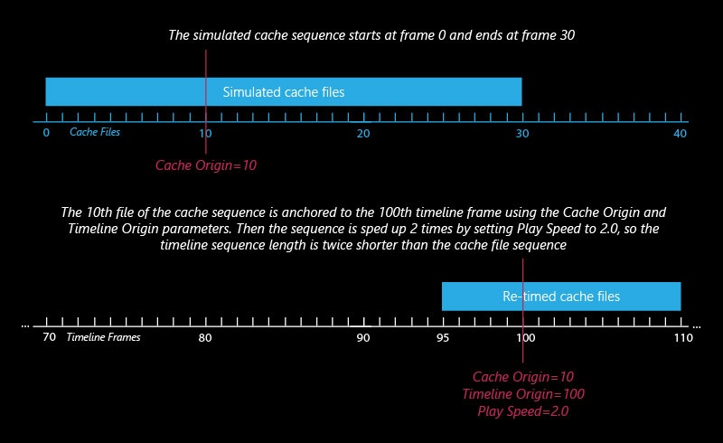

Example: Cache Origin and Play Speed
The following example demonstrates how the Cache Origin and Play Speed options can be used to offset and speed up the input cache files.
The files go from simulationFrame_000 to simulationFrame_030. When the Timeline Origin is set to 100, they are read as if they were saved as simulationFrame_100 to simulationFrame_130.
The Cache Origin parameter is then used to specify which simulationFrame is placed on Timeline Origin = 100. Because Cache Origin is set to 10, the whole sequence is shifted 10 frames back such that simulationFrame_000 is placed at frame 90. Thus, the sequence now goes from frame 90 to frame 120.
The Play Speed is then set to 2.0. Those thirty frames are now reduced to fifteen. The Cache Origin frame is treated as the middle point when shrinking the sequence.

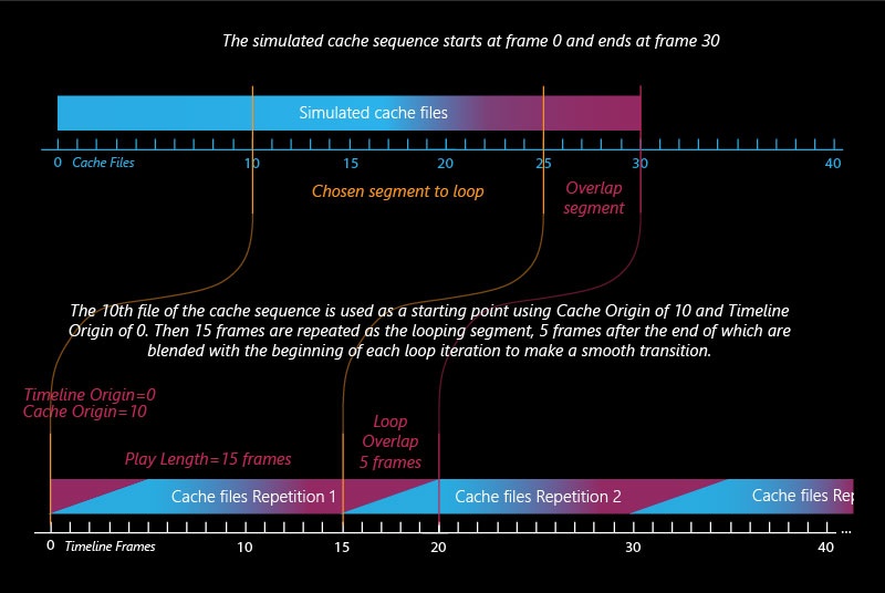

Example: Looping a Simulation
The following example demonstrates how the Input roll-out parameters can be used to loop a simulation.
The Timeline Origin parameter is set to 0 - this will be the first frame of the timeline on which the Input Path files read into the scene by the Simulator will be placed.
The Cache Origin is set to 10, so simulationFrame_010 will be read and placed at Timeline Origin = 0.
The Play Length is set to 15, so the sequence repeats itself every 15 frames when played back (those are actually simulationFrame_010 to simulationFrame_025).
Finally, the Loop Overlap parameter is set to 5 to provide a few extra frames for blending the start and end of the loop together in a smooth transition.
