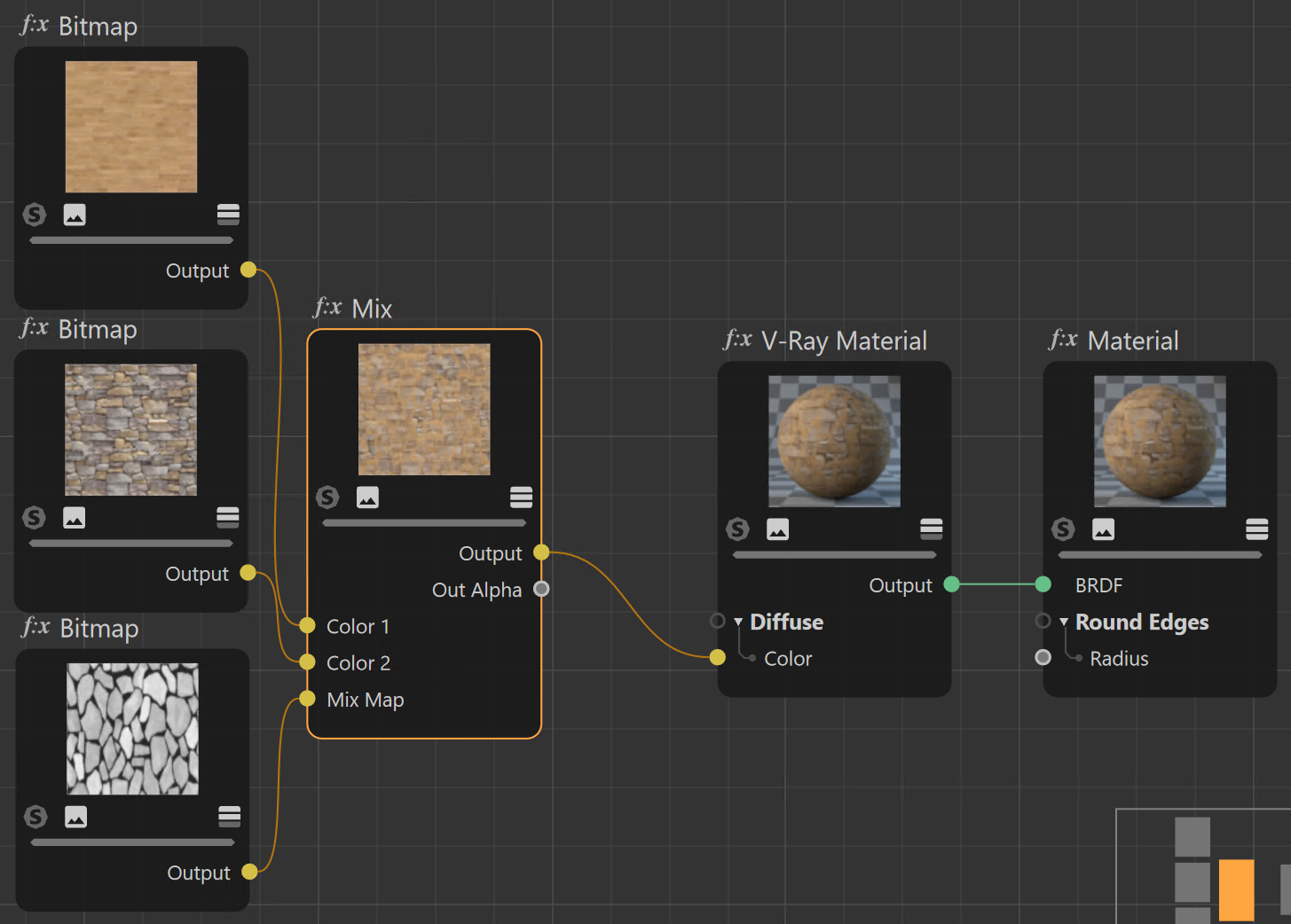

The Mix node is used to blend between two colors or textures. A color or texture can also be used to determine how they are blended.

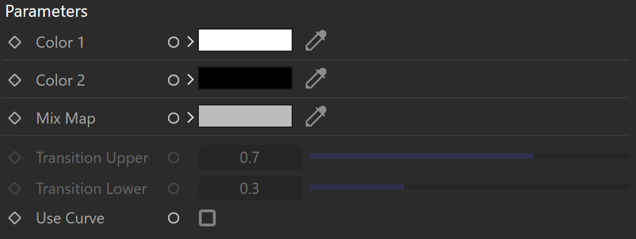

Color 1/ Color 2 – Specifies the first and second color or texture map to be mixed. Additionally, each color can be mixed with its texture, using the Mix Strength parameter.
Mix Amount – Controls how much the two colors/textures mix. The default value of 0.5 mixes them equally. Lower value puts weight on Color 1, while a higher value makes Color 2 more prominent.
Mix Map – A texture map or color that determines how much Color 1 and 2 mix. If a color is used, its Value property serves as a blend amount. If a texture is used, dark areas of the connected texture apply Color 2.
Transition Upper/ Lower – When a curve is used to mix the two colors, the Transition parameters specify upper and lower float limits for the curve.
Use Curve – When enabled, a curve is used to sharpen or smooth the mix between the two colors/textures. This parameter is useful in combination with a Mix Map.
