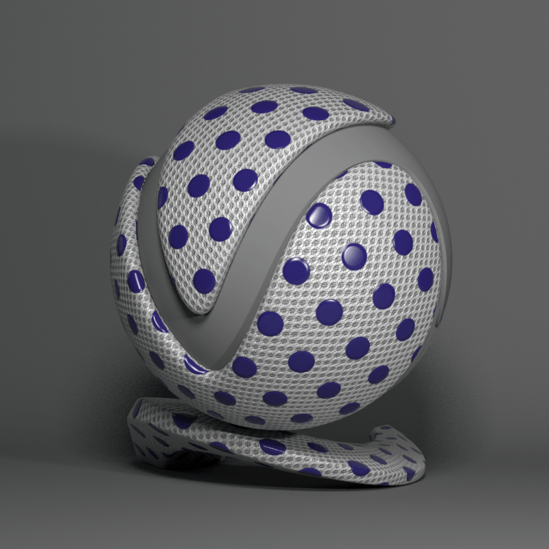

This page provides information about the Ray Switch node texture in V-Ray for Cinema 4D.
The V-Ray Ray Switch node texture gives a material a different color or texture when it is viewed through Shadows, GI, Reflections, and Refractions.

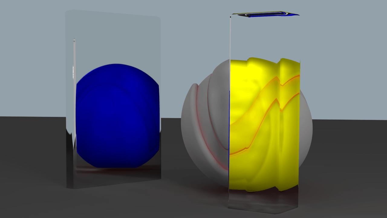

In the example, the Default parameter is set to gray, the Reflections Rays is set to a yellow color, the Refraction Rays is set to a blue color, and the GI Rays texture is set to Red. All other parameters are at default values.

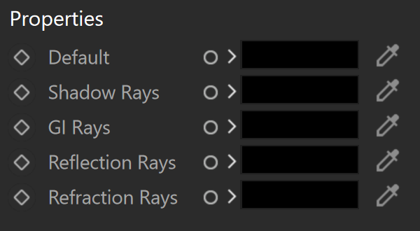

Properties
Default – The color or texture that is seen through the camera.
Shadow Rays – The color or texture used when it's being sampled with shadow rays. (Shadow rays are used to determine whether a point is being illuminated by a light source.)
GI Rays – The color or texture used when it's being sampled with GI rays.
Reflection Rays – The color or texture that's visible in reflections.
Refraction Rays – The color or texture that's visible in refractions.
Common Uses
 The V-Ray Ray Switch texture can be used in many ways. Below are a few examples.

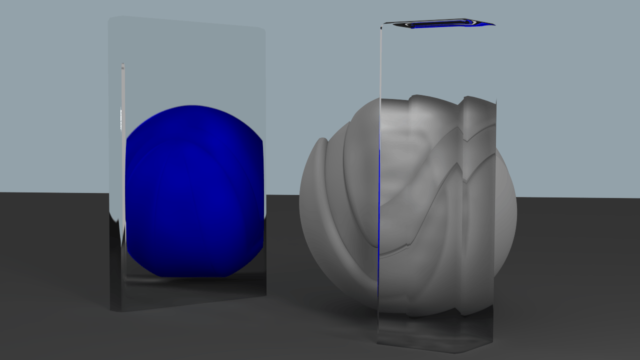

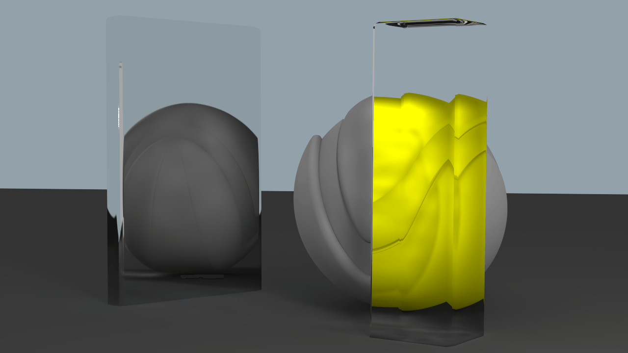

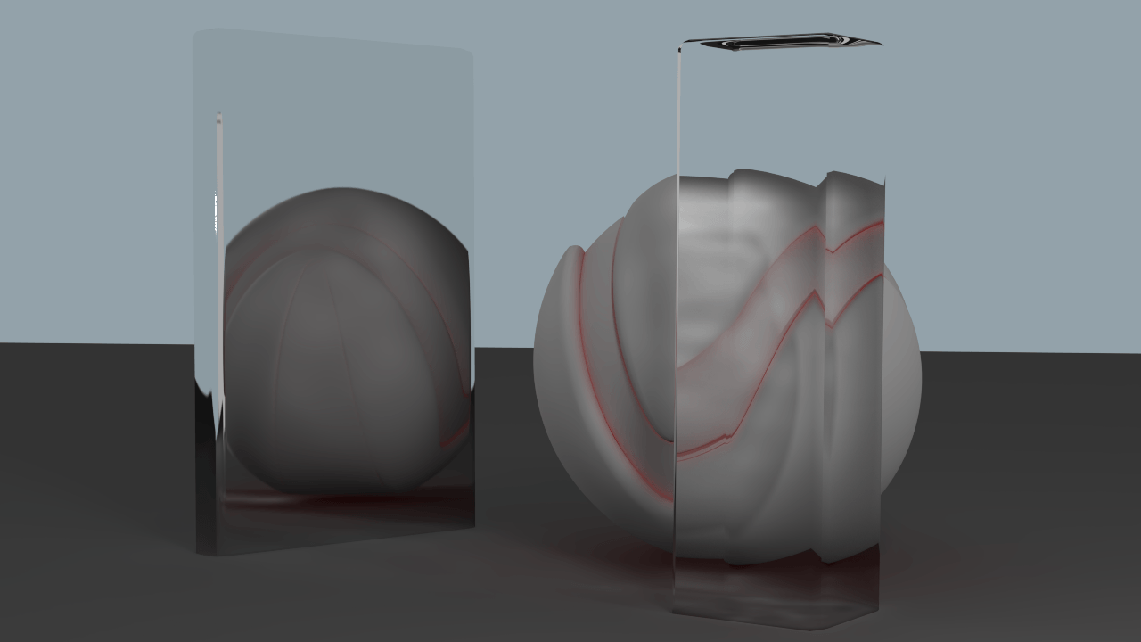

For artistic purposes, you can make the object appear differently in its GI, reflections, or refractions from its diffuse texture.
GI rays texture set to Red
Reflection rays texture set to Blue
Refraction rays texture set to Yellow
