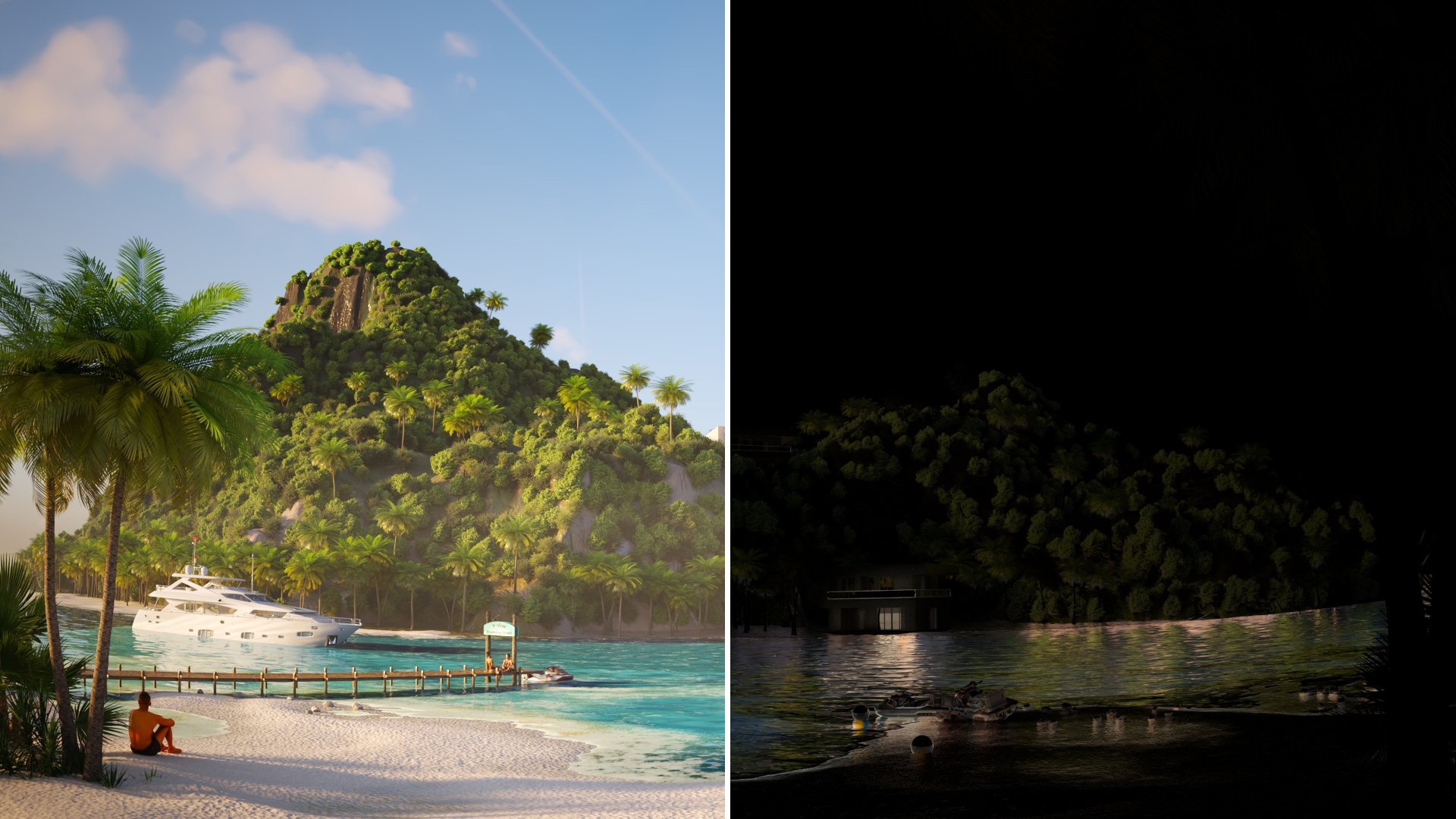

The Reflection Render Element stores reflection information calculated from the materials' reflection values in the scene. Surfaces with no reflection values set in their materials contain no information in the render pass and, therefore, render black.
The Reflection Render Element is formed by multiplying the Raw Reflection Render Element (VRayRawReflection) by the Reflection Filter Render Element (VRayReflectionFilter). So, while the raw reflection pass gives the full reflection of objects reflecting in the scene, the reflection filter sets how much of that reflection should come through in the composite. The two are multiplied together to create the V-Ray Reflection render element, which gives a true representation of the reflection in the scene.
The Reflection Render Element is a key component in the main Beauty Pass. It can be used to enhance the look of reflections. See the example.

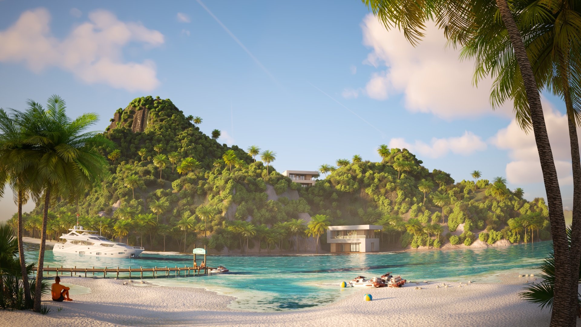

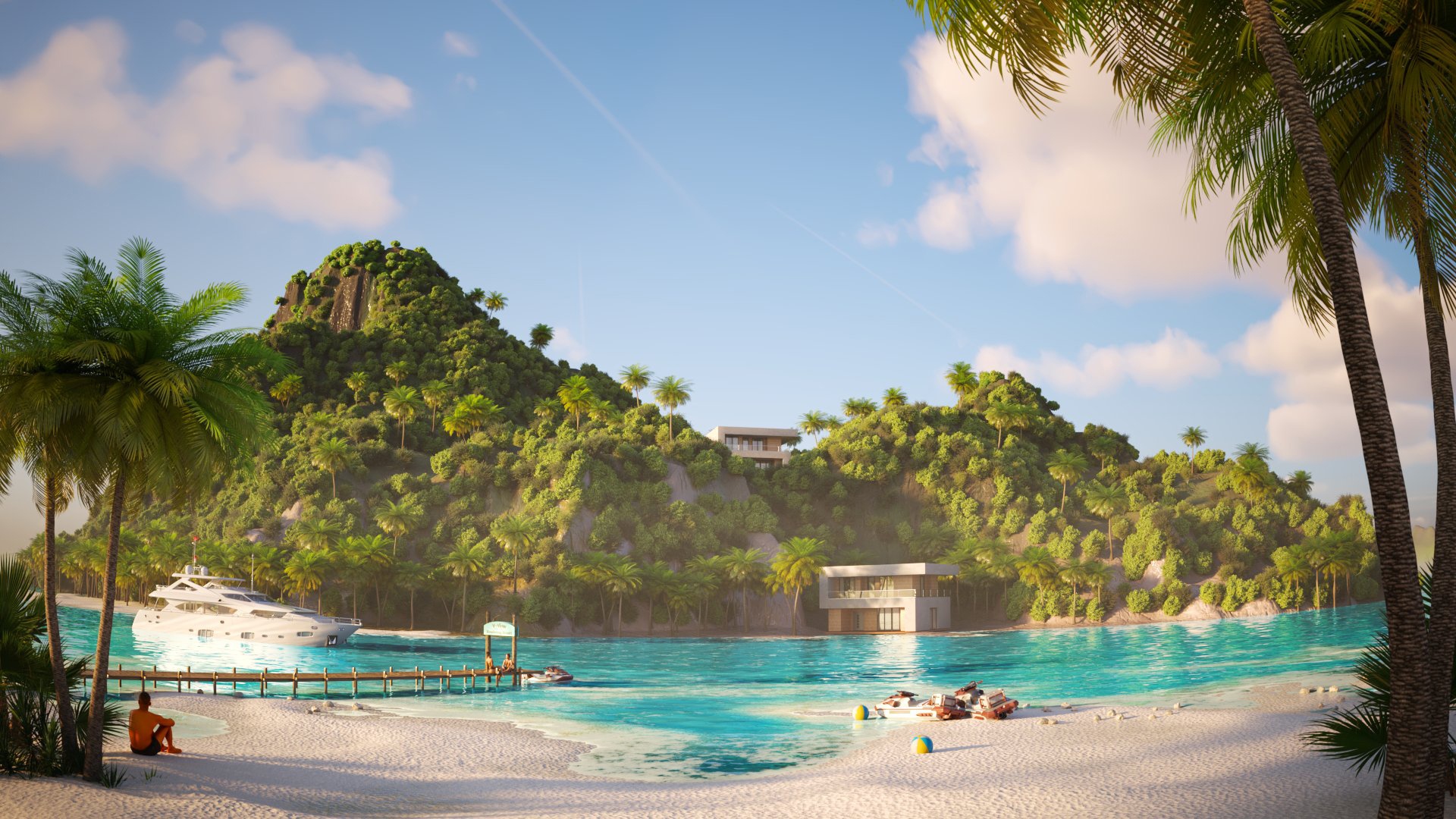

Example: Enhancing Reflections
In this example, the reflections of the water in the sea are enhanced after rendering using the Reflection Render Element. The sea is selected using a Cryptomatte mask, and a tint and increase in brightness are applied to only the reflections of the water.
