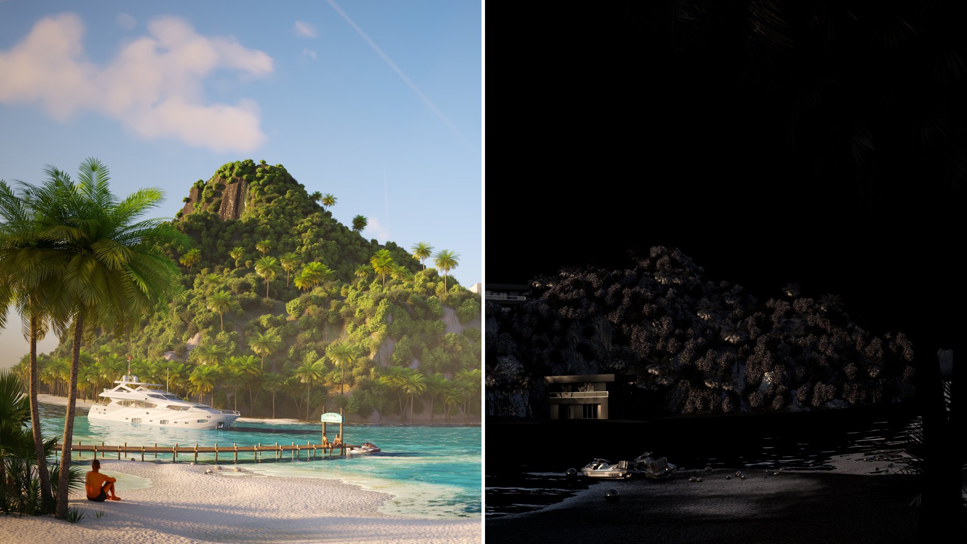

Example: Enhancing Specular Reflections

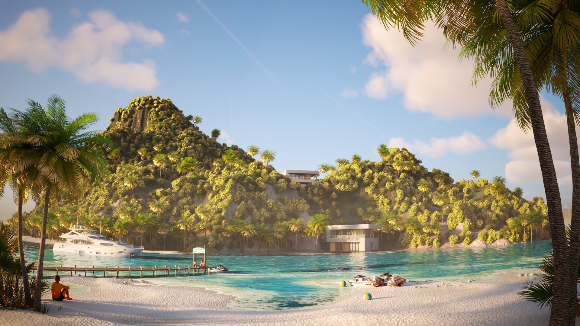

In this example, the specular reflections of the foliage are enhanced after rendering using the Specular Render Element. The greenery is selected using a Cryptomatte mask, and its specular reflections are boosted and tinted.

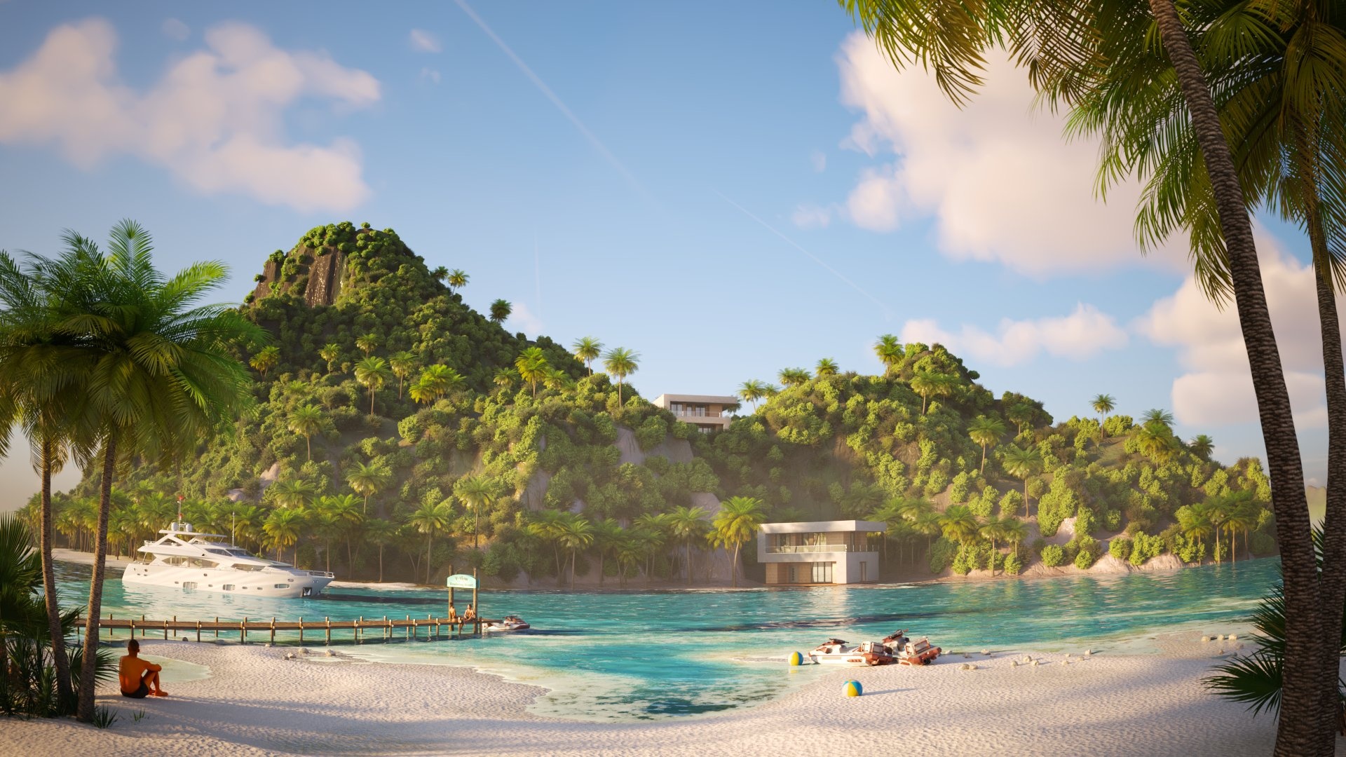

Before
After
