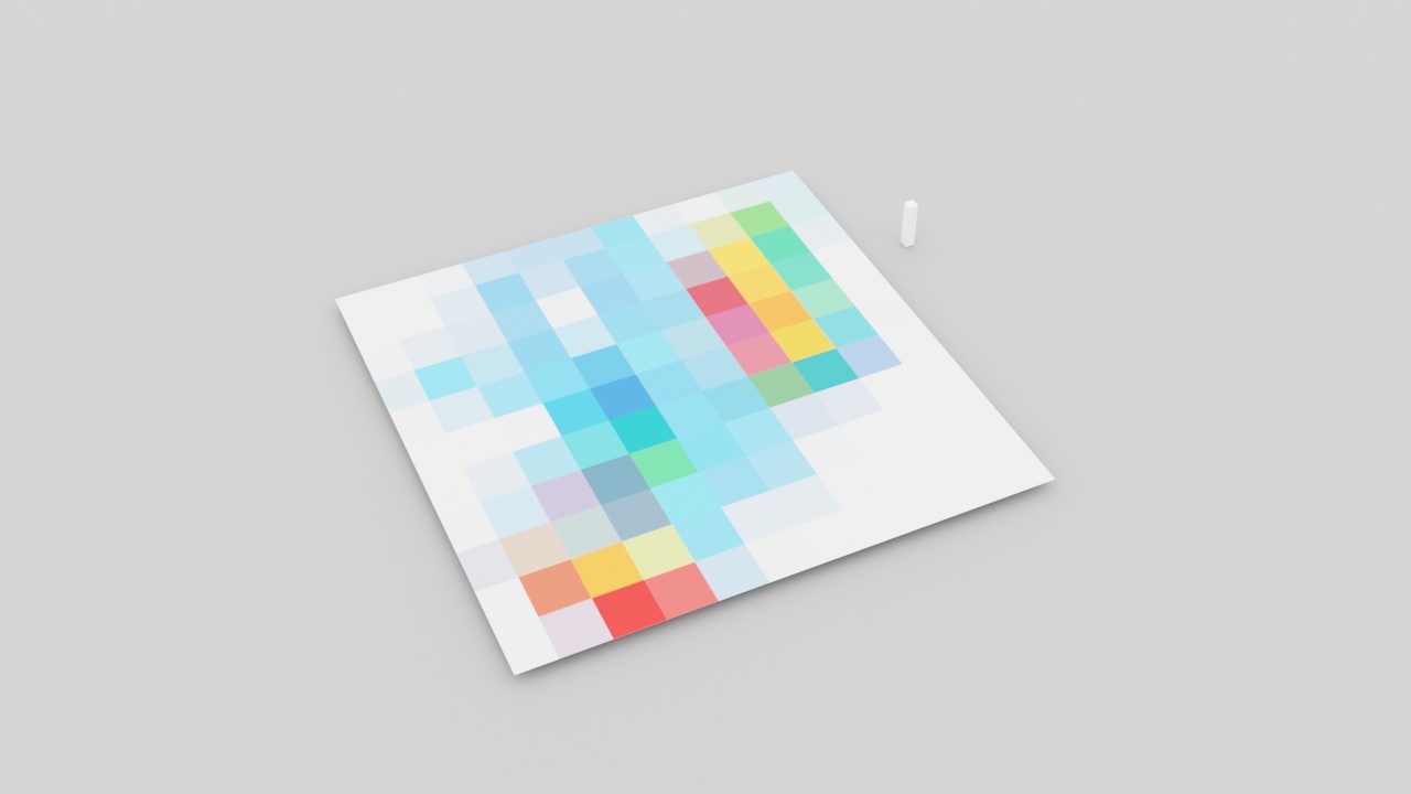

No Instances

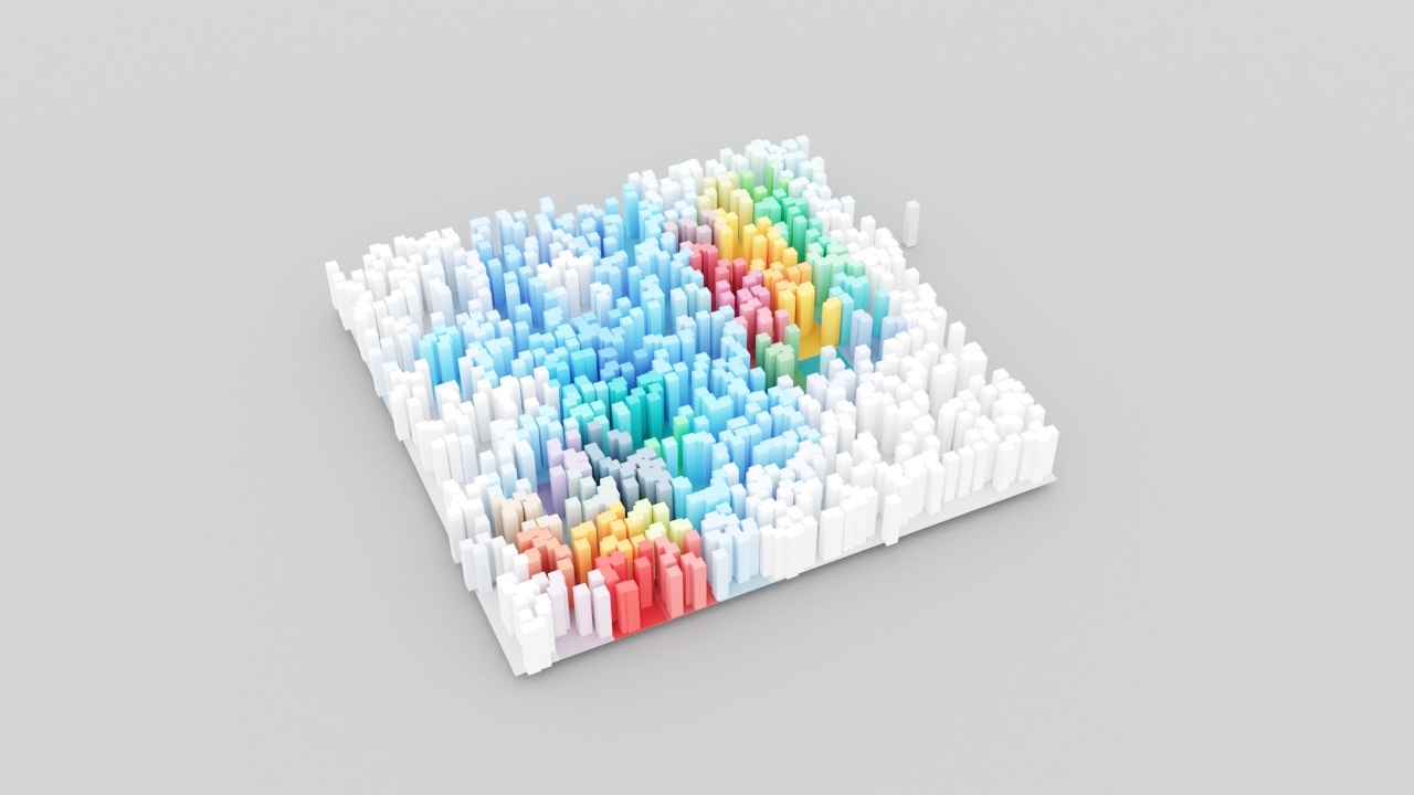

Instances with Surface color
