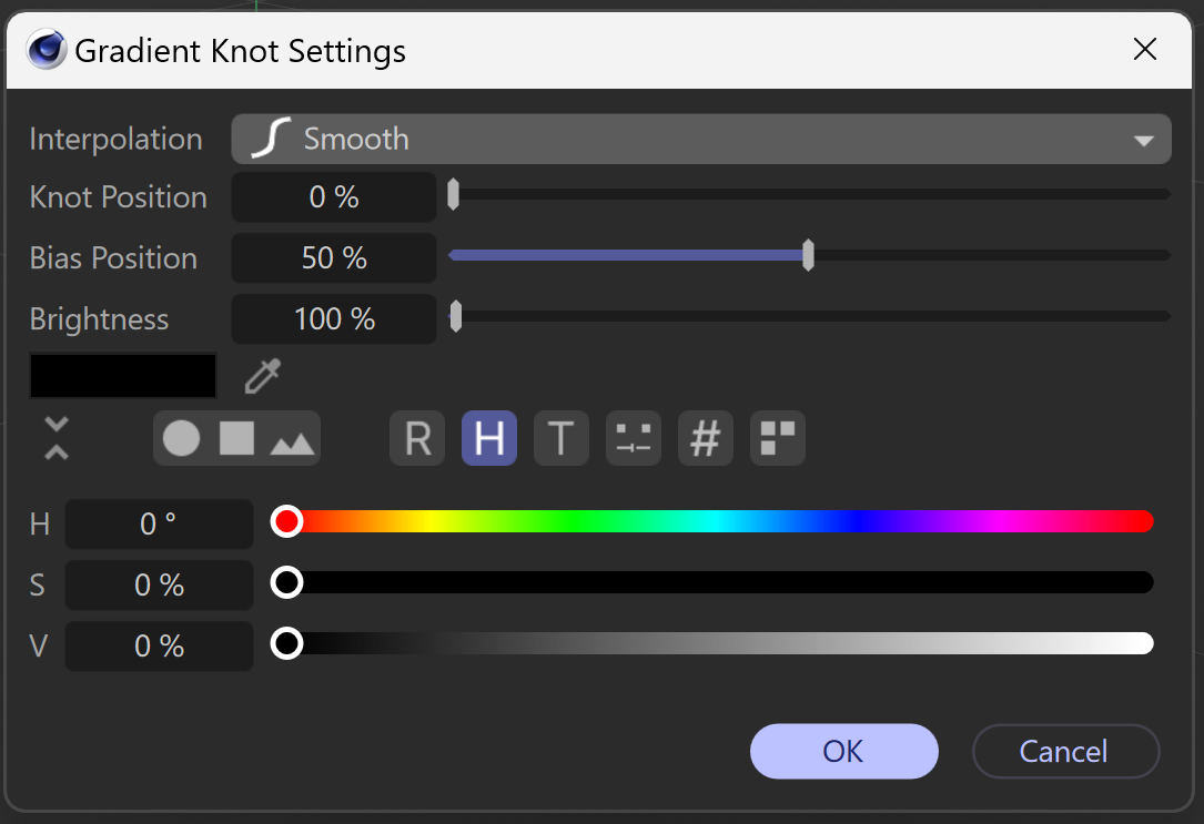

Gradient Knot Settings
To access these settings, double-click on an existing color flag in the gradient ramp. Click OK when you are happy with your edits to go back to the Attributes Editor
Interpolation – Changes the color interpolation method between the control points. Changing the option changes the color transition curve between the control points.
Smooth
Cubic
Cubic Bias
Linear
Step
Blend
Knot Position – The float position of the currently selected control point.
Bias Position – Specifies the position of the blend between the currently selected color and its right counterpart. 50% is perfectly blended in the middle, higher values increase the amount of the current color, and lower values decrease its amount. The rightmost color in the ramp is not affected by this parameter.
Set the color of the current position from the color properties.

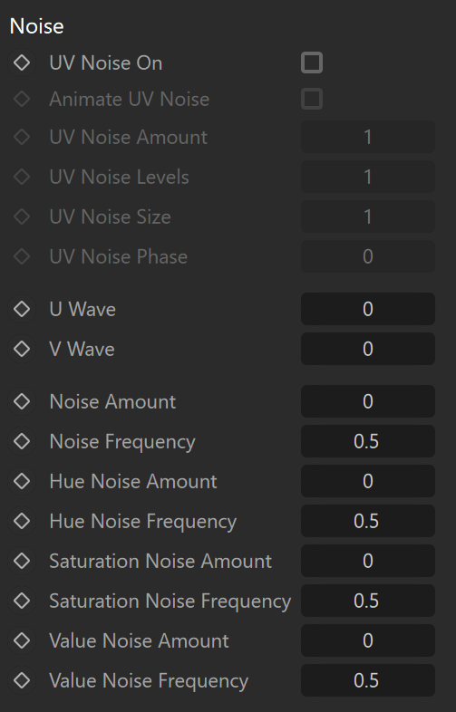

Noise
UV Noise On – Enables noise for the texture.
Animated UV Noise – Enables the noise to be animated.
UV Noise Amount – Specifies the amount of UV noise.
UV Noise Levels – Specifies the amount of noise iterations.
UV Noise Size –  Controls the scale of the noise.
UV Noise Phase – Controls the noise phase.
U Wave/ V Wave – Specifies a sine wave offset in the U/V direction.
Noise AmountSpecifies the amount of noise to add to the texture.
Noise Frequency – Specifies the amount frequency.
Hue Noise Amount – Introduces noise in the hue.
Hue Noise Frequency – Specifies the noise frequency in the hue.
Saturation Noise Amount – Specifies a noise amount for the saturation.
Saturation Noise Frequency – Specifies what the noise frequency is in the saturation.
Value Noise Amount – Specifies a noise amount for the value.
Value Noise FrequencySpecifies what the noise frequency is in the value.
