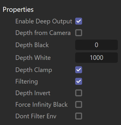

Properties
Enable Deep OutputSpecifies whether to include this render element in deep images.
Depth from CameraSpecifies whether to use camera clip boundaries as the minimum and maximum Z-Depth distance, even if camera clipping is disabled. The camera clipping boundaries can be found in the Details tab of each camera object. Enabling this option disables the Depth Black and Depth White parameters.
Depth Black –  Objects up to this distance from the camera render black.
Depth WhiteObjects further than this distance from the camera render white.
Depth ClampClamps the Z-Depth colors to a linear 0-1 range.
Filtering – Applies an image filter to this channel.
Depth InvertInverts the colors of the Z-Depth render element. Objects closest to the camera render white, while those furthest away are black.
Force Infinity Black – When enabled, overrides the infinity color, turning it black. Everything beyond the Depth White amount (if not using Depth from Camera) is the infinity color.
Dont Filter Env – When enabled, only outlines of overlaying objects are filtered. When Filtering is enabled, and Dont Filter Env is enabled, pixels bordering scene objects and the environment remain unfiltered, while pixels bordering different objects are still filtered.
