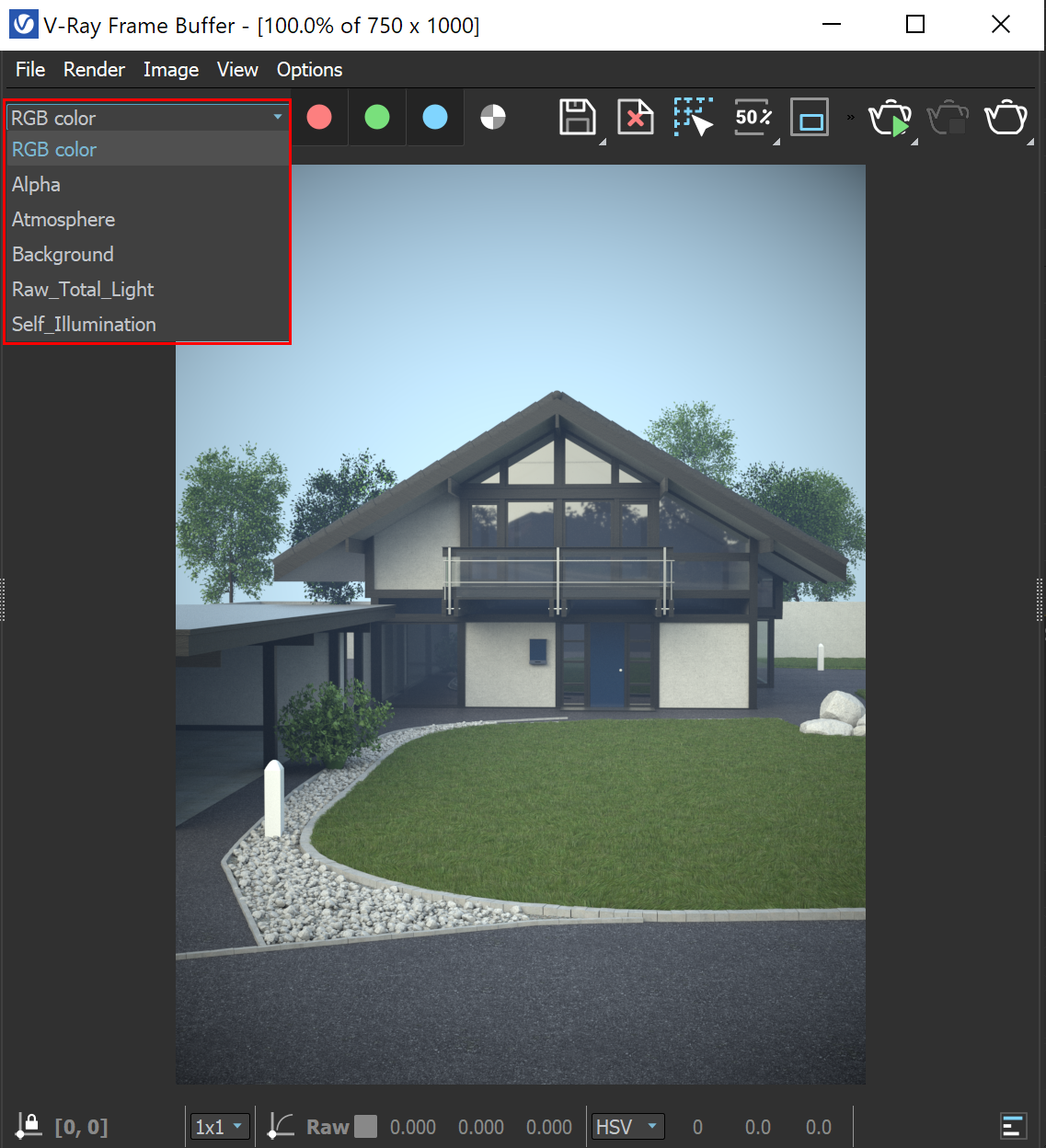

To access the render elements used in a .vrimg or .exr image rendered on Chaos Cloud, you need to open the VFB and load the image you downloaded from Chaos Cloud rendering using the Load image () option from the File menu. Once the image has loaded, you can use the drop-down menu on the uppermost left-hand side to scroll through all available render elements in your scene.
