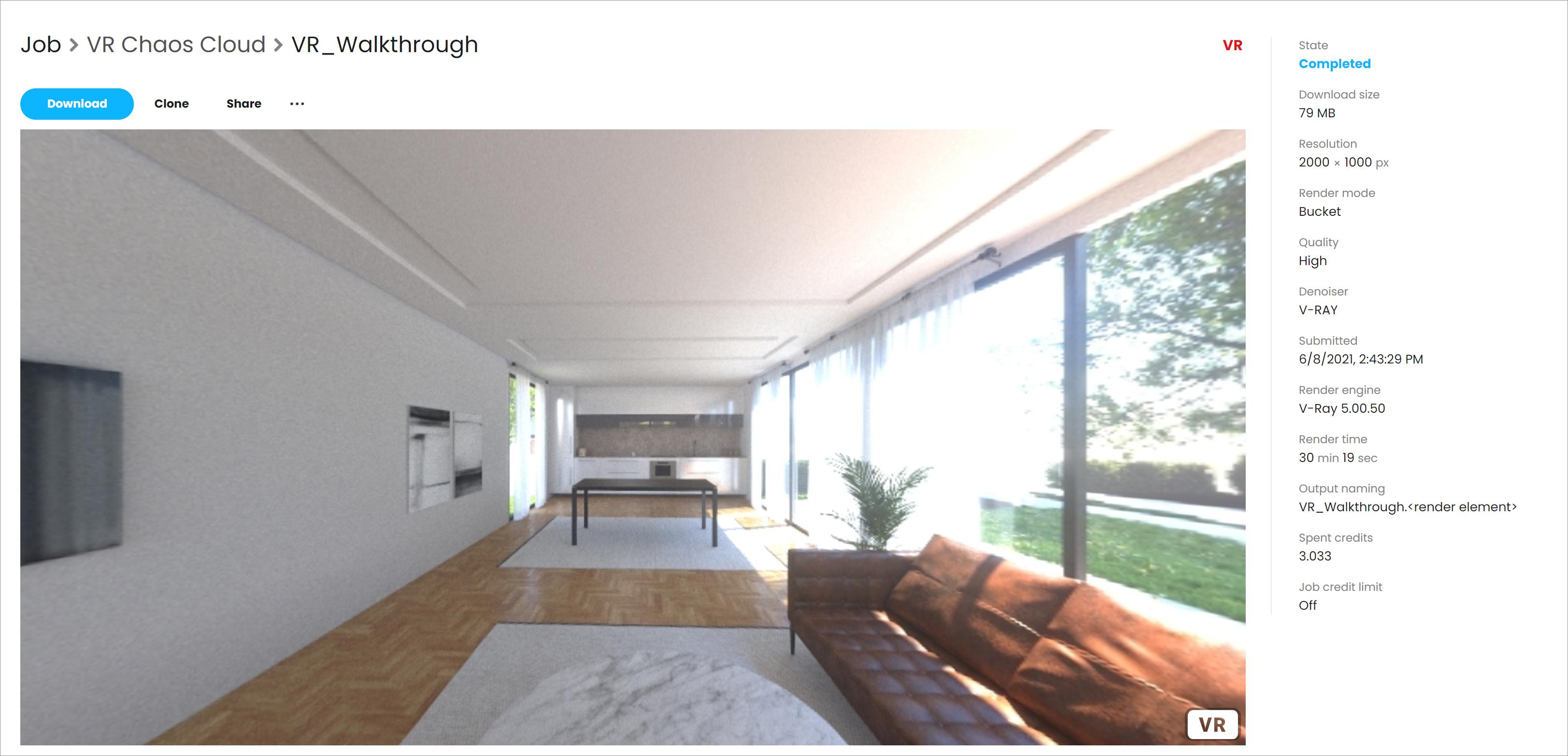

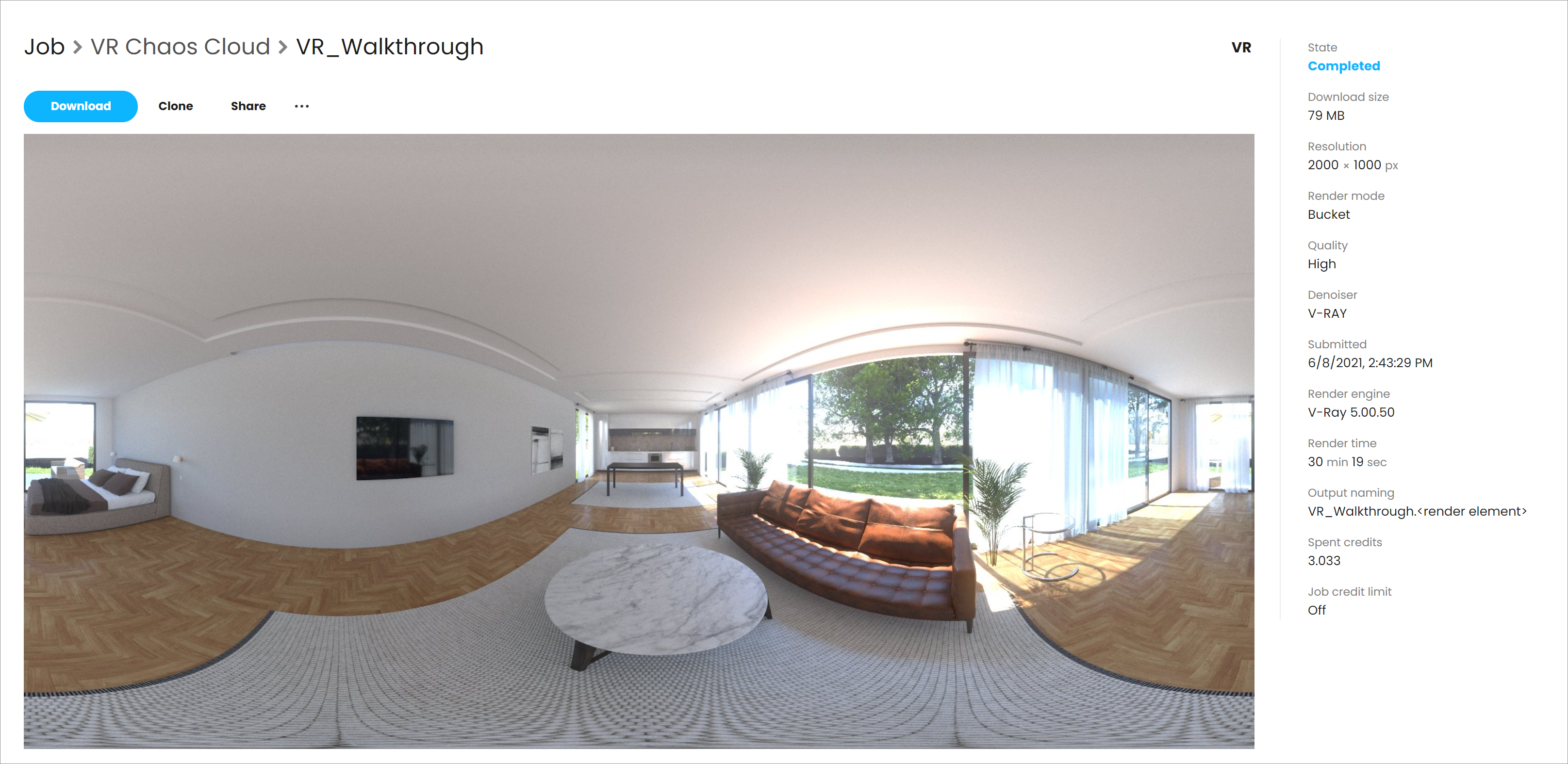

The default view of the Job on the Job Details page is a plain image.
The  toggle button displays VR preview of the job. When in VR preview mode, the Enter VR mode button is available in the preview.
The button enters full-screen mode. In full-screen you can hold the left mouse button and move around to fully preview the VR image.
The Share button generates a QR code and a shareable download link, both of which grant anonymous access to the VR image, accessible from any device.
You can copy the link using the Copy button, or scan the QR code with any compatible mobile application. This will open the responsive web page where the completed VR image can be previewed on all viable Virtual Reality headsets.
