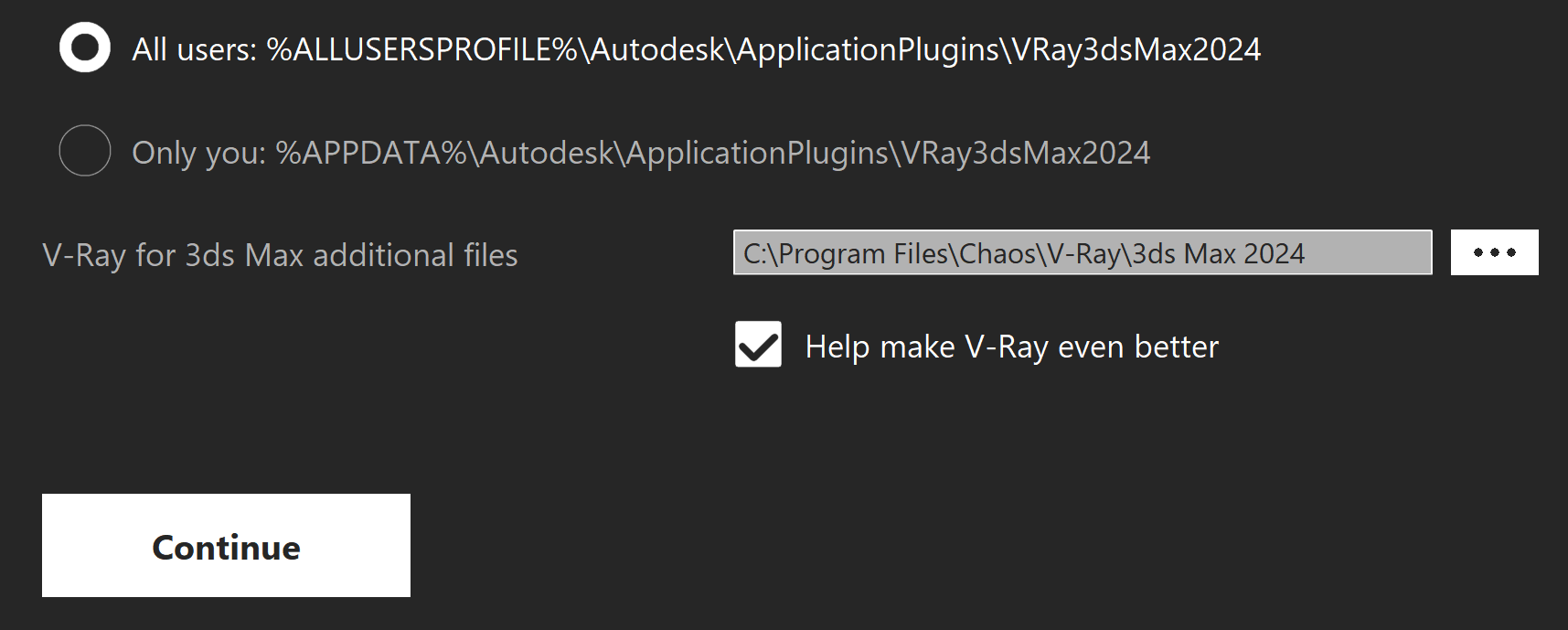

There are two possible locations for installing an Autodesk application package as follows:
%ALLUSERSPROFILE%\Autodesk\ApplicationPlugins\[plugin_name]
Example:
C:\ProgramData\Autodesk\ApplicationPlugins\VRay3dsMax2022
This is the preferred install location when a plug-in is installed by the Autodesk store installer. Plug-ins installed to this location are available to all users on the machine.
%APPDATA%\Autodesk\ApplicationPlugins\[plugin_name]
Example:
C:\Users\<username>\AppData\Roaming\Autodesk\ApplicationPlugins\MyPlugin
The V-Ray SDK, example projects documentation installer and its logs as files not essential to rendering are still in their former place (by default at C:\Program Files\ChaosGroup\V-Ray\3ds Max <3ds Max version>) further known as INSTALLROOT.
