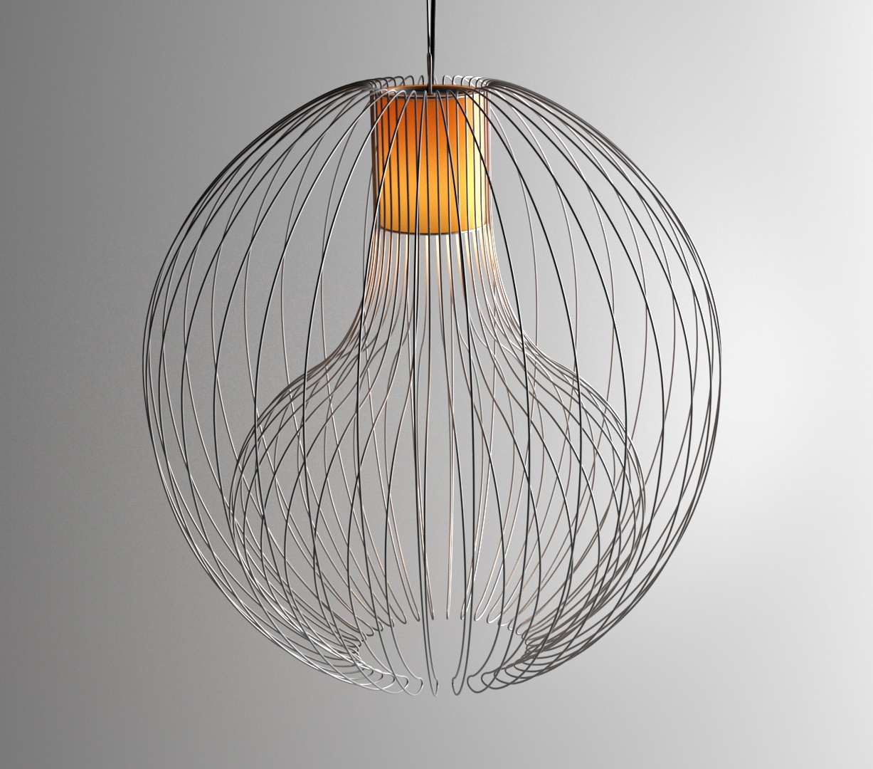

In this example, the lampshade uses a 2Sided material with only a Front material connected (VRayMtl). A V-Ray sphere light is used to illuminate the inside. Translucency is shown here with grayscale values (RGB).
Translucency (0, 0, 0)
Translucency (64, 64, 64)
Translucency (128, 128, 128)
Translucency (192, 192, 192)

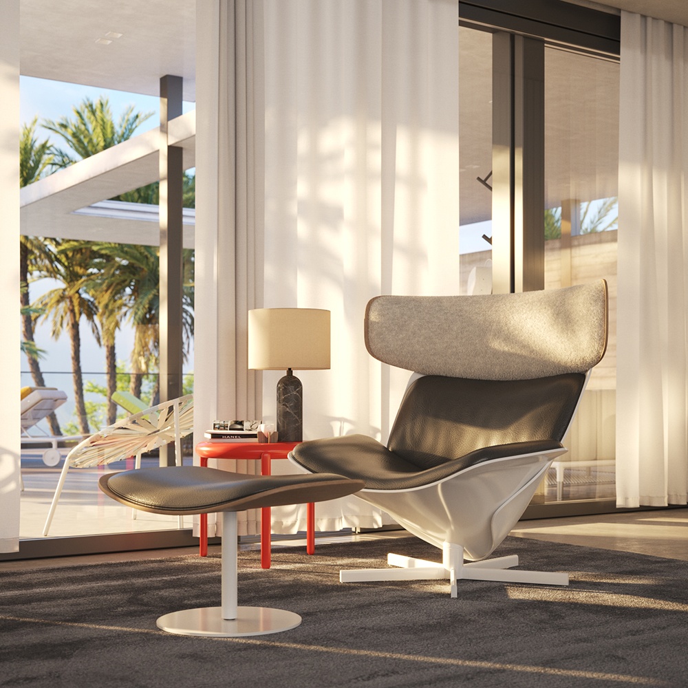

2Sided material is commonly used for leaves. Notice how the light illuminates the shrub from behind.
The curtain uses 2Sided material to allow some outdoor light on the inside of this interior.
