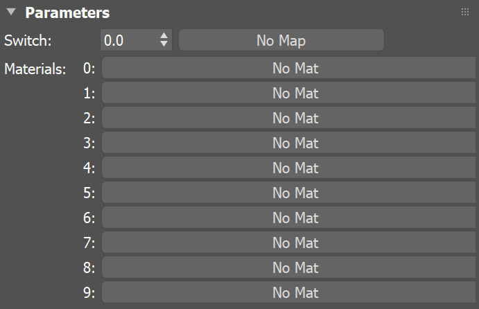

Switch – The texture which is sampled to switch between the assigned materials.
No Map – Assigns a texture map to the Switch material.
Material 1 - Material 10 – Materials to be used based on the value of the the switch texture.
Material 0 is assigned for values 0 - 0.499
Material 1 is assigned for values 0.5 - 1.499
Material 2 is assigned for values 1.5 - 2.499
Material 3 is assigned for values 2.5 - 3.499
Material 4 is assigned for values 3.5 - 4.499
Material 5 is assigned for values 4.5 - 5.499
Material 6 is assigned for values 5.5 - 6.499
Material 7 is assigned for values 6.5 - 7.499
Material 8 is assigned for values 7.5 - 8.499
Material 9 is assigned for values 8.5 and larger.
Values are defined by the assigned Switch map, or the Switch field when no map is specified. When no material is linked to the current value, the geometry doesn't have a valid shading so it won't be visible in the render.
The VRaySwitchMtl doesn't have a default material. If the switch value points to an empty (undefined) material slot the result shading will use the first valid material (the one with the lowest switch value) specified in the VRaySwitchMtl.

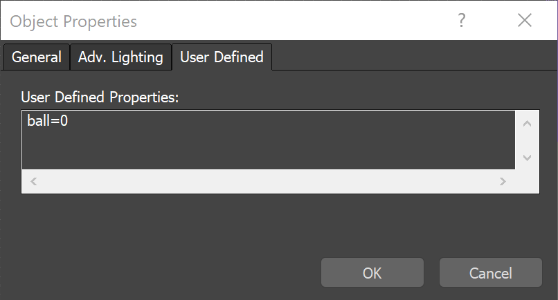

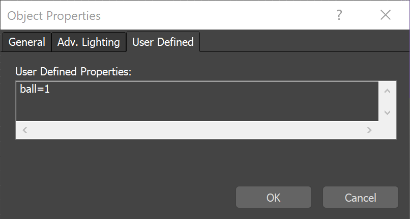

Two different VRayFastSSS2 materials are linked as Material 1 and Material 2 in a VRaySwtichMtl material. A VRayUserScalar is used as the SwitchMtl's Switch map and a user attribute named ball drives the material distribution.
The same VRaySwitchMtl is assigned to two spheres and the VRayUserScalar texture determines how Material 1 and 2 are distributed between the spheres.
User attribute for the first object
User attribute for the second object
The left sphere receives Material 1 and the right sphere receives Material 2
