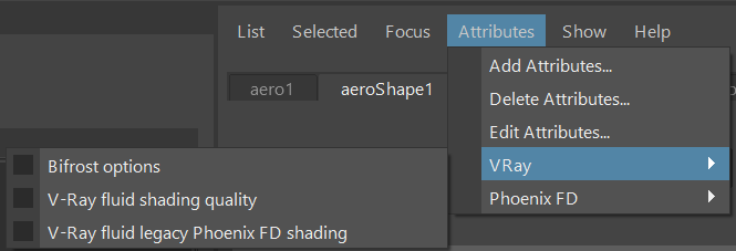

V-Ray Additional Attributes can be added to any Bifrost simulation from the Attributes > VRay menu in the Attribute Editor. These additional attributes assist in exporting.
With V-Ray 5.0 the Maya Bifrost renders physically correct, i.e. it appears darker. The original look from previous V-Ray versions can be replicated by adding the V-Ray fluid legacy Phoenix FD shading attribute and then turning on the Legacy Phoenix FD Shading option. See the Rendering with Older Assets page.
UI Path: ||Select Bifrost system|| > Attribute EditorAttributes menu > VRay > (select attribute set)

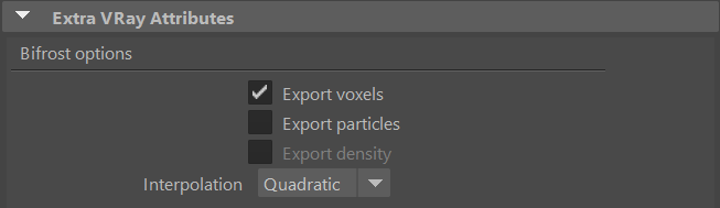

Bifrost Options
Export voxels – Turns on/off the voxel export from this bifrost shape. Turn on this option when rendering a standard iso-surface or smoke.
Export particles – Turns on/off the particle export from this bifrost shape. Turn on this option when rendering particles or metaballs.
Export density – Turns on/off density export from this bifrost shape.
Interpolation – Choose between Linear or Qudratic interpolation.  Linear is faster to render, but Qudratic produces better quality rendering.
