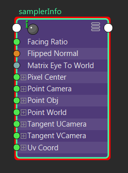

The Sampler Info node is a Maya utility node that provides various scene information that can be used in shading networks at render time. V-Ray Extra Attributes can be applied to the node to increase the node's output options. For more information, see the Additional Outputs section of the Texture Attributes page.

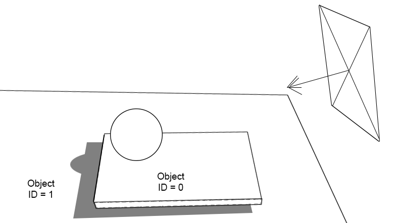

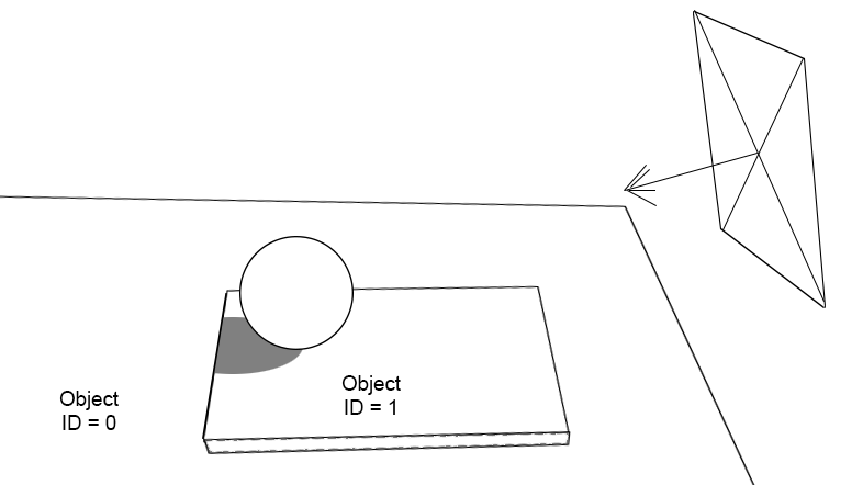

The diagrams below show how Object IDs relate to the shadows being received. Note that only the Object IDs of objects receiving shadows matter in this setup. The Object ID of an object casting shadows does not make a difference.
Shadows as they appear normally.
The sphere casts shadows on both the table and floor,
and the table casts a shadow on the floor.
No sphere or table shadow on floor (Object ID = 0).
Sphere shadow appears on table (Object ID = 1).
Sphere and table shadows appear on floor (Object ID = 1).
No sphere shadow on table (Object ID = 0).

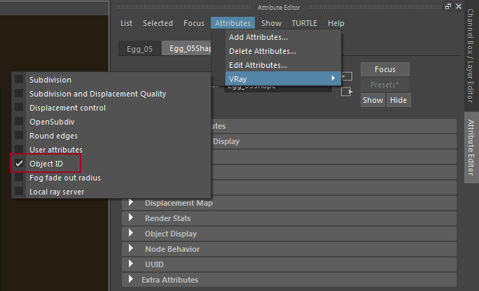

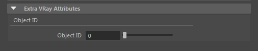

The first step is to set up Object IDs for objects that will receive shadows, which includes the grass and all eggs except the topmost egg. Before you can do this, you must add the V-Ray Object ID attribute to these objects.
1. Select the objects that our main object will cast shadows upon, under normal circumstances where no special parameters are set. Whether the shadows are cast upon objects depends on the current lighting setup. Select these shadow-receiving objects one at a time, and add a V-Ray Object ID attribute to each (Attributes > VRay > Object ID).
2.  For any object that is to receive shadows from the main shadow-casting object, set the Object ID to 1.
3.  For any that you don't want to receive shadows from the main shadow-casting object, set the Object ID to 0.
For objects that could potentially receive shadows from the shadow-casting object in the scene, assign an Object ID of 1 to geometry objects that you want to receive shadows, and an Object ID of 0 to geometry objects that you do not want to receive shadows. No special material is required for these objects. If you don't change the Object ID for an object, it will behave normally, receiving shadows if shadows are cast upon it.

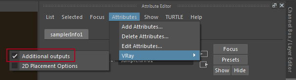

1. Open Hypershade and create a samplerInfo node.
2. With the SamplerInfo node selected, add VRay Attributes in the attribute editor: Attributes > VRay > Additional outputs.

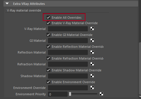

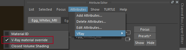

3. The shadow-casting object must have its own shader which is not be shared with other objects in the scene. Create a new VRayMtl material for the main shadow-casting object, and with this material selected choose Attributes > VRay > V-Ray material override.
4. Since we will be using the Shadow Material override, make sure that Enable Shadow Material Override is enabled.

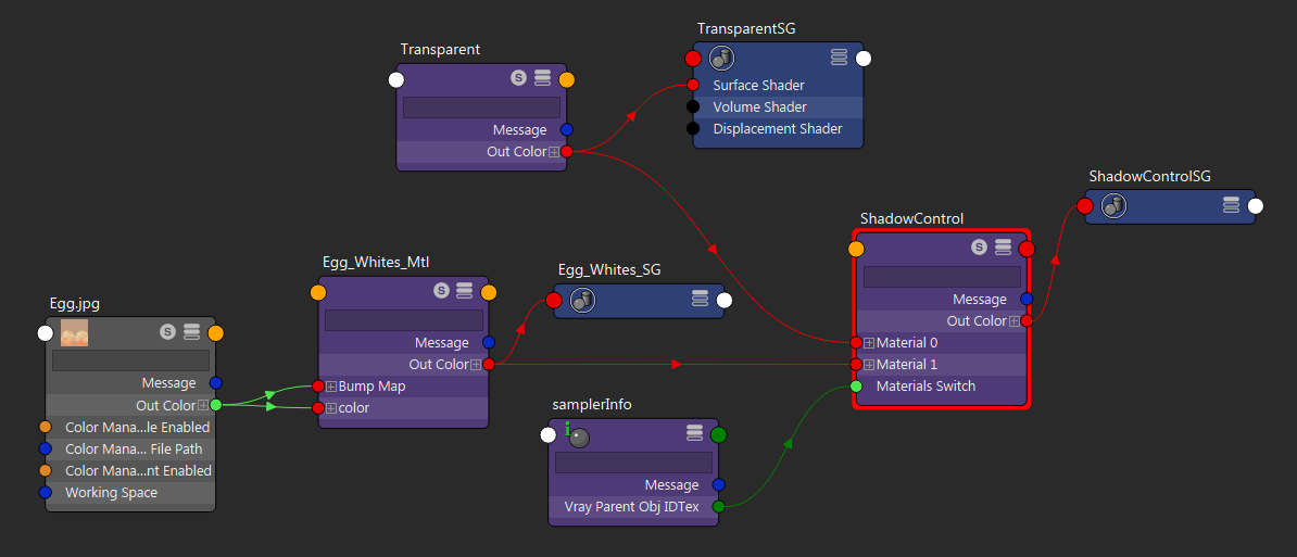

Set up VRaySwitchMtl

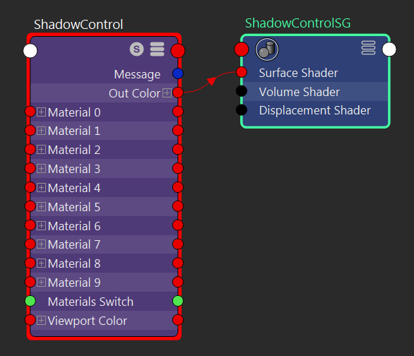

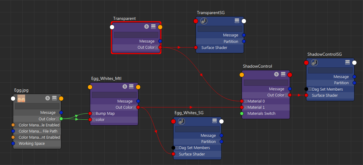

1. In the Hypershade create a VRaySwitchMtl material and name it ShadowControl.

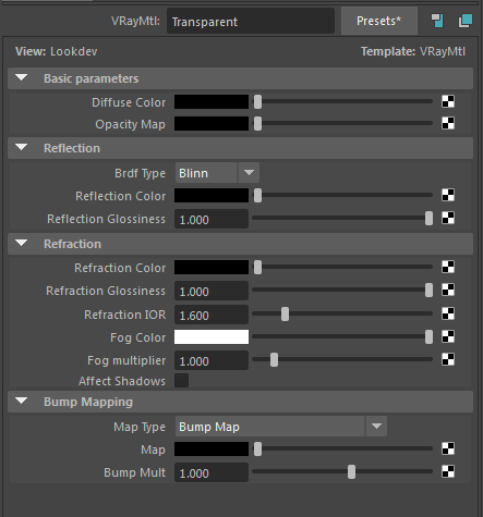

2. In the material 0 slot, add a VRayMtl material named Transparent and make both the Diffuse Color and Opacity Map slots are black in color.

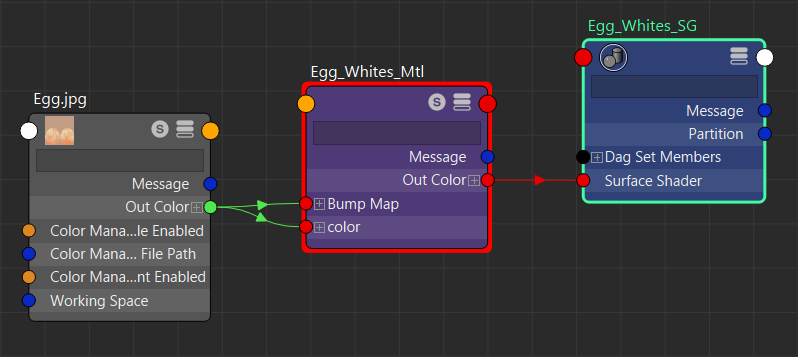

3. Duplicate the Egg_Whites_Mtl material and then connect the output of the Egg_Whites_Mtl to the Material 1 slot. This will provide the shadowed textures. Note Opacity must be set to a white color in order for this to work properly.
4.  In the Hypershade, navigate to the Utilities tab and drag the SamplerInfo node we created earlier into your graph area. We will use this along with Object IDs to drive the VRaySwitchMtl.
5. Connect the V-Ray Parent Object ID Tex output of the SamplerInfo node to the Materials Switch input of the Switch Material. This can be done by left-clicking on the white circle on the right-hand side of the SamplerInfo node, selecting VRay Parent Obj IDTex, and connecting the wire to the Materials Switch channel. You can also select the vrayParentObjIDTex output and the materialsSwitch input in the Connection Editor window.
The V-Ray Switch material set up for shadow control is assigned to the topmost egg

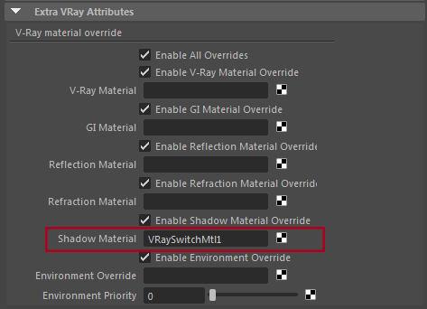

6. Middle-click-drag the VRaySwitchMtl material into the Shadow Material slot for the VRayMtl of the main shadow casting object.
