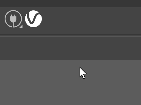

|| V-Ray Shelf || > Create V-Ray PluginNode
||Create menu|| > V-Ray > Create V-Ray PluginNode
||V-Ray menu|| > Tools > Create V-Ray PluginNode

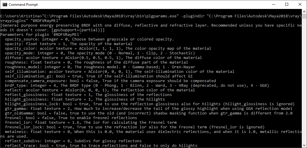

plgparams
It is located in the bin folder of your V-Ray installation, under the vray folder (C:\Program Files\Chaos\V-Ray\Maya 20xx for x64\maya_vray\bin).
With the command prompt, navigate to the bin folder and run plgparams without arguments to see a list of available switches. In general, you will need to run a series of commands to point plgparams to the plugin folder, locate the V-Ray name of the node (which might differ from its display name in the V-Ray UI), and list the parameters for the plugin.
To point plgparams to the folder where your plugins reside, use this command:
plgparams -plugindir <plugin folder>
This command tells plgparams where to find your plugins. In most installations, this will be in the vrayplugins folder under the vray folder. If running plgparams from the bin folder, the command to set the plugin folder would look similar to the following:
plgparams -plugindir "../vrayplugins"
To see the list of plugin names in this folder, use the following command:
plgparams -plugindir "../vrayplugins" -list
Note that the plugin folder must be specified with the -plugindir switch each time you run the command.
To see help on the parameters for a specific plugin, name the plugin in quotes after the -plugindir switch and folder. For example, to see help on the BRDFVRayMtl plugin, use the command:
plgparams -plugindir "../vrayplugins" "BRDFVRayMtl"
This will list all the parameters for the plugin, and definitions for each.
