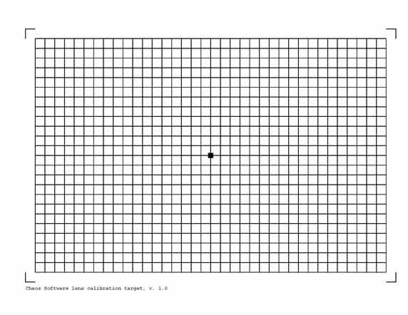

  1. The utility creates a calibration chart file by selecting AnalysisPrint Test Chart...The utility outputs a PostScript (PS) formatted file. PS is a standard printer format, which can be easily converted to PDF via the ps2pdf utility (where applicable) or through an online service, http://www.ps2pdf.com/
  2. The calibration chart is printed on a sheet of paper, which is later photographed with the camera to be analyzed;

Printing a Calibration Chart
From AnalysisPrint Test Chart..., you should choose the aspect ratio of the camera (the image sensor or that of the film gate). Using the correct ratio is beneficial for the accuracy of the method. Pressing the View... button opens the generated PS file in your default PostScript viewer (under Windows, you may need to install one – for example, the freeware GSview). You may also choose Save and convert the resulting PostScript file to PDF via the online service  http://www.ps2pdf.com/.  Both ways work. The chart then needs to be printed on a sheet of clean white paper (size is not important; A4/Letter is OK). The grid lines need to be straight and free from defects (e.g., gaps, scratches, and other irregularities). The illustration below shows an example calibration chart.
