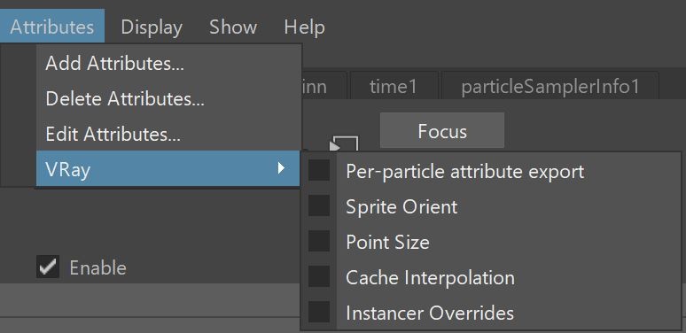

UI Path: ||Select particles|| > Attribute Editor Attributes menu > VRay > (select attribute set)

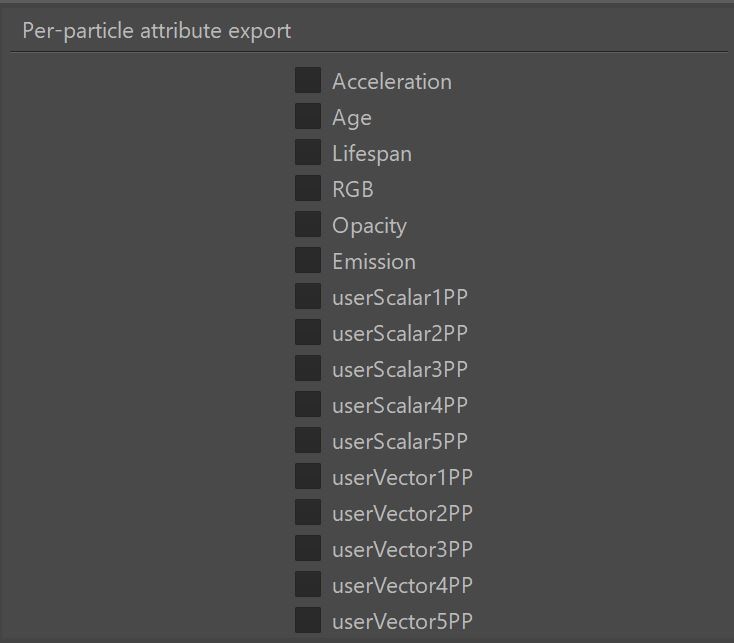

Per-Particle Attribute Export
This group allows to specify which per-particle attributes you want to be translated by V-Ray. These attributes are then available for use by the particleSampler node.
Add to node:
vray addAttributesFromGroup "nParticleShape1" "vray_particle_export_attributes" 1;
Attributes:
vrayPPExportAcceleration
vrayPPExportAge
vrayPPExportLifespan
vrayPPExportRGB
vrayPPExportOpacity
vrayPPExportEmission
vrayPPExportScalar1
vrayPPExportScalar2
vrayPPExportScalar3
vrayPPExportScalar4
vrayPPExportScalar5
vrayPPExportVector1
vrayPPExportVector2
vrayPPExportVector3
vrayPPExportVector4
vrayPPExportVector5

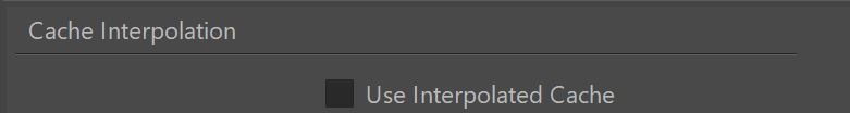

Cache Interpolation
Use interpolated cache – This attribute is available only with nParticle and is intended as a workaround when using nCache. In this case, Maya does not interpolate the particle positions between cache frames. The recommended workflow is to always have cache for frame times that V-Ray renders. If this is not executed properly, V-Ray tries to find information about the cache and uses the velocity to estimate the next particle position. If this option is on, V-Ray samples the cache where it's available and interpolates the data. This way the end position of one frame better matches the start position of the next frame. This process can be much slower, and requires all dynamics on the scene to be cached!
 Add to node:
vray addAttributesFromGroup "nParticleShape1" "vray_particle_cache" 1;
Attributes:
vrayInterpolatedCache

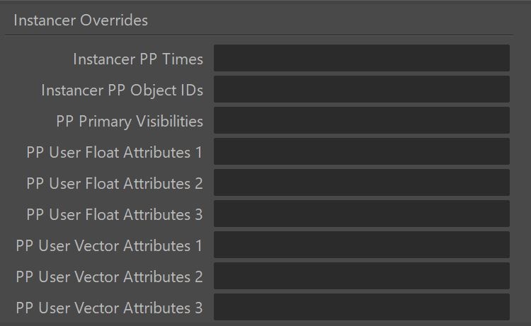

Instancer Overrides
This group is used with Instancer nodes, in order to pass per particle attributes that can override attributes of the instanced geometry.
Instancer PP Times – The name of a PP attribute of type double, that overrides the frame times of the instanced object. This can be used for example to change frame time with V-Ray proxy nodes.
Instancer PP Object IDs – The name of a PP attribute of type double, that overrides the Object ID of the instanced geometry object.
PP Primary Visibilities – The name of a PP attribute of type double, that sets the "Primary Visibility" flag of the instanced geometry object.
PP User Float Attribute 1/2/3 – The name of a PP attribute of type double, that is added to the user scalar attributes of the instanced geometry object. The user attribute name is the same as the PP attribute name.
PP User Vector Attribute 1/2/3 – The name of a PP attribute of type vector, that is added to the user color attributes of the instanced geometry object. The user attribute name is the same as the PP attribute name.
