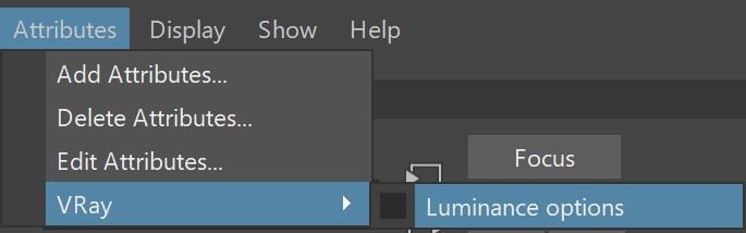

UI Path: ||Select Surface Luminance node|| > Attribute Editor > Attributes menu > VRay > Luminance options

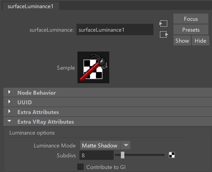

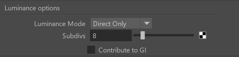

Luminance Mode – Controls how luminance is calculated.
Disabled – No luminance is calculated.
Direct Only – Calculates luminance from direct lighting. It creates a grayscale mask over the points of objects lit by direct lighting.
Diffuse Only – Calculates luminance from indirect lighting (GI). It creates a grayscale mask over the points of objects lit by indirect lighting.
Direct+Diffuse – Calculates luminance from direct and indirect lighting. This creates a grayscale mask over the points of objects by direct and indirect lighting.
Matte Shadow – Creates a grayscale mask over all shadowed points of objects. Unlike the standard Matte Shadow render element, this mode creates a two-sided mask covering both the lit and unlit points of the objects.
Subdivs – Controls the subdivisions for the diffuse lighting, when the Luminance Mode is set to Diffuse only or Direct+Diffuse.
Contribute to GI – When enabled, the direct light contributes to the GI calculations. The effect is visible only when the texture is used for diffuse calculation with either the Diffuse Only or the Direct+Diffuse mode.

  2. With the node selected, from the Attribute Editor, add Attributes > VRay > Luminance Options.

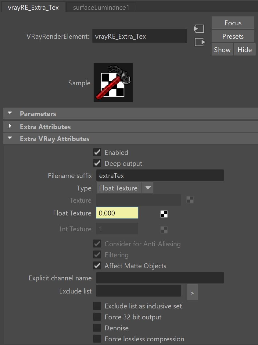

  4. Create an ExtraTex render element.
  5. Set the Type to Float Texture.

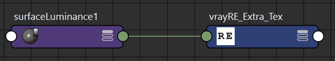

  6. Connect the surfaceLuminance node to the Float Texture input plug of the ExtraTex render element.
Scripting Example (MEL)
// The connection is made from the outValue output of the surfaceLuminance node to the vray_float_texture_extratex input of the ExtraTex render element.
connectAttr -f surfaceLuminance1.outValue vrayRE_Extra_Tex.vray_float_texture_extratex;
