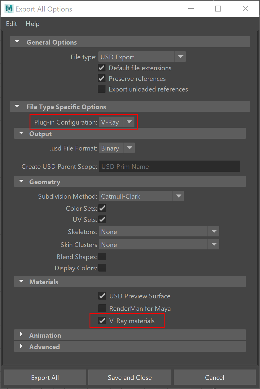

  • In the File > Export All Options window, set the File Type to USD Export and choose whether the materials are exported as USD Preview Surface or as V-Ray materials. You can export all materials in the scene as one or multiple types of networks.

Disable the Merge Transform and Shape Nodes option from the Advanced rollout for a cleaner hierarchy and export. If you are using a version of V-Ray for Maya prior to 6.20.01, the Merge Transform and Shape Nodes option needs to be disabled to correctly export VRaySubdivisions.
When exporting objects with applied V-Ray Displacement, the displacement is exported along with the shaders. In this case, make sure the V-Ray materials option is enabled.
When exporting objects with an applied Subdivision attribute, the subdivision is exported separately from the shaders. In this case, enabling the V-Ray materials option is not mandatory, as it will not affect the export of the subdivision surface.
When exporting objects with applied Subdivision attribute and V-Ray Displacement, the subdivision and displacement are exported along with the shaders. In this case, make sure the V-Ray materials option is enabled.

Export and import of multiple UVs is supported under the following condition: digits are forbidden as first characters in the name of the UVset.
To ensure proper workflow with UV sets the export Plug-in configuration should be set to V-Ray. Otherwise, they are exported with Maya's convention.
