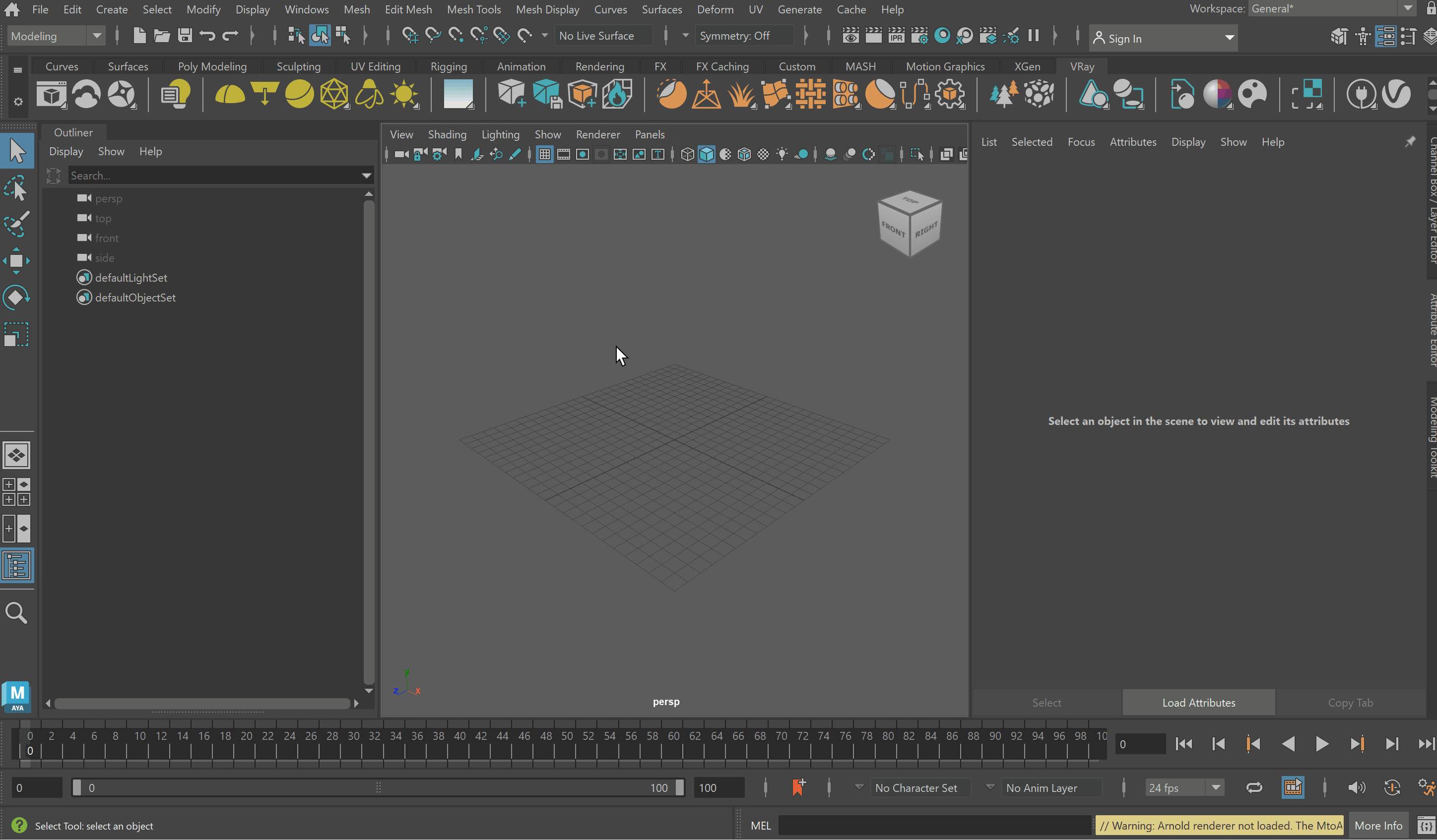

Once you have installed V-Ray for Maya, you can load the plugin from the Maya plugin Manager:
  1. Start Maya.
  2. Open the Plugin Manager from the Windows > Settings/Preferences > Plug-in Manager menu.
  3. Load the vrayformaya.mll plugin and close.
