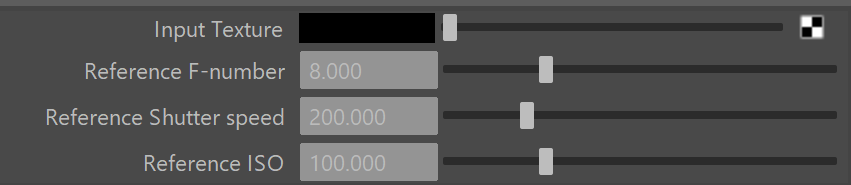

The difference between the exposure generated by these three parameters and the corresponding parameters in the physical camera is compensated by this texture. Thus, the exposure in the render is as if the camera has these three parameters set.
Input Texture – Input texture slot. For example, you can connect an HDRI map to this slot. You can also leave this slot empty.
Reference F-number – Reference F-number setting corresponding to the physical camera f-number.
Reference Shutter speed – Reference shutter speed setting corresponding to the physical camera shutter speed.
Reference ISO – Reference ISO setting corresponding to the physical camera sensitivity (ISO).
