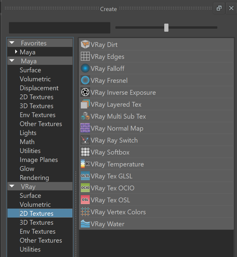

VRayTexOCIO is a texture that allows the user to apply OpenColorIO (OCIO) color transformations to other textures in Maya.

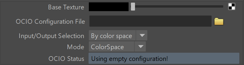

OpenColorIO Parameters
Base Texture – Specifies the base texture that will be corrected using OCIO.
OCIO Configuration File – Allows the user to manually pick an OCIO configuration. If not specified, the OCIO environment variable is used.
Input/Output Selection – Determines how the input and output color spaces are specified.
By color space – The user specifies the input and output color spaces directly.
By role – The user specifies the input and output color space depending on the task that they want to perform as defined in the OCIO configuration.
Mode – Specifies which color transformations the texture will perform.
ColorSpace – The texture performs color space conversions.
CDLTransform – The texture performs a CDL transformation.
FileTransform – The texture performs a color transformation based on another file (i.e. .3dl.lut, .cube, etc).
LogConvert – The texture performs log2lin or lin2log conversion.
Display – The texture performs color space conversion for display.
Look – The texture performs a look transform. The OCIO config must define looks for this mode to work.
OCIO Status – A read-only attribute that provides feedback from the OCIO library.
