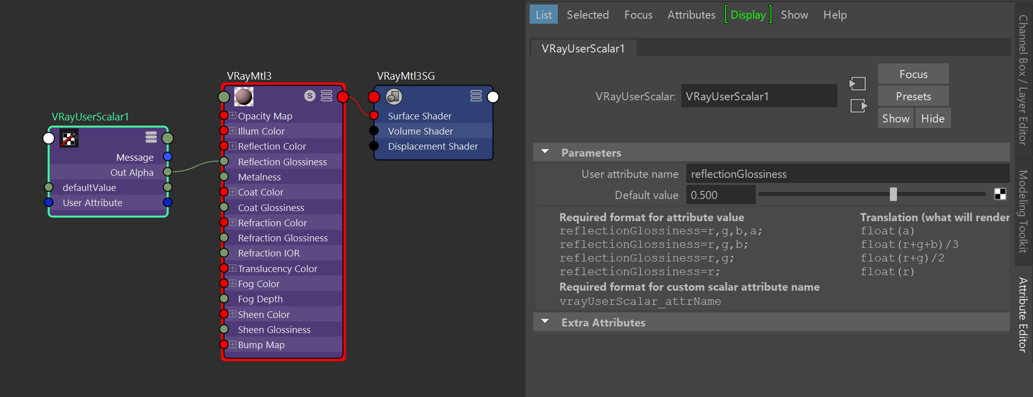

The VRayUserScalar texture allows the user to read and return a single number value from the User-Defined properties of the currently shaded object as a result. This can be useful if the same material or texture is applied to several objects in the scene, but we want to control some of its aspects (i.e. material glossiness, or a blend between two other textures inside a Mix texture etc) with User-Defined properties.
The Example on the right uses a VRayUserScaler node to control the reflection glossiness value on a single V-Ray Material. The four different pieces of the shader ball have a VRayUserAttribute that dictates different values that drive the reflection glossiness.

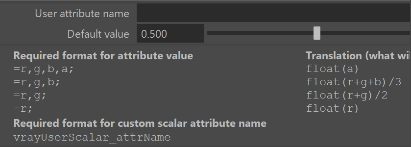

User attribute name – Specifies the name of the user attribute that is looked up and returned from this shading node.
Default value – Specifies the value to return if the user attribute is not found on the shaded object.
Required format for attribute name – Displays possible formats for the attribute in the V-Ray User Attributes string assigned to the object, and what is rendered as a result.

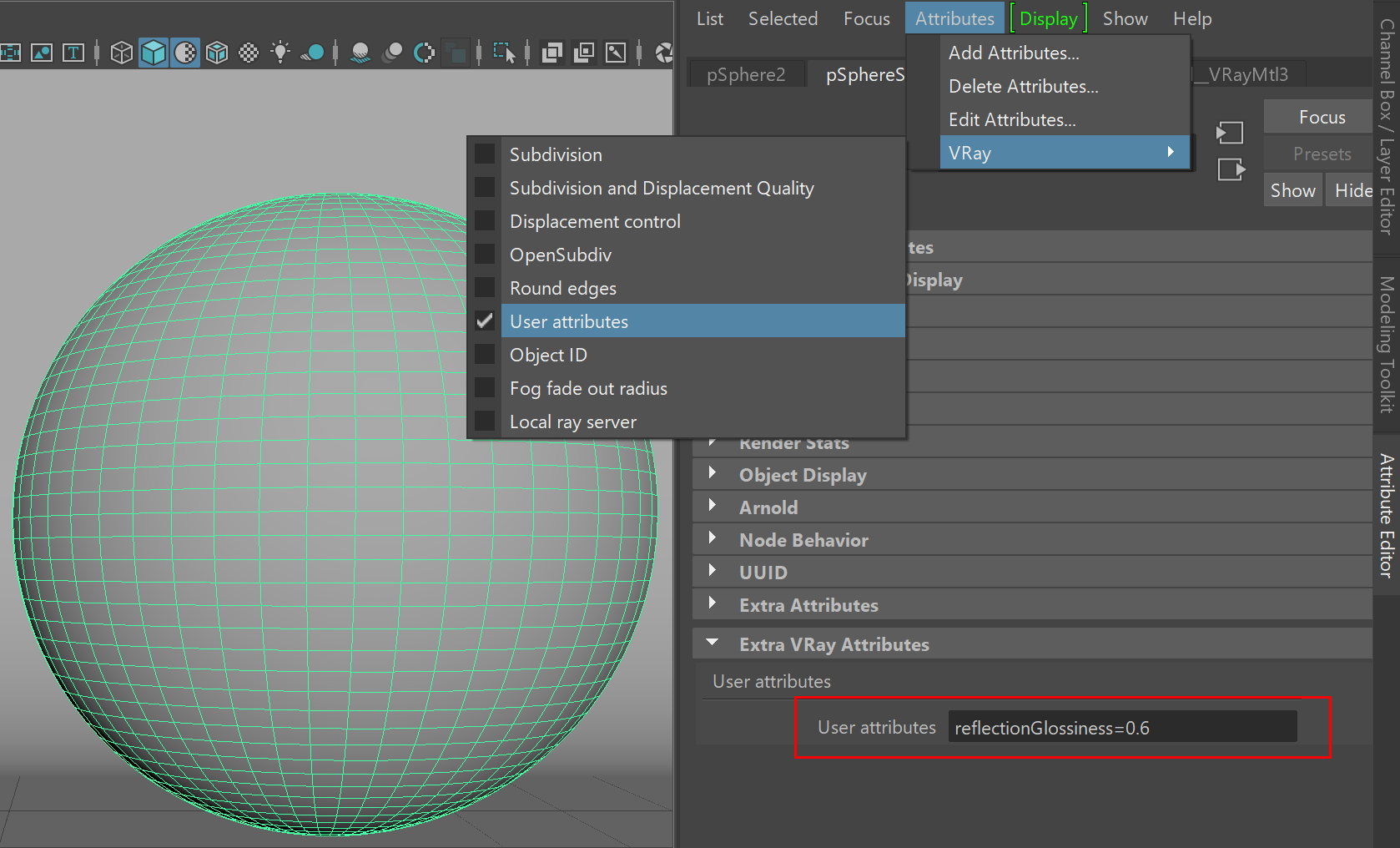

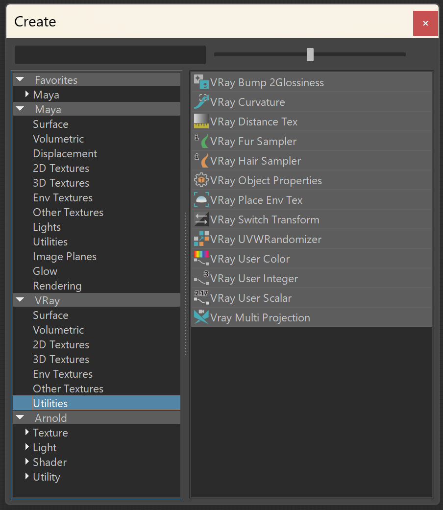

User attributes can be added though the Attributes > VRay > User attributes menu.
Example: User Properties

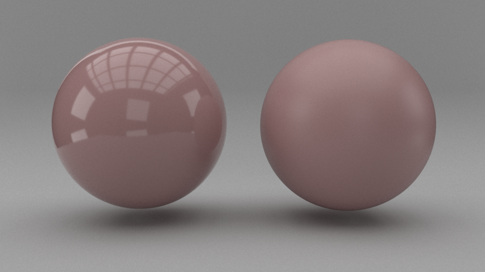

This example shows the format for the value of the user attribute and how it is interpreted. The VRayUserScalar texture controls the VRayMtl Reflection Glossiness parameter. A user attributed named reflectionGlossiness is used to specify different reflection glossiness values on two objects.
The same material is applied to both objects. A VRayUserScalar texture passes the values to the shader.
User attribute for the first object
User attribute for the second object
Although the two objects have the same material, the glossiness is determined by the user property.

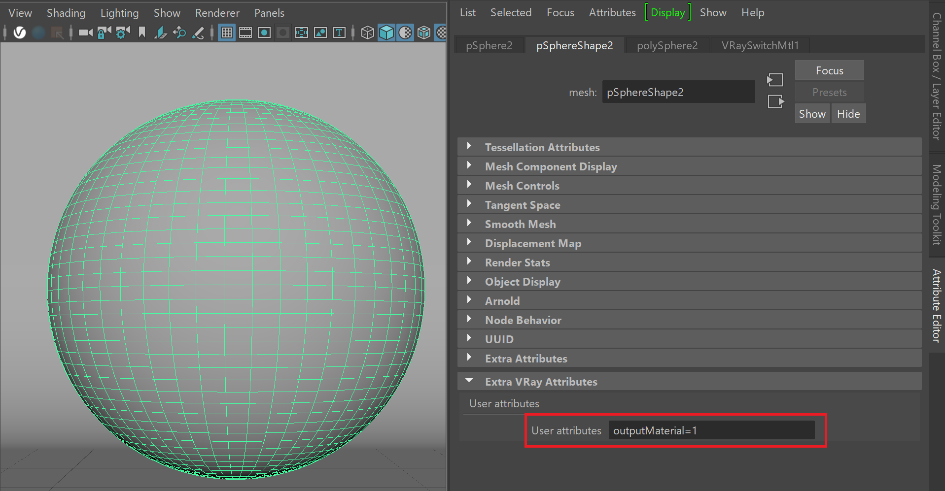

Example: VRayUserScalar with VRaySwitchMtl

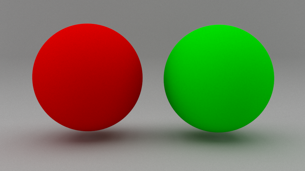

This example uses VRayUserScalar to control how materials from a VRaySwtichMtl are distributed to different objects.
Two different VRayMtls are linked as Material 0 and Material 1 in a VRaySwtichMaterial. A VrayUserScalar is used as the SwitchMtl's Material Switch and a user attribute named outputMaterial drives the material distribution.
The same VRaySwitchMtl is assigned to two spheres and the VRayUserScalar texture determines how Material 0 and 1 are distributed between the spheres.

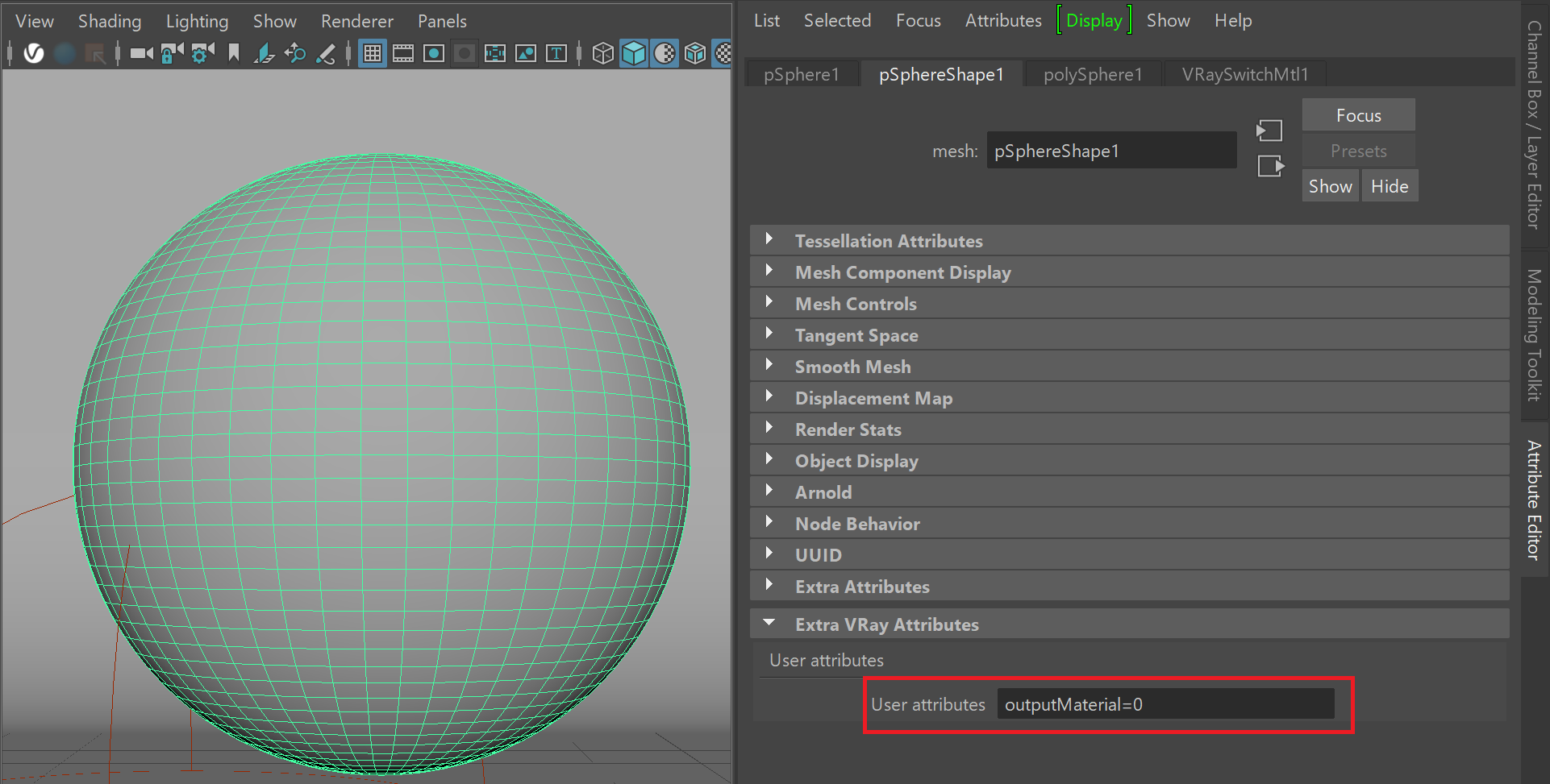

The left sphere receives Material 0 and the right sphere receives Material 1
