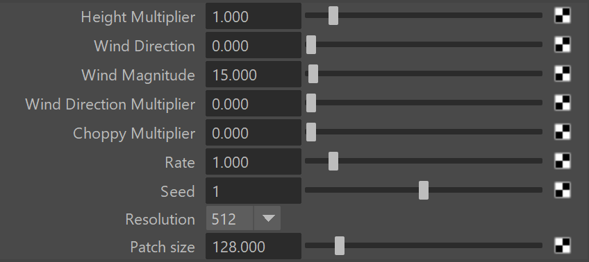

  • Adjust the parameters of the VRayWater texture.
Height Multiplier – Specifies a scale multiplier for the whole texture. See the Height Multiplier example below.
Wind Direction – Specifies the wind direction and thus the direction of the waves. See the Wind example below.
Wind Magnitude – Specifies the strength of the wind creating the waves. Higher values produce larger waves. See the Wind example below.
Wind Direction Multiplier – Specifies a multiplier for the importance of the wind direction. Smaller values produce more variation in the direction of the waves.
Choppy Multiplier – Specifies a multiplier for the choppiness of the waves. Higher values produce sharper looking waves.
Rate – Speeds up or slows down the movement of the waves. This value has effect only in an animation.
Seed – Specifies an integer used to set the starting point for the random generator. Different values produce different waves randomly. See the Seed example below.
Resolution – Specifies the amount of detail in the generated map.
Patch size – Specifies the real world size of one patch of the VRayWater texture outside of which the surface is perfectly periodic.

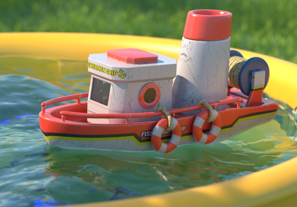

Height multiplier = 1

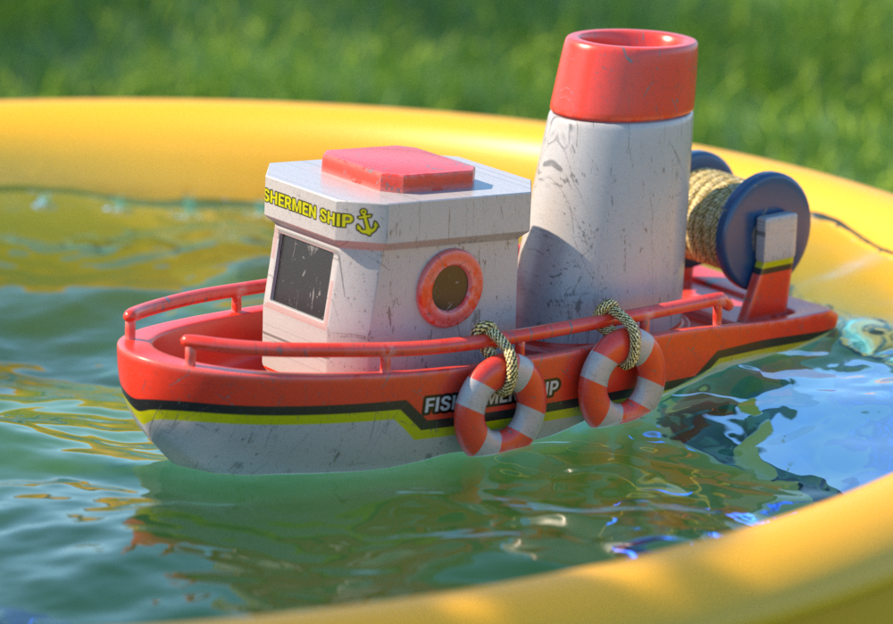

Height multiplier = 2.5

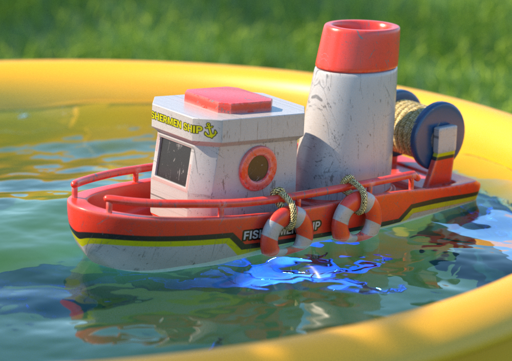

Height multiplier = 5

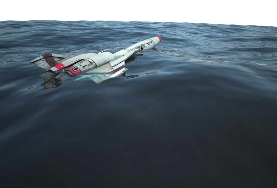

In the following example, we can see how the Wind Direction parameter affects the waves. In our case, the wave angle is set to 21 degrees and in the animation the waves are moving at an angle of 21 degrees in a counterclockwise direction relative to the X axis. None of the texture parameters need to be animated to produce moving waves. Here, the Wind Direction is set to 21. Wind Magnitude is 15, Height Multiplier is set to 5 and Seed is 3.
