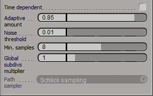

Time dependent - when this option is Off, the sampling pattern will be the same from frame to frame in an animation. Since this may be undesirable in some cases, you can turn this option On to make the sampling pattern change with time. Note that re-rendering the same frame will produce the same result in both cases.
Adaptive Amount - controls the extent to which the number of samples depends on the importance of a blurry value. It also controls the minimum number of samples that will be taken. A value of 1.0 means full adaptation; a value of 0.0 means no adaptation.
Noise Threshold - controls V-Ray's judgement of when a blurry value is "good enough" to be used. This directly translates to noise in the result. Smaller values mean less noise, more samples and higher quality. A value of 0.0 means that no adaptation will be performed.
Min samples - determines the minimum number of samples that must be made before the early termination algorithm is used. Higher values will slow things down but will make the early termination algorithm more reliable.
Global Subdivs Mult - this will multiply all subdivs values everywhere during rendering; you can use this to quickly increase/decrease sampling quality everywhere. This affects everything, except for the lightmap, photon map, caustics and antialiasing subdivisions. Everything else (dof, moblur, irradiance map, brute-force GI, area lights, area shadows, glossy reflections/refractions) is affected by this parameter.

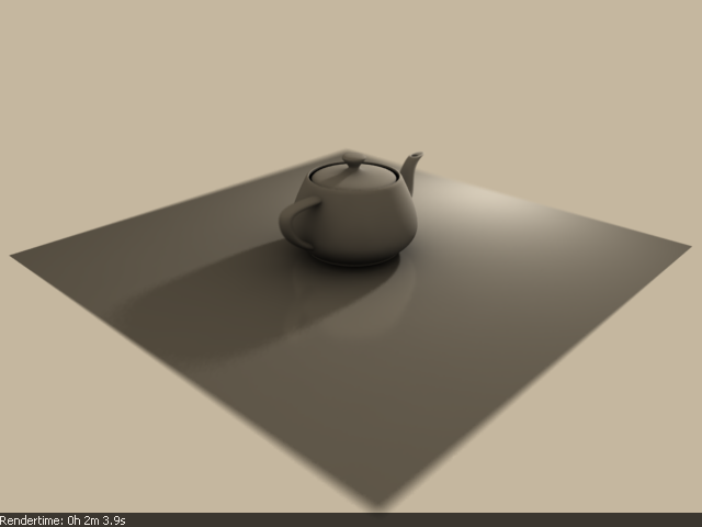

The images below have the same subdivs for DOF (10 subdivs), GI (50 subdivs, Direct method), glossy reflection (50 subdivs, no interpolation), area light (10 subdivs) for all images. Notice how changes in the DMC sampler parameters affect the image quality and render time (click the images to enlarge them):
 Adaptive amountNoise thresholdMin samplesRender time
0.850.005158m 43.7s
0.950.015
4m 34.5s
0.950.0551m 35.8s
0.990.05
5
0m 49.0s
10.150m 28.6s
